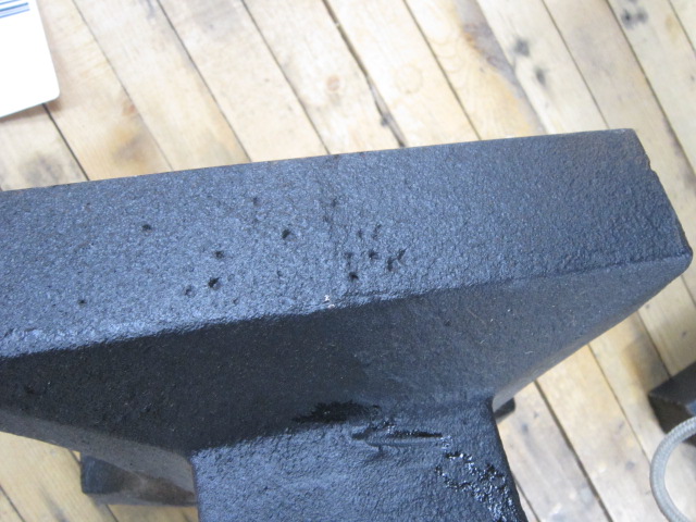

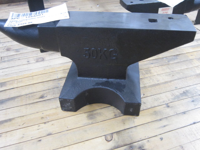

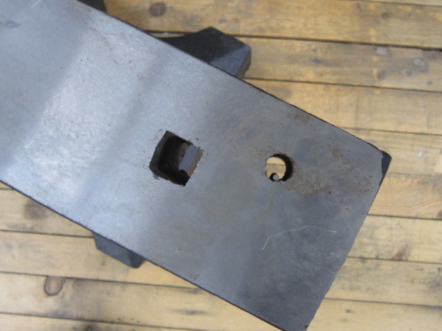

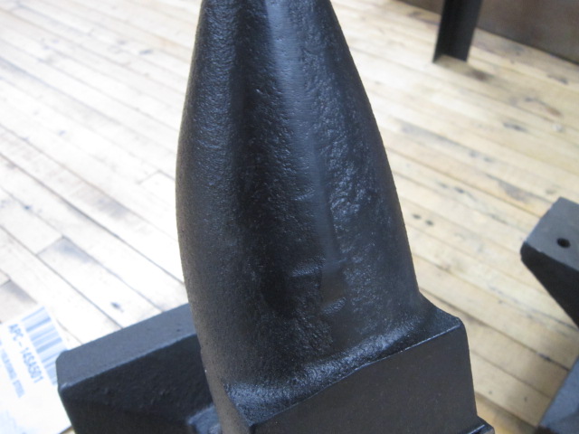

M.J.Lampert Posted June 9, 2021 Author Share Posted June 9, 2021 ok so the report is bad, definitely cast, 30-40% rebound also wondering if it is a cast steel possibly as has a good ring from 1/2" bearing ball and the rebound was like twice my cast aso (15-20ish) still dont think will get on the plus side guy at store gave me the name of another local smith Pioneer blacksmithing he has a web site with that name as well and recently started a local guild so not all bad today M.J.Lampert Quote Link to comment Share on other sites More sharing options...

JHCC Posted June 9, 2021 Share Posted June 9, 2021 7 hours ago, George N. M. said: MJ, I'm glad you didn't pull the trigger. Agreed. The lesser disappointment of not getting the deal you expected far outweighs the greater disappointment you would have experienced trying to use a substandard anvil. That said, the greater ring and rebound might indicate a ductile cast iron anvil, but without clear and accurate info from the manufacturer, I wouldn't trust it. Quote Link to comment Share on other sites More sharing options...
