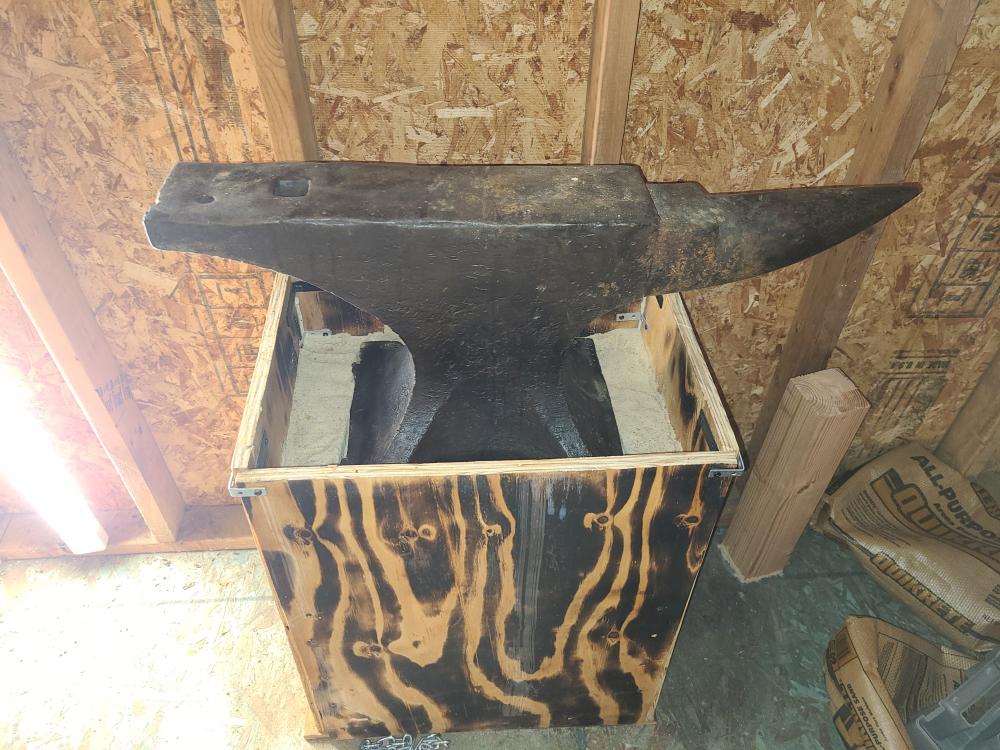

I've pretty much decided to do a sandbox stand for my new 288 lb anvil and I'm trying to think of the easiest way to make the box and it popped into my head that I could use an outdoor trash can, fill it with sand, and be done. I haven't seen this done before which makes me wonder if there's a reason for that since it seems like such a quick and easy solution.
3 minutes ago, ThomasPowers said:
Plastic?   Steel?
I was thinking plastic so I could easily cut it down to the right height, though if I happened to find a steel one that was ~28 inches tall id think that would be a good option too.
If you can find one that fits the base of your anvil, then it might work? But dimensional lumber stood on end would be much better and much safer.  I would be worried about the sides splitting after repeated impacts (that is a lot of weight for your average garbage can), or trouble keeping the anvil level. Wherever you are hitting is likely to displace sand and cause that side to sink lower.
It just doesn't seem to be the most stable stand IMHO which could lead to a dangerous situation should it start to tip or walk around inside your sandbox. Most of the straight sided garbage cans I can think of (you do not want one that is narrower at the base than it is at the top) are round. Which, depending on what the diameter is, might limit the amount of access you have while standing in front of it.
That's a good point, I didn't think about the risk of the can splitting, they definitely aren't designed for that amount of force being applied on them.
Not to mention hot steel and plastic!   Out here plastic has a limited life due to the ferocious UV,  I've had 5 gallon buckets fall apart in shreds after just a couple of years exposure.
After rethinking the trashcan plan I went back to my original plan and build a wood box for the sand. I used 3/4 plywood for the bottom and sides with 4x4s in the corners for strength. Everything screwed and glued together with construction adhesive and steel angle supports. It's strong xx xxxx, ugly but strong. I'll give the adhesive a day to cure before fill it with sand.

You're probably right, even empty it's already heavy, but it seemed to be the easiest way to get a really solid box. I could have used 2x2s in the corners but I was worried considering the weight of both the sand and the anvil itself. I already had the plywood and the construction adhesive so I figured why not go a little overkill.
Do you have any suggestions on how to lift the anvil once I get to that stage? the best option I've thought up so far is a chain hoist but I'm not super confident in the strength of my rafters in my little prebuilt shed workshop.

It's been a few days, i got the sand in and packed down tight. It took 340 pounds of sand to get to the level i think i want and I've got another bag of sand so i can bury the feet once she's in place. Got a friend coming after work to help get her in place.
If you tie a heavy piece of wood (heavy enough to support the weight of the anvil) to the top of the anvil, You on one end of the wood and your buddy on the other end, the lift weight is shared (half the weight of the anvil) for each person.
For heavier projects, tie a heavy piece of wood (heavy enough to support the weight of the anvil) to the top of the anvil.  You can then rest the end of the wood and anvil on cribbing and use the wood as a lever to lift the anvil a little bit.  Crib under the anvil, slide the wood to the other side, rest it on cribbing and lift again.  Go slow with lots of cribbing for support.
Took a week but it's done! I'm gonna play with the height a bit before adding sand to cover the feet.
This anvil is an absolute pleasure to use, finally having something this solid and at an appropriate height is a game changer.
The height of the anvil can be changed or adjusted by tipping the end of the anvil and adding or removing sand.

I haven't burried the feet yet as I'm still working on getting the height right, but so far just being on the sand has quieted it down a ton. Honestly my forge is louder then my anvil.
