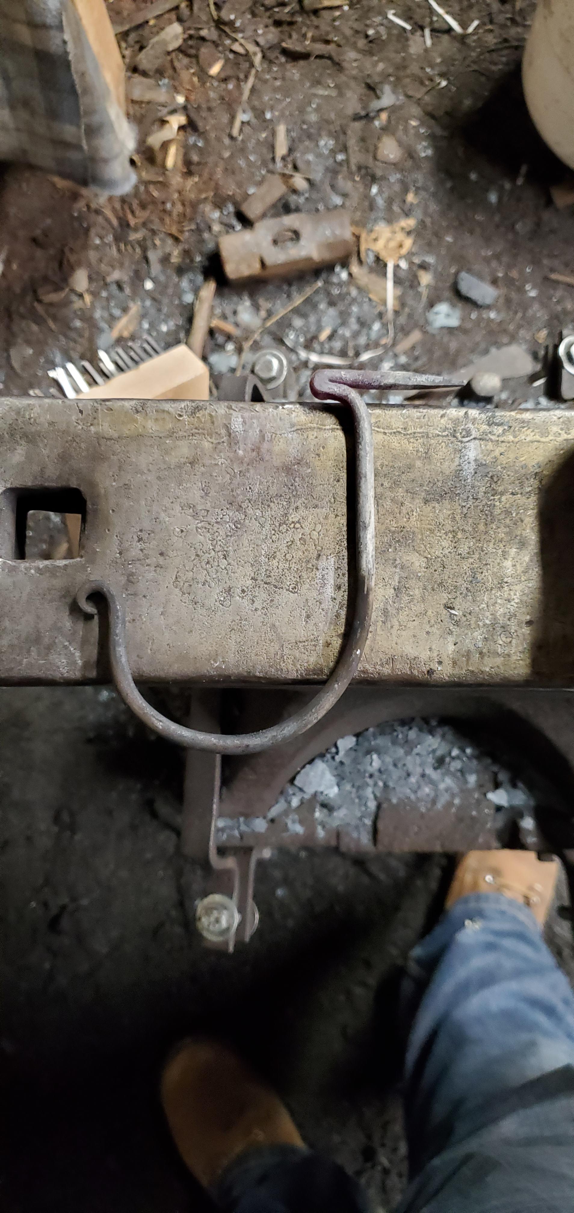

Dewnmoutain Posted March 29, 2021 Share Posted March 29, 2021 Finally got around to chabging from used motor oil as my quench oil to canola oil. First time i used it today. I have to admit, it smells a whole lot better than used motor oil. And i didnt feel like i had smoked 3 dozen packs of smokes in one breath. Oh, and i made a hook today as well! Since people are gonna think this: no, i didnt quench the hook in the oil. Im making a chefs knife and quenched the blade in the oil. Quote Link to comment Share on other sites More sharing options...

Frosty Posted March 30, 2021 Share Posted March 30, 2021 Good to see you FINALLY made the switch! The smell of burning canola oil may be a general observation but it's directly related to heat treatment. Playing semantic games with admin or the mods won't do you any good at all. Worse than that, playing silly buggers just to show you can is going to lower your respect with the rest of us who aren't silly buggers. If you do a good wire brushing on the hook and heat it above smoking hot, dull red is too hot but not enough to do bad things. dip the heated hook in the canola oil and it will put a reasonably weather proof black finish on it. Anything around 400f and up will put a finish on steel of various darkness. Frosty The Lucky. Quote Link to comment Share on other sites More sharing options...
Dewnmoutain Posted March 30, 2021 Author Share Posted March 30, 2021 Im a semantics kind of guy. Especially if the reasoning for something isnt obvious to me or made clear. I ended up putting beeswax/linseed oil mix on the hook. I know the hook wont be outside, but i still wanted to coat it. Ill have to try the trick you mentioned. Never would have thought of it. Thanks! Quote Link to comment Share on other sites More sharing options...
