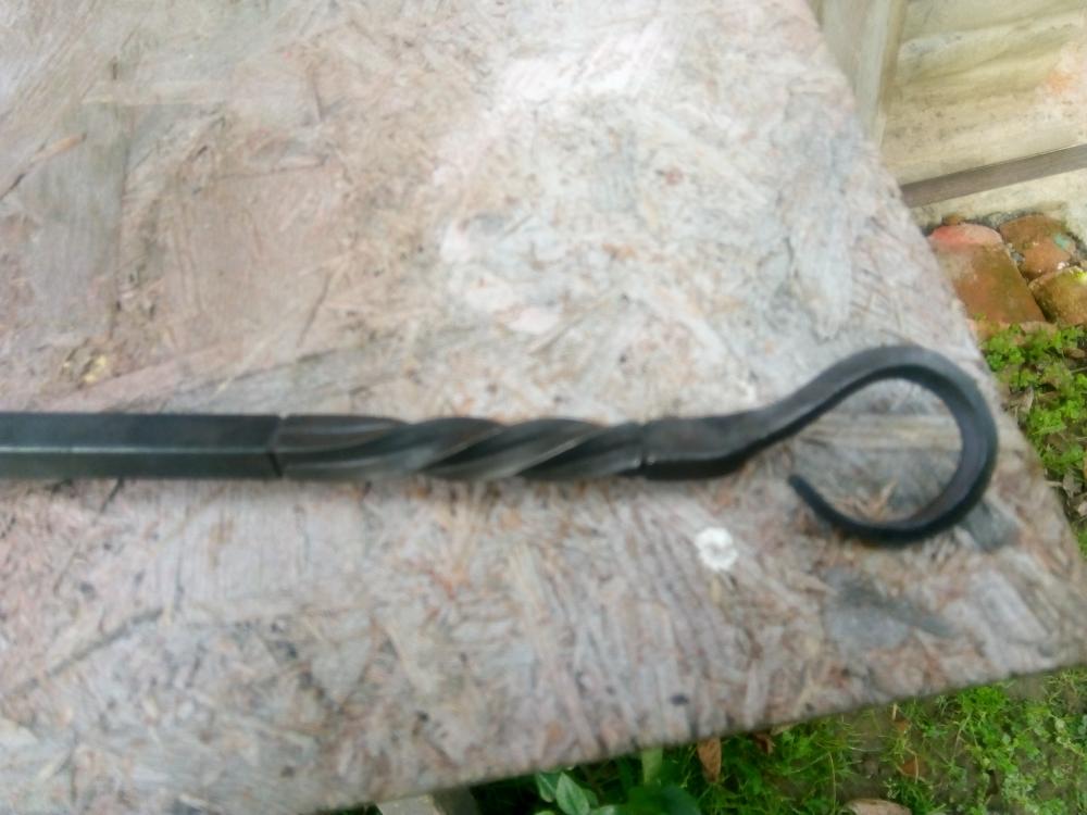

Davor Posted September 19, 2020 Share Posted September 19, 2020 Well I don't know how it's called, but close enough. Link to comment Share on other sites More sharing options...
anvil Posted September 19, 2020 Share Posted September 19, 2020 Nice details. Link to comment Share on other sites More sharing options...
Frosty Posted September 19, 2020 Share Posted September 19, 2020 Nice poker Davor, I think the twisted handle is very attractive. Frosty The Lucky. Link to comment Share on other sites More sharing options...
Davor Posted September 20, 2020 Author Share Posted September 20, 2020 Thank you, I do plan to revisit this stile of handle, I also like it, first time making it. Link to comment Share on other sites More sharing options...
Daswulf Posted September 20, 2020 Share Posted September 20, 2020 Could call it a fire hoe or fire rake. Whatever you wanna call it, it looks good. Link to comment Share on other sites More sharing options...

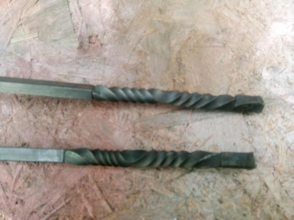

Frosty Posted September 20, 2020 Share Posted September 20, 2020 I think I'd make the twisted section a little longer than your hand but that's about the only suggestion I can think of. There are lots of twists out there. The thing to remember about some of them like the Pineappple twist is to break the sharp points, they're uncomfortable in the soft lady's hands. Ditto Das, if it were a forge fire tool we'd call it a "fire rake" but I like calling it a "pocker." Sure it's a minor translation program glitch but as a new name for a new fire tool it's perfect. Frosty The Lucky. Link to comment Share on other sites More sharing options...
Daswulf Posted September 21, 2020 Share Posted September 21, 2020 Nothing wrong with the name. My favorite fire tool is a large, long handled spoon I forged. Don't hear of forge spoons too often, so a fire pocker is perfectly fine. Especially a nicely forged one as Davor made. Link to comment Share on other sites More sharing options...
ThomasPowers Posted September 21, 2020 Share Posted September 21, 2020 We have a retired couple at our church that split their time between Cornwall in the UK and Socorro in the USA; they have such an implement that they use for their wood stoves in both locations and have been transferring it back and forth. Finally they figured out that I could make another one for them as they were having trouble finding one that matched the one they like. Not as pretty as yours; maybe I should send them your picture and see if they would like to "upgrade"... Link to comment Share on other sites More sharing options...
Davor Posted September 21, 2020 Author Share Posted September 21, 2020 Thank you for all the kind words. Only thing that would make look better would be if tapered all the way from the handle. But working only by hand that would be alot of hammering. Link to comment Share on other sites More sharing options...

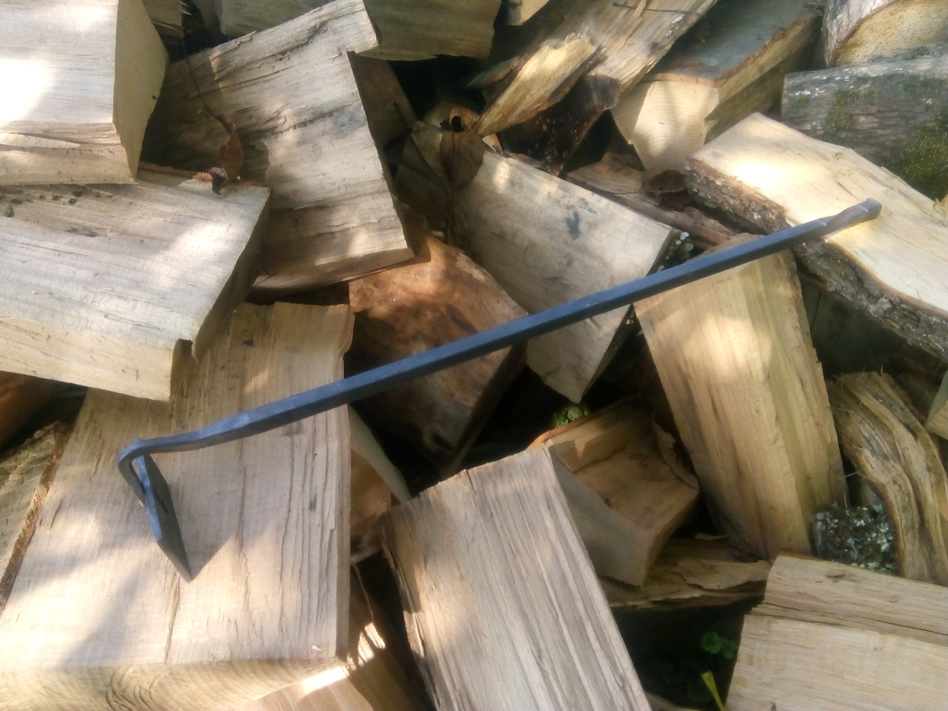

Davor Posted November 2, 2020 Author Share Posted November 2, 2020 Practice. The little shovel is made from a pipe. Link to comment Share on other sites More sharing options...
anvil Posted November 2, 2020 Share Posted November 2, 2020 Very nice! Link to comment Share on other sites More sharing options...

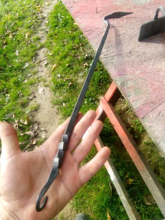

Davor Posted November 3, 2020 Author Share Posted November 3, 2020 More practice, winter is coming and I'm just giving them away. Friends like them. It is deliberately twisted like that because it is for a left-hand friend, otherwise it would be neutral position. I just thought it would be fun. Link to comment Share on other sites More sharing options...
Frosty Posted November 3, 2020 Share Posted November 3, 2020 Nice, I like it. I discovered the ladies don't like twists with sharp corners like a pineapple twist. I broke the edges to round them slightly and the ladies liked them better but still preferred smooth rounded handles. They preferred cable twists so that's what I make them. Guys like the sharper points but generally we have tougher hands. I used to roll bottle caps in my hands for the feeling. Frosty The Lucky. Link to comment Share on other sites More sharing options...

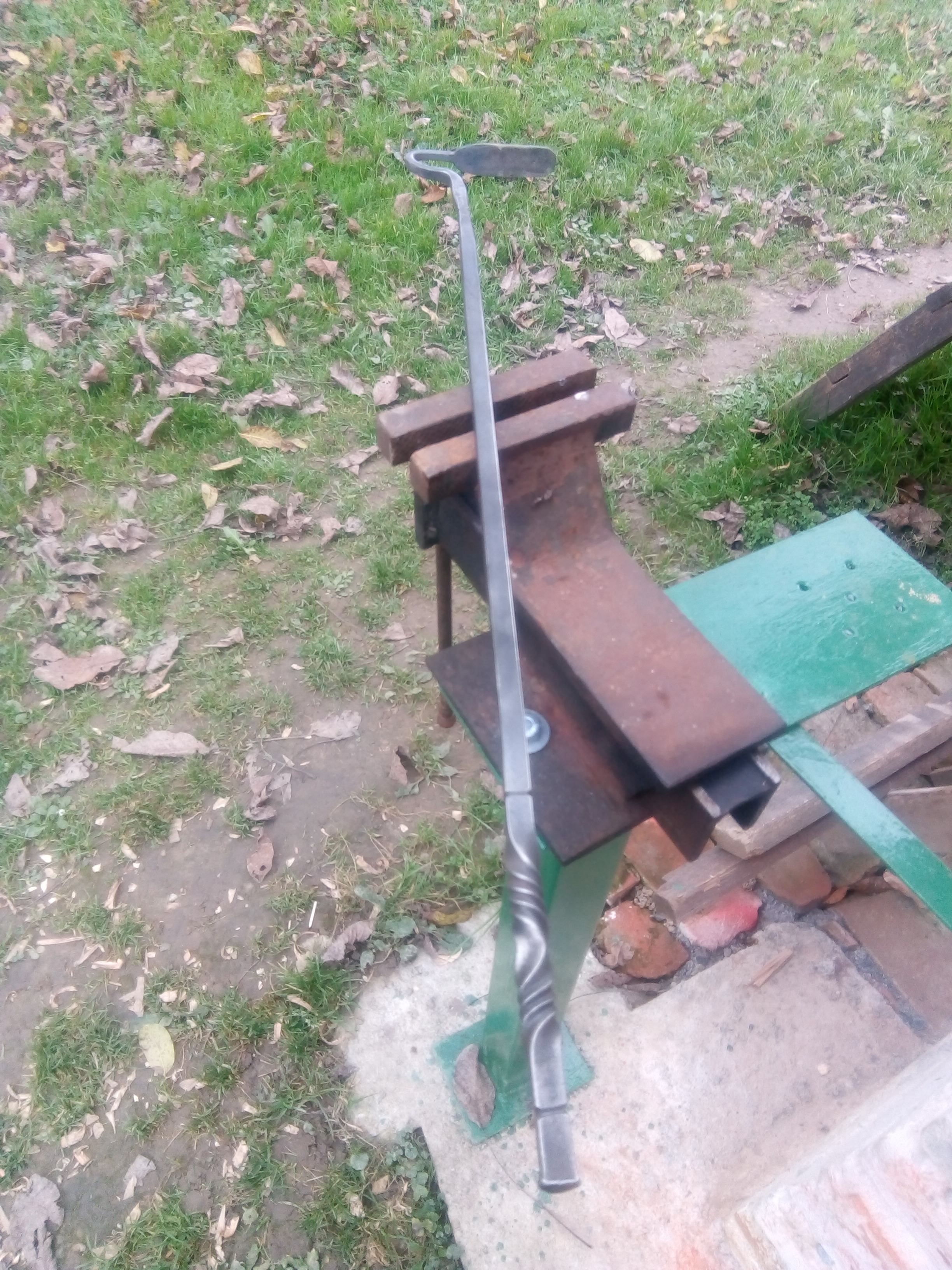

Davor Posted November 15, 2020 Author Share Posted November 15, 2020 Another firepoker. Link to comment Share on other sites More sharing options...
M.G. Posted November 18, 2020 Share Posted November 18, 2020 And another great handle!! I'll be looking to thus thread for inspiration later. Link to comment Share on other sites More sharing options...

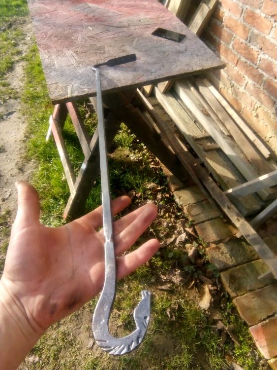

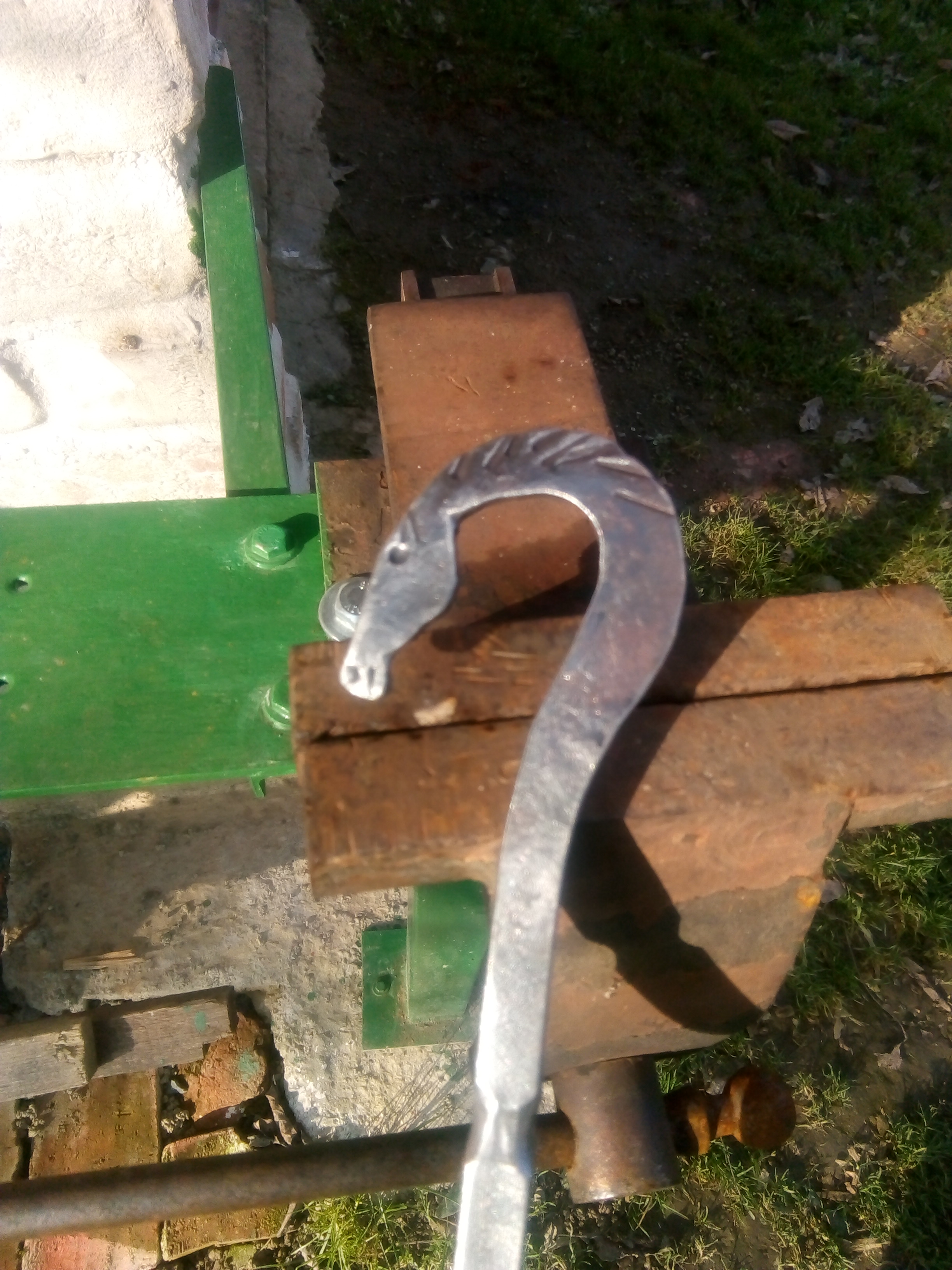

Davor Posted November 29, 2020 Author Share Posted November 29, 2020 More, first try horse head. Link to comment Share on other sites More sharing options...
Frosty Posted November 29, 2020 Share Posted November 29, 2020 That's a very attractive horse head, Davor. You have a strong knack for blacksmithing, you'll be turning out top shelf products in no time. Frosty The Lucky. Link to comment Share on other sites More sharing options...
Davor Posted November 29, 2020 Author Share Posted November 29, 2020 51 minutes ago, Frosty said: You have a strong knack for blacksmithing Thank you, but I only show you stuff I’m satisfied with. I also, today, did eighth twists for a book shelf and was happy with two of those. That is a lesson not emphasized enough. There is no shortcuts for skill you have to put in the time. It is a good thing I’m having a good time learning. Link to comment Share on other sites More sharing options...
