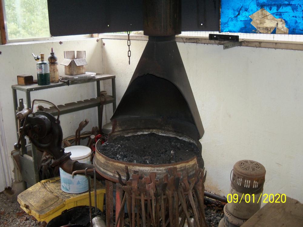

New Coal Forge - Any luck with 8" chimney pipe and half hood?
OK anthracite does not do well with cutting the air off between heats.  I'm sorry you can't find bituminous.
Turning down the air or wasting it through the ash dump and controlling the size of the fire with walls might be you best bet.

If you're using anthracite, scratch the recommendation for a deadman switch; anthracite needs a constant air supply, or it goes out. Have you read the "Recommendations" article?
Note that because anthracite produces less smoke than bituminous, you really don't need the larger size of flue after all. If you do switch to soft coal, consider an upgrade. Otherwise, leave it alone.
I did read that article and decided on anthracite because I can get it from TractorSupply near my house.  I did also try bituminous but it was SO SMOKY.  I find that the anthracite works great between heats though so I am not sure why it says otherwise in the article. I have turned off my fan for 20 minutes and come back to turn it on and it heats up again very quickly. There is a coal supply company in my state that can deliver me bituminous but I am very  happy with the tractor supply price for anthracite.

Your bituminous smokes because you are burning it mixed with the coke it makes in your firepot. This is called a dirty fire. Once it gets going you will end up with coke. Just burn coke and keep the green coal around it. As the green coal burns it makes coke. As you use up the coke in your fire, use your poker/rake and move the fresh made coke into the firepot. Add more coal outside your ring of green coal to replace the green coal as it cokes and you use the coke.  Coke won't smoke if there is no green coal mixed with it. Coke is far better for forging than Anthracite. As the green coal cokes, it produces very little smoke. At the end of the day, be sure you make enough coke to start your next fire. It will start with a couple 3 sheets of newspaper and a match.
With the coke you make,and green coal around the outside, and a good supply of coal around this, you will be able to maintain your fire size with water. So don't get rid of your bituminous just because you don't know how to use it. Since you have access to bituminous, learn how to maintain your coking coal(bituminous), then make a decision based on experience. For what its worth, it took me a few years to learn this lesson.

Pipe size: the pipe diameter should be 1/3 the diameter of your hood or forge. Thus, if you have a 30" diameter forge, you need a mininum 10" dia pipe.  a 12" dia is better. Compliments of Francis Whitaker.

When you have a established fire in the fire pot, adding green coal around the edge allows the heat from the fire to drive the volatiles off the green coal and turn it into coke.  The smoke is the same amount of smoke but it is being drawn toward, and burned by, the fire.  As the embers of the fire are consumed for heat, move a like amount of the coke into the fire to replace them.  Then add more green coal to the outside of the fire to be transformed into coke.  It is a fire maintenance dance that goes unseen by the casual viewer.
When done carefully you can have very little smoke produced.
If you see smoke starting to form, poke a hole in the top of the fire (think volcano) and let the fire escape and burn the smoke.
You only need a fire large enough to heat the amount of metal you are working.  And only enough air to support that size fire.
