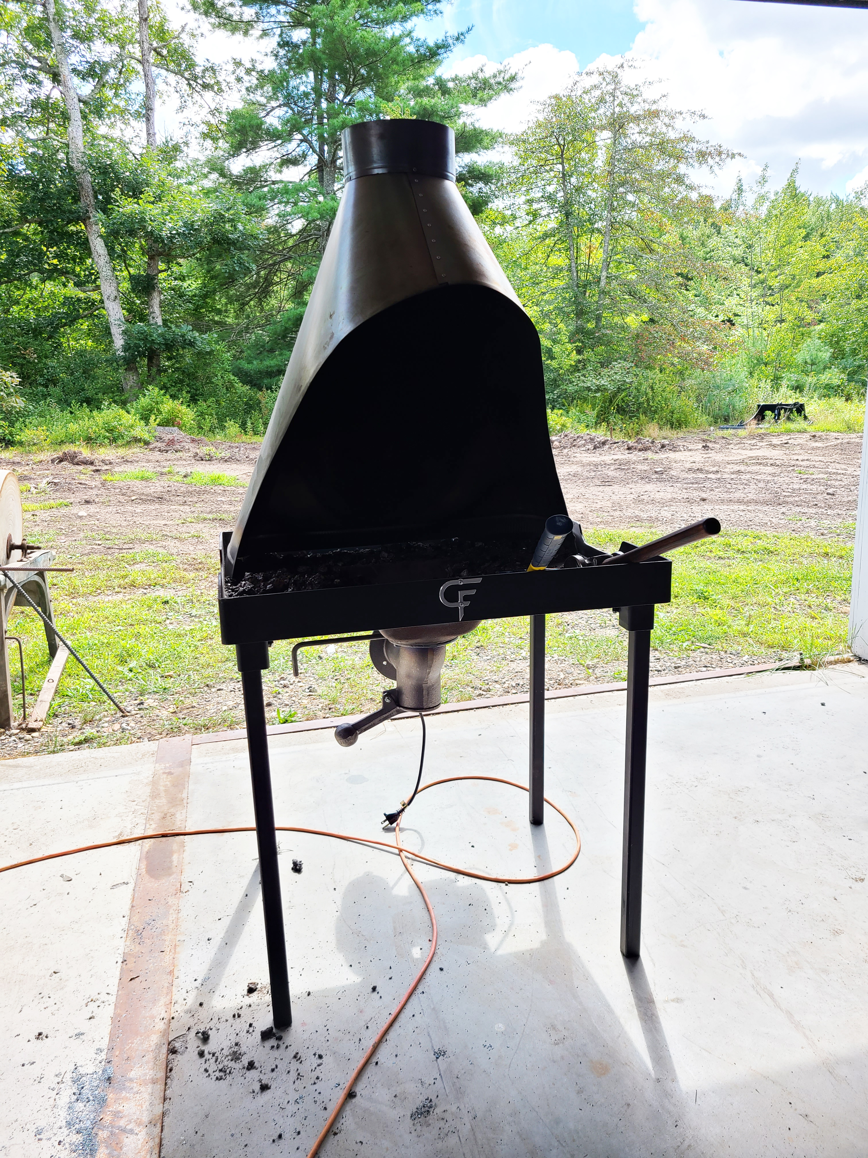

This is my first post here and I figured I could start my adventure into learning to forge by getting some advice on proper forge ventilation.
I purchased a great coal forge for myself from Centaur Forge.  It came with a half hood and also blower and I have been practicing outdoors while I sort out the location I want to install it in one of my workshops.
This morning I had some contractors out that deal with wood stove installations and to make a long story short they are quoting me between 4-5k to install 14' of pipe through the roof of my unfinished workshop.  The hood that came with my forge was designed for an 8" pipe and the contractors said that this would be sufficient.  Everything I have read is saying to use no less than 10" but 12" is preferred.
I am not going to pay that much money for this install and can do it myself but I want to make sure I get the right size pipe.   The folks at Centaur Forge say that they use 8" pipe in their workshop with this hood and it works great.  I was hoping to get some advice about this so I don't have to redo this project later on. I don't mind a little smoke in the shop as its a farm and I am used to it but I want to make sure I have a great draft so when I am burning fresh coal down it doesn't billow into and fill up my whole shop.  I am including a photo of the forge from Centaur.  This is not the final location where I will be installing it.   Thanks in advance for any into you can give.

Contractors said 8 inch chimney would be sufficient.  He is a contractor, NOT a blacksmith.  The blacksmith suggests 10" but 12" is preferred for a reason.
50.265  square inches for an 8 inch chimney.
78.540square inches for an 10 inch chimney or 56% larger than the 8 inch chimney.
113.10square inches for an 12 inch chimney or 125% larger than the 8 inch chimney.
A hood tries to draw smoke and exhaust from the entire room due to the large opening size. A side draft hood only draws smoke and exhaust from the side of the forge due to the small opening size.
Think of it as a production issue. Making the forge with a large opening, small hood to chimney conversion coupling, and a small chimney, is a matter of a lower price for the materials and construction. Lower price means more profit on each sale.
Since you already have the forge and hood, build a fire and watch the smoke.  If it is working properly, there should be no smoke escape and go into the room.  Play with the hood opening by making it smaller.  Clamp some light metal to the top of the opening.  You most likely will be operating the forge from the side which means you can lower the top of the opening and still see your fire and the metal in the fire.  Next use light metal to close in the sides a bit, reducing the hood opening.  Watch the how the smoke acts and how much smokes escapes into the room.  The lungs were designed to breathe CLEAN air.  Anything else can cause problems, especially when you inhale smoke and airborne debris.
Once  you have things working, go outside and look at how much smoke and exhaust is coming out of the chimney.  THAT is the amount of air that must be allowed to enter the room to make up what is being up and out of the room by the chimney.  Open a window or door to allow the make up air to enter the room.

OK, I have to be something of a contarian here.  Bigger is not always better.  This forge was designed for an 8" chimney and I would assume that a certain amount of experience went into that design decision.  The problem with too large a chimney is that the fire may not be heating enough gas to rise in the chimney and stay warm enough to make it out the top.  An oversized chimney will not draw as well.  This is more of a problem in colder climates where the chimney will be cooling faster in cold weather.
Sometimes you can overcome the cold air plug in the chimney in cold weather by lighting some news paper and letting it start the warm air flowing up.
If it were me, I'd put a section or 2 of 8" stove pipe on the hood and fire it up outside.  If it is drawing well then I would install an 8" chimney in the shop.
Remember, the top of your chimney should be higher than the peak of your roof so that wind blowing over the peak doesn't create turbulence that will result in back pressure down the chimney.

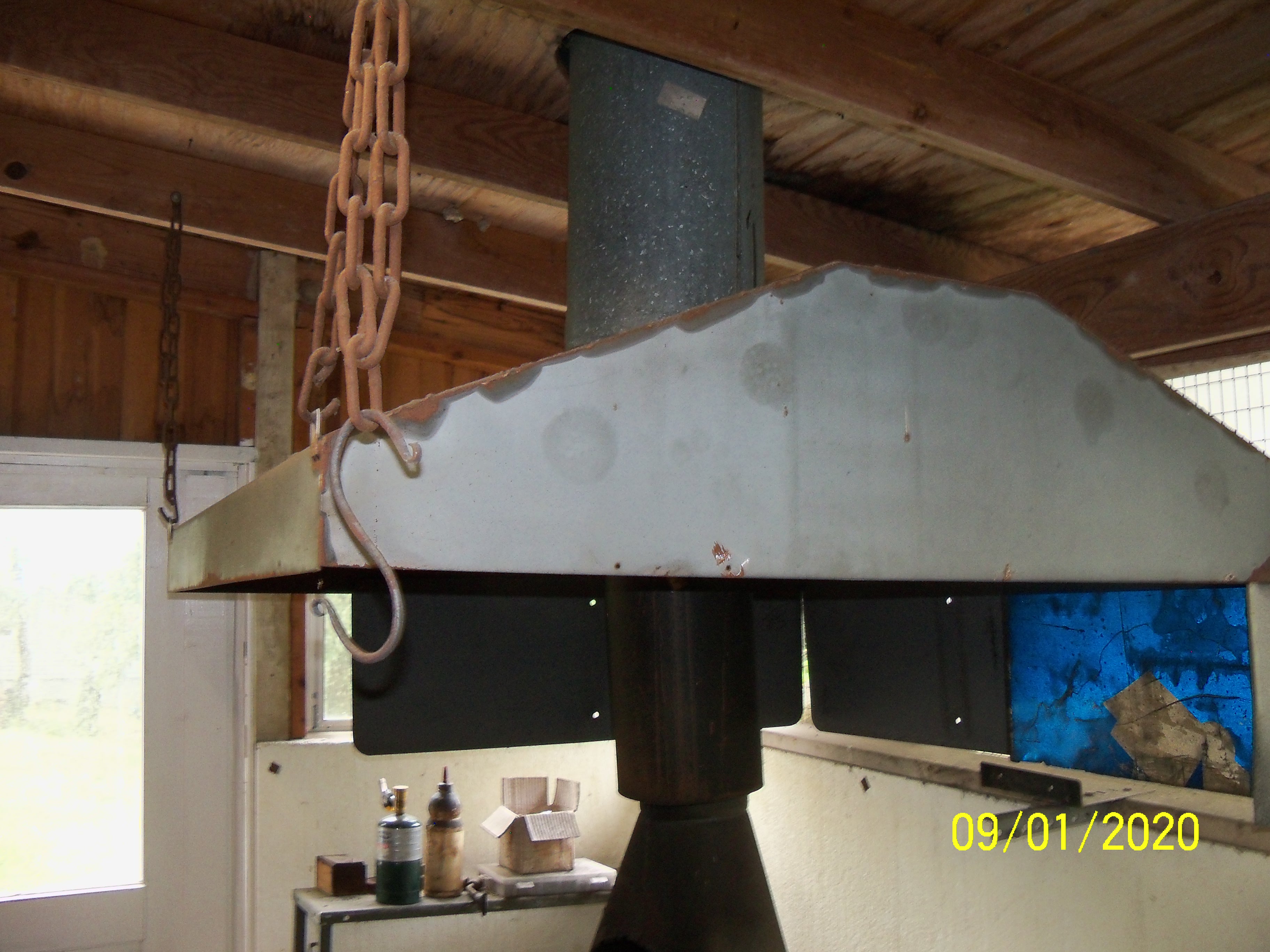

I have basically the same hood as yours. The hood had an 8in connector like yours. I cut it off and the 10in pipe just sets on the opening then runs up and fits inside a 12 inch double wall, that goes through the roof with a weather head on the top. It draws fine, after I preheat it with a propane torch. If I try building a coal fire when it's cold it will smoke a lot till heated up. I'll get a couple of pictures for ya. I found this one on the computer from inside. The large hood was going to be my only one, but it didn't work at all. The 12 in double wall through the roof rests on it.
Thank you all very much.  I am on the fence about it.  It would  be much easier to size up to 12 if the 8 doesn't work out.  I can DIY the install.  Closing up the sides won't work for me as the things I want to make are long (garden stakes and such).  If I do size up I have no problem using some mapp gas to get it warm in winter. I am in RI so it does get cold.  I am curious to see your hood Irondragon.  I won't cut into mine myself but there is a guy who I can take it to locally.

Boy my memory must be shot. I thought the hood flange I cut off was 8in, but when I looked at it, I hadn't cut it off :wub:  and I thought that's not 8in so I took calipers and measured the pipes. The flange I thought I had cut off, been about 30 years since I installed and patched the system is 6in. The pipe it goes into is 8in and the inner pipe of the double wall through the roof is also 8in. I have been planning to reduce the opening of the forge hood for years now but haven't gotten around to it and it works well after pre-heating a little. So basically my stack is 8in. Here are the pictures, hope they help.
Here is an old one of it running and no smoke after the preheat got the draft going. So I don't think you will have a problem with 8in.
