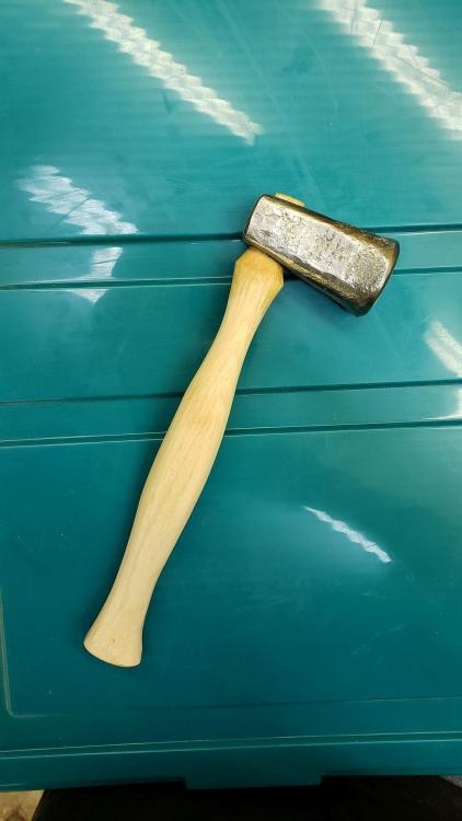

Chris C Posted June 23, 2020 Author Share Posted June 23, 2020 Well I made the handle. The head end of it is sitting in a cup of Boiled Linseed Oil. I'm kind of embarrassed to show it to anyone. Doesn't look anything like any blacksmiths hammer handle I've ever seen. On the majority of Dog's Head Hammers it looks as if the maker used a "Tomahawk" handle..........just straight. This looks more like a carpenter's pin-nail hammer with a thinner neck. I've always liked thinner necks on hammers because they allow the head to whip a little and they also don't seem to transmit vibrations back up the arm to the user, which I believe contributes to what many call "Blacksmiths elbow".........or Tendonitis. Of course, that's just my (uneducated) opinion. As good as the handle feels in my hand, I think I'll post a picture of it before actually installing it to see if there are any "no-no's" I've committed. Originally I was going to shape the handle on my new belt grinder, but I didn't have a belt that did well with wood, so I used what I'm most skilled with, knives and a spoke shave. I like the faceted surface and only hit it lightly with a 220 grit 3-M pad to slightly soften the facet edges. Quote Link to comment Share on other sites More sharing options...
ThomasPowers Posted June 23, 2020 Share Posted June 23, 2020 Looks fine to me and if it works for you it's a good handle---even it it has a helical twist in it! (Of course I like terminal bulbs on my hammer handles as I don't have to grip them as tightly as a hawk hammer handle...) Quote Link to comment Share on other sites More sharing options...
CrazyGoatLady Posted June 23, 2020 Share Posted June 23, 2020 I agree with Thomas. If it works for you, that makes it a good handle. I left a bit of a bulb in the middle of my main forging hammer handle and I've used it like that for about a year and half. But I'm considering shaving that down now. The way I work has evolved and that bulb isn't working for me as well as it once did. I think that's the way it is for all blacksmithing. The more you do, the more you develop your own way so there's no one size fits all Quote Link to comment Share on other sites More sharing options...
ThomasPowers Posted June 23, 2020 Share Posted June 23, 2020 Not to mention that we can modify our tools to suit ourselves! Quote Link to comment Share on other sites More sharing options...
bigfootnampa Posted June 23, 2020 Share Posted June 23, 2020 For your next one... walnut is a poor choice but ash is fine. Any hickory is very good including pecan! I actually prefer green wood for most tool handles. It’s best to dry it after shaping but before final fitting. Short tool handles are easily dried in a microwave oven. Baking in the sun for a few days works well too. In summer my pickup’s dashboard is a handy drying oven! Once you’ve worked a lot of green wood... it’s not scary anymore. The finished products are much superior! Air dried woods are prettier, stronger, more flexible... basically better in every way! If I happen to have a handle that splits when dried... I just fill it with epoxy or super glue. The cyanoacrylate (super glue) is for very thin splits that I can’t get epoxy into. Yard trimmings like lilac, holly, dogwood, oak, redbud, persimmon and many others can be good handle materials! Quote Link to comment Share on other sites More sharing options...
Chris C Posted June 23, 2020 Author Share Posted June 23, 2020 Thomas, the helical twist at the top isn't so bad. It's when it reverses itself toward the butt end of the handle that poses the problem. I may actually trim that bulge down a little, CGL, but for right now I think I'll just make it a permanent handle and go with it like it is. Quote Link to comment Share on other sites More sharing options...
