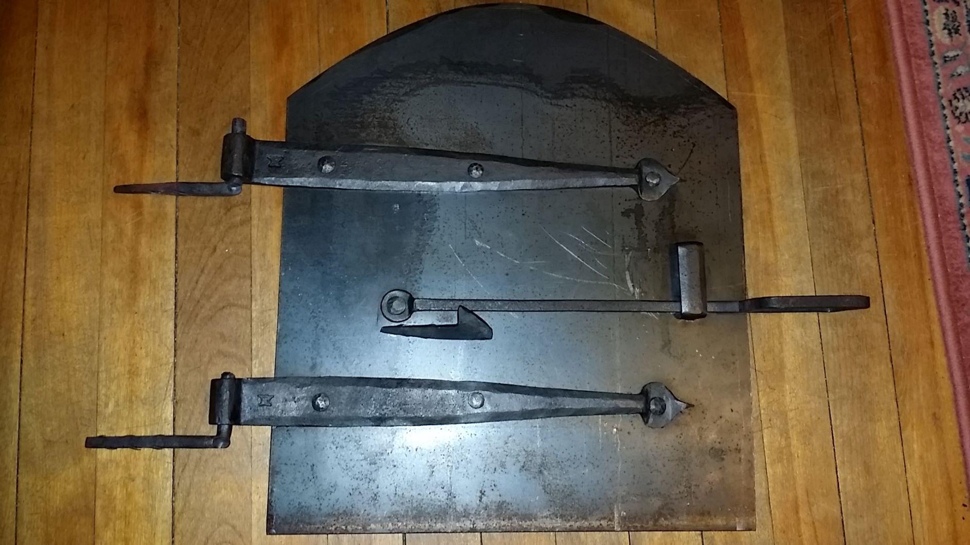

Hinge on the bottom after a design in the Hammer's Blow (ABANA publication).  Rolled barrel.
One piece forged corner pintles and forge welded barrels.

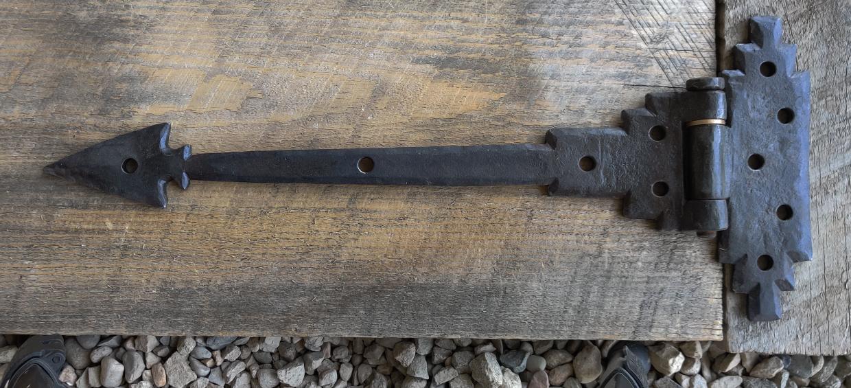

Big barn door hinges, 4 foot long.  Forge welded.  The ring pull is also a latch, it rotates.  Barn is new construction but traditional timber frame, all wooden joinery.

Judson, wonderful work.. I also love that finial in the first photo with the holes.. Not sure what you would call it on the square bar.
I love that hinge too.  Very nice clean forgings.  Excellent to see..
Do you happen to have a top view of the welded strap hinge barrels?

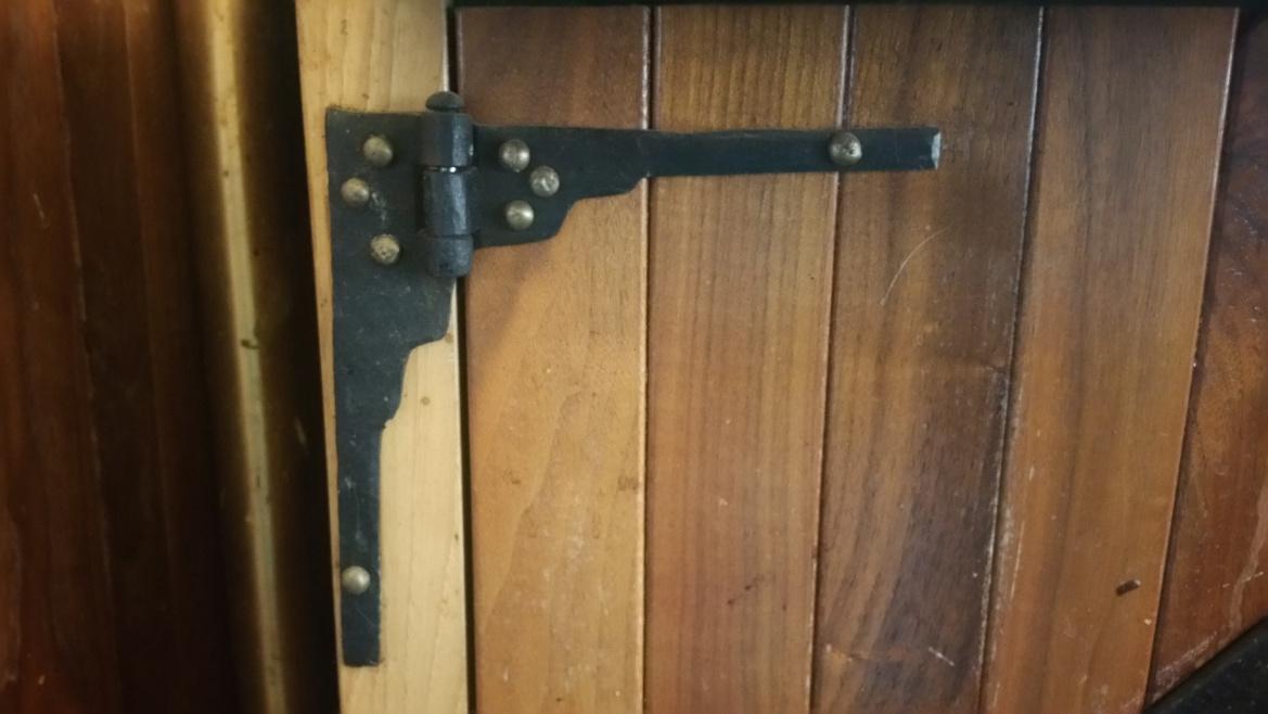

I thought I'd show other things that need hinges. Forged Hardware is a great way to make some good money as a part time or full time smith
260818133_southwestdoorhardware1_1.thumb.jpg.e3b32ea020537471ddc35bf3cfaedad6.jpgthese hinges are a simple butt hing with a forge welded barrel. The purpose of this iron is to not be the focal point but to accent the woodwork and draw your eye to the wood details. It is an oversized door so I added oilite bushings and a thrust washer. The finials on the eustion match the seashell carved into the door.1217955747_SWStrap1_1(1).thumb.jpg.8e460c092c8d2f4e54a79179b72dc89d.jpg
This is the heaviest hinge I've made. 3/8" mild steel  Forged welded barrel. I often add a oilite or brass washer to protect the steel from wear.
Rat tail hinges are one of my favorite hinges
This one was for a set of French doors. Fog welded barrel.
The attachment is a lag screw with the head cut off, then I added a forge welded collar for mass. A delicate weld here done in one heat. The length of this piece matches the offset of the cabinet door. This has no off set the door was flush with the jamb.
I've never had the luxury to just practice, so I make a sample that tells the story of how it's made and to find the boogers and traps. Then OJT to for "practice". It took about half the job to be able to get this forge weld in one heat and not have the butt weld etc to disappear.
Pintle hinges for fireplace screen. Rolled barrel.
For those who prefer forge welded barrels, the top hinge barrel is forge welded to the strap. The choice between rolled or forge welded barrels for me is determined by many things. Basically the time difference is minimal, so the choice is esthetics of each job.
