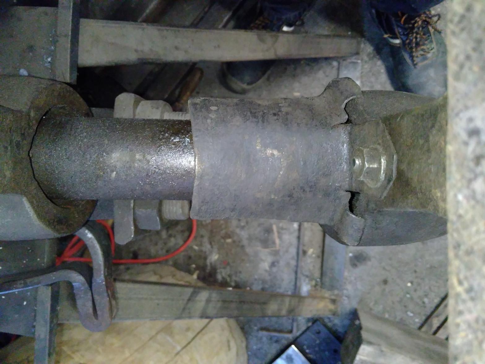

It looks like a real work horse, just needs some TLC. It's a new one on me, first I've seen of that design. One question, what type of spring to open the jaw and where does it go? From one picture it kinda looks like might be a V spring inside the pivot box.
Sorry for the lousy picture, it was raining!
The spring is about 20 cm long. The guy I bought the vice from, had few more modern (and much more expensive) German leg vices and indeed they have the "V" shaped spring.

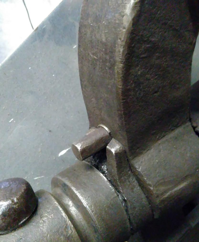

I forged a wedge to lock the pivot pin

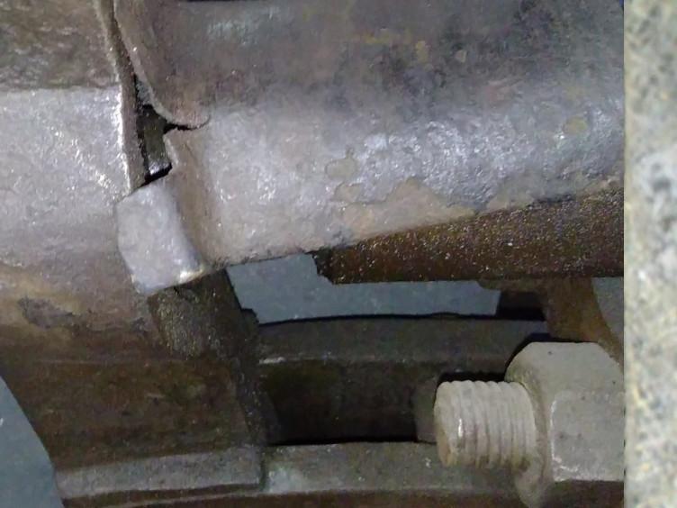

And I welded a stopper for the thrust washer (if you are a purist, look away now!)

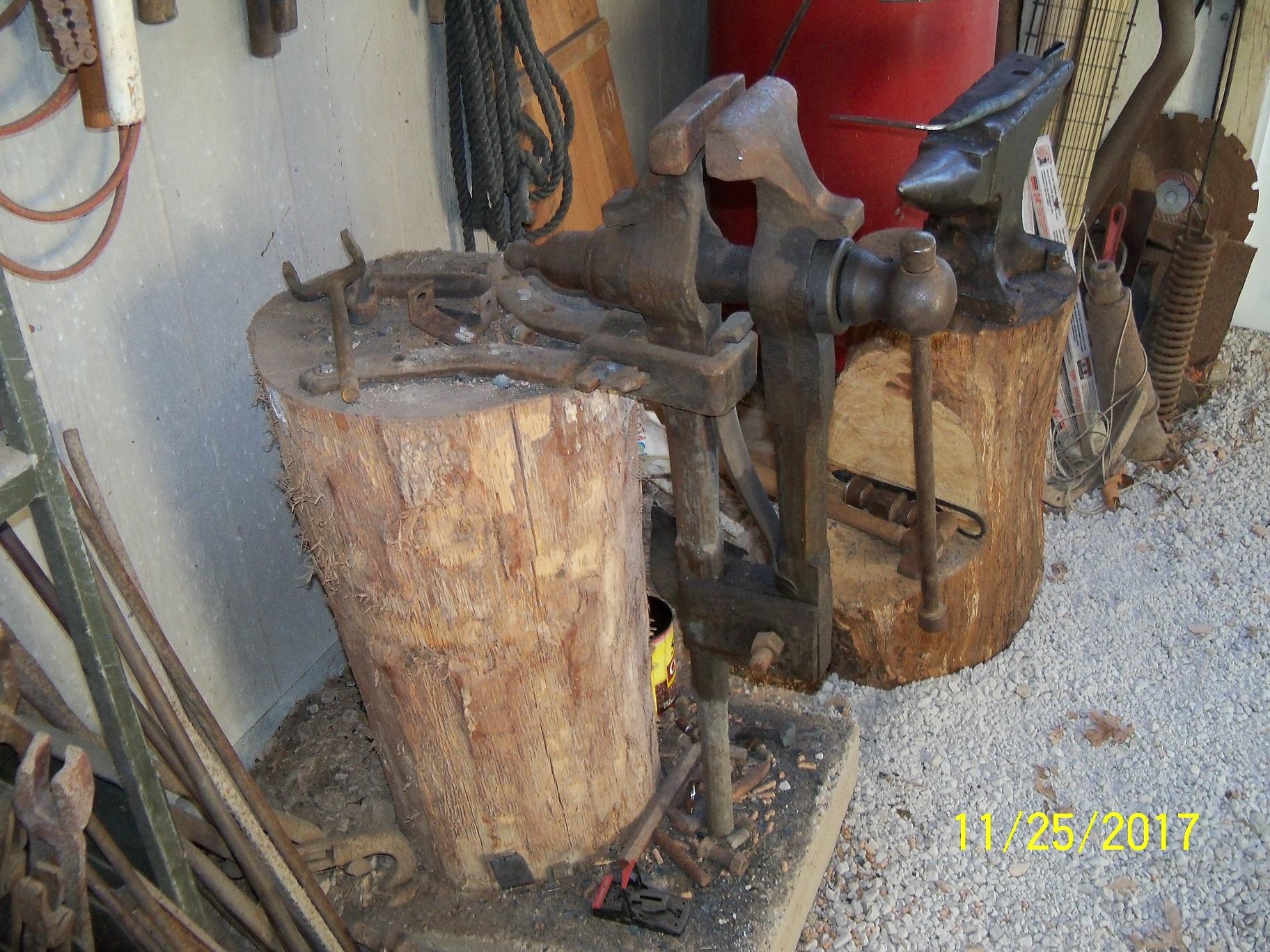

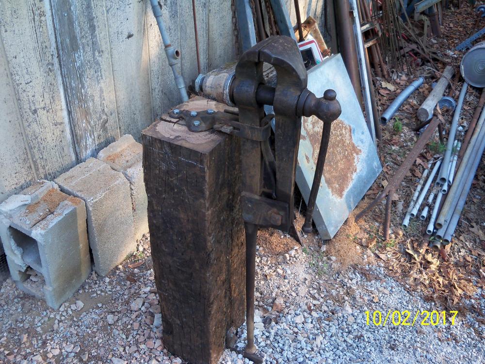

That model look like mine , especialy "moustache"  part where vise is bolted to base.
natkova!
I’ll never see another post vise that has that style mount without thinking of your analogy!
from here forth i will start calling those moustache mounts!
Those mounts are common on German patterned vises. I see them being called swallow tail vises around here. But I don't know any smiths who call them that. on German vises here you see either this type of mounting bracket, a simple plate, or the spade finial, in that order of frequency.

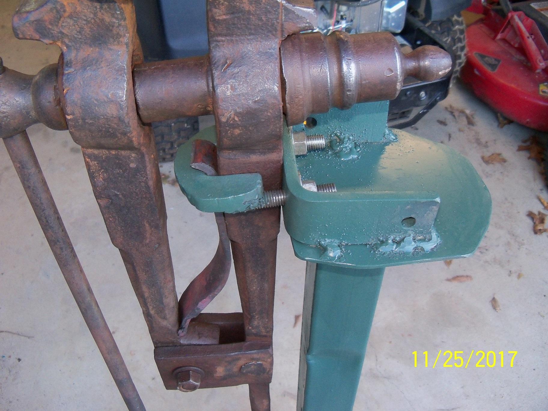

Ubolt mounts are common and work well. Muffler clamps work well too.
