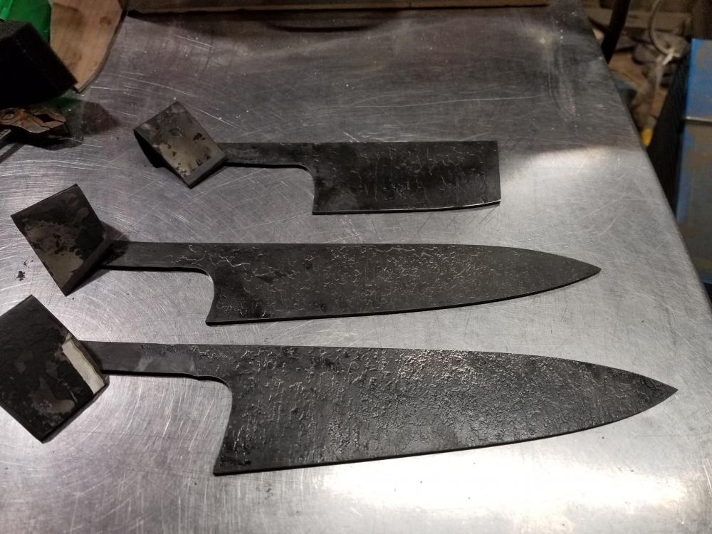

Working on a big batch of sanmai. About 11 pounds worth of sanmai actually. Most of it is straight low carbon jacket steel sanmai, and a small portion was 410 SS jacket sanmai.
All of the billets contain a flavor of German tungsten carbon steels that resemble what's available to Japan from Hitachi.
I've had problems with SS sanmai in the past, but was able to pull through this time. Forged quite thin as well. All 3 knives have a spine thickness above the heel .105" thick or thinner (the small blade is like .089" above heel at spine.
Anyone who has forged SS sanmai, knows forging it thin is quite dangerous as the SS likes to be HOT or the billet wants to break apart.

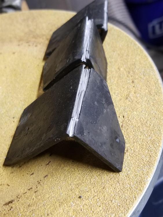

Heat treated this batch along with some test swatches to check my HT of these difficult steels, with great success. Both the SS and core steel display silky tiny grain, even zoomed in. Core steels are 1.2519, 1.2442, and 26C3 ( not a tungsten steel)

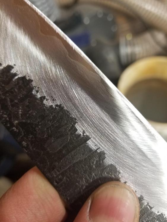

60 grit off the belt inspection. Core centered on both sides, edge is at .010-.005ish. Taking to disc sander to refine and move up in grit and maintain consistent surface. Then to stones. Will grind what is known as a hamaguri grind.

Got the first of 3 almost finished.
Now for the handle and saya.
The geometry of the blade is called hamaguri.

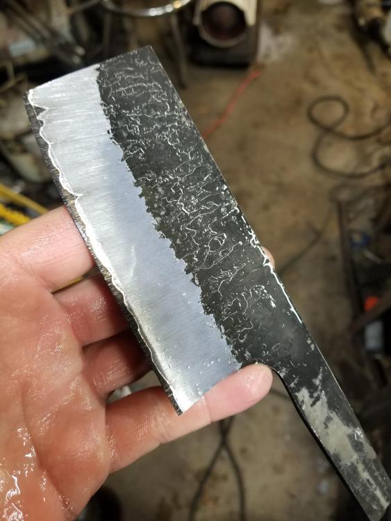

Here is another one with a core steelcsimilar to Aogami 1 called 1.2442.
This knife is a little different in that the wide bevel is coherent to the forged surface, and will be stone polished. These pictures show the multi-faceted bevel that is called Hamaguri in Japan. I take the edge to .001-.002" on a disc to 220, and then take it into my home where I will begin my process of stone polish. By the time I'm moving into natural stones from synthetics, the edge will be 0" and rather forming a burr.
Usually I sharpen a secondary bevel in but ive had some requests not to. This would be reserved for pretty much only the most serious stone polishers to be practical, as the act of polishing the entire wide bevel is also sharpening, much like sharpening single bevel knives from Japan, except you are forming a burr twice.

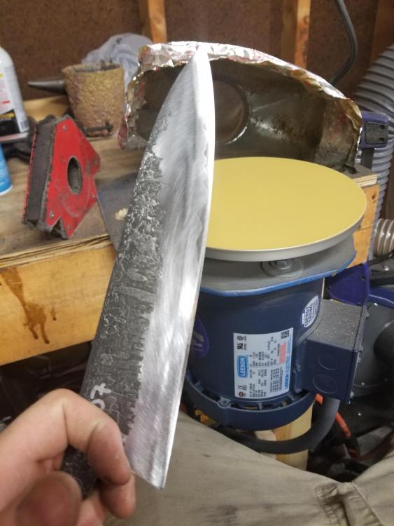

Interesting sander in that last photo. Is that a horizontally spinning disc mounted directly on the motor shaft? Have you done a thread about that anywhere?

I too, am interested in your sander.

This is indeed a horizontal disc grinder. I made this one actually, modelled after the ine KMG makes.
1hp motor with a KBAC VFD for total speed control.
I basically plasma cut out of .250" 1018 plate a motor mount. Install motor, vfd and disc.
I spent around half the cost of the KMG model.
