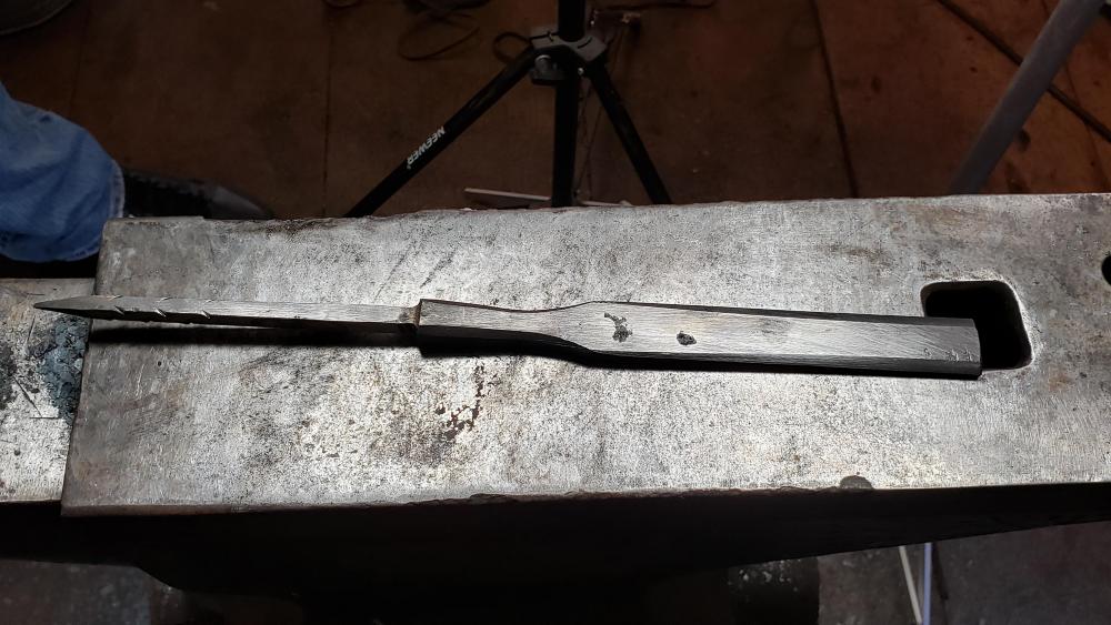

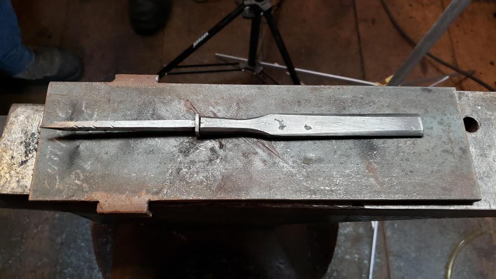

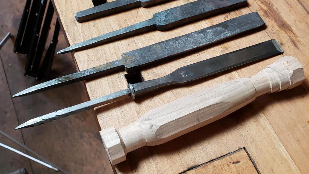

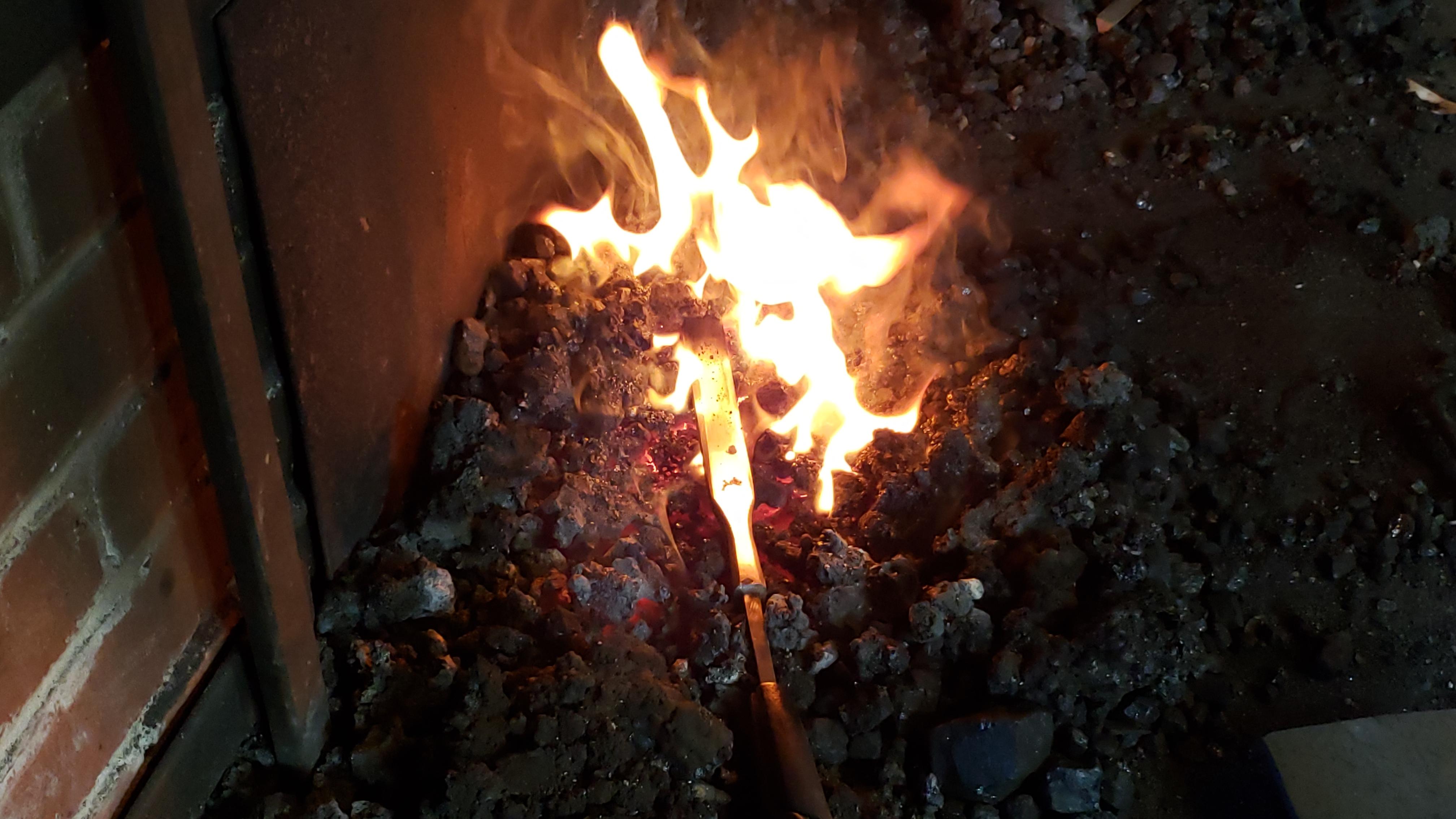

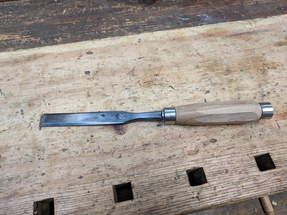

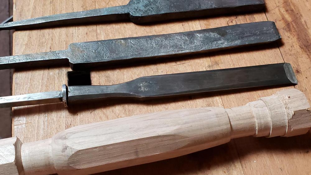

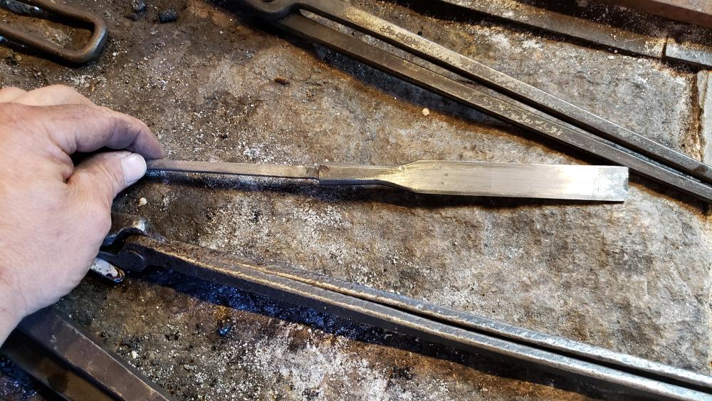

jlpservicesinc Posted December 7, 2019 Share Posted December 7, 2019 Was contacted by the EAIA (Early American Industry Association) and asked if I would be interested in making a video of forging a wood carving chisel the old way.. I said sure.. Today was filming day and while I don't have any footage finished I do have a few photo's. Last Thursday I went over and did the story board pieces and today was complete forging including the washer.. Made from 5/8" sq wrought iron with rasp for cutting edge I don't have very many detail pics as I left the items there for filming. I scooted out just after bevel for edge was put on. 4hrs start to finish with filming. it was interesting as I noticed I have a tendency to say something in a particular order off the cusp and when asked to say it again. I don't even remember what I said exactly.. it was rather interesting. Commercial advertisement removed Quote Link to comment Share on other sites More sharing options...

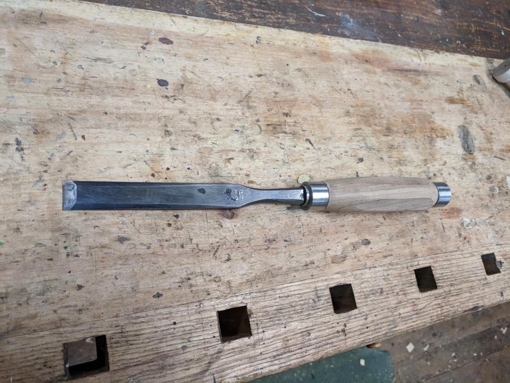

jlpservicesinc Posted December 7, 2019 Author Share Posted December 7, 2019 Robert, your very kind and for sure welcome to come for a visit. Building hasn't gotten any further but tomorrow I am hoping to get some plowing done and back to work with some clean ground next week before the next snow storm.. So, here is the chisel handled and ready for use. I like the " Your work and your youness, inspires me.".. LOL.. Thanks Quote Link to comment Share on other sites More sharing options...

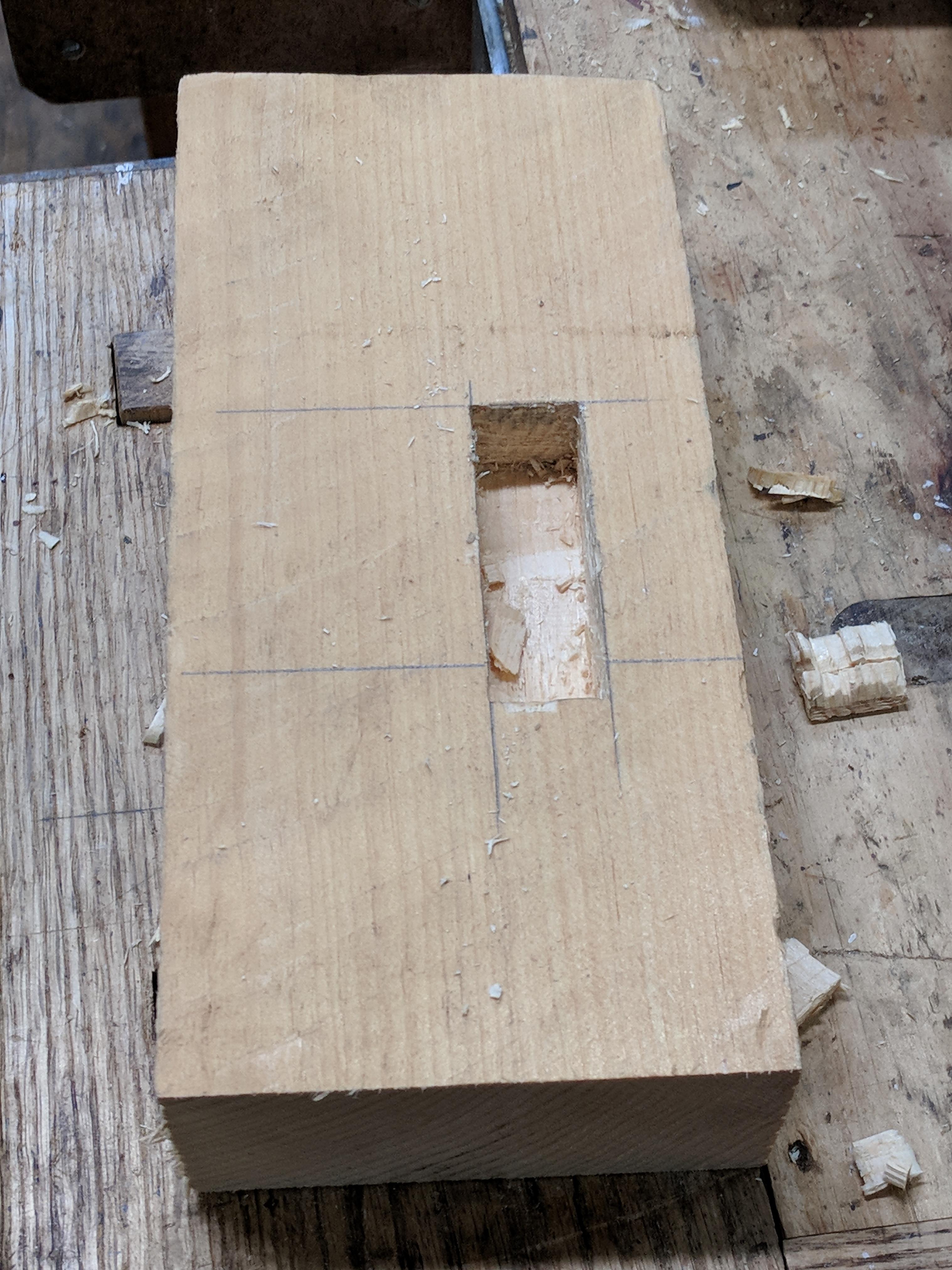

jlpservicesinc Posted December 7, 2019 Author Share Posted December 7, 2019 Thanks CGL. In certain circles I get some respect.. LOL.. Thanks for the kind words.. Your well on your way and your work is very nice and well finished.. These are the tenets to a great smith. Getting some 1 on 1 time with a good smith can help out but you are doing very well. I love seeing what you have going on. I got the report back that it cut nicely and it survived the initial test on cutting a mortise in yellow pine. Quote Link to comment Share on other sites More sharing options...

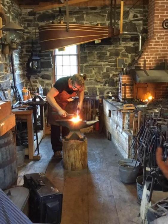

jlpservicesinc Posted December 8, 2019 Author Share Posted December 8, 2019 Frosty, I'm the customer.. The request to me was for the video footage. I told them as the stipulation that I will be taking the story board and finished example for the shop. I also asked for a copy of the finished video and raw footage.. The finished video will not be modified by me.. but the raw footage will be put into the video I had taken to offset some of the lost footage as a set and forget filming method, which somehow the lens ended up out of focus on the last 1/4 of the build.. I of course will give credit to the videographer and run it by him before publishing on the footage I do use. Thanks.. I like this kind of work so it was extra fun.. Here is a photo of the shop which was from the last time I demonstrated making a Carving hatchet for the EAIA, which is an exact copy of the original shop which was moved to Old Sturbridge villiage this the Moses Wilder blacksmith shop in Bolton, MA. Well the copy.. the orginal shop is in OSV. Quote Link to comment Share on other sites More sharing options...

jlpservicesinc Posted December 8, 2019 Author Share Posted December 8, 2019 As a side note. Anytime I donate my time or forging knowledge i don't expect anything in return other than a credit as to who is doing what. I do it because it's what I enjoy.. I got to work in a nice shop, work with nice people, answer some great questions and share not only my knowledge but love for a thing I still find to be fascinating. Chelonian, Thanks, I don't know yet. I wasn't able to try it. When I put the first bevel on it felt good on the cutting edge. Usually will take a few sharpenings to get back behind the rounded edge.. I left it full length vs docking it back.. (at the end of a file stroke the file has a tendency to fall downwards rounding out the metal. This is fixed by filing straight across with a file plate so the file does not fall away/rock.. Or the end is cut off or docked. I did neither.. So once it's used a few times and needs to be sharpened it will be worn back instead.. ) It will be shipped back to me in a few weeks once all the stills are taken and processed. It will be a great show and tell piece. Quote Link to comment Share on other sites More sharing options...
