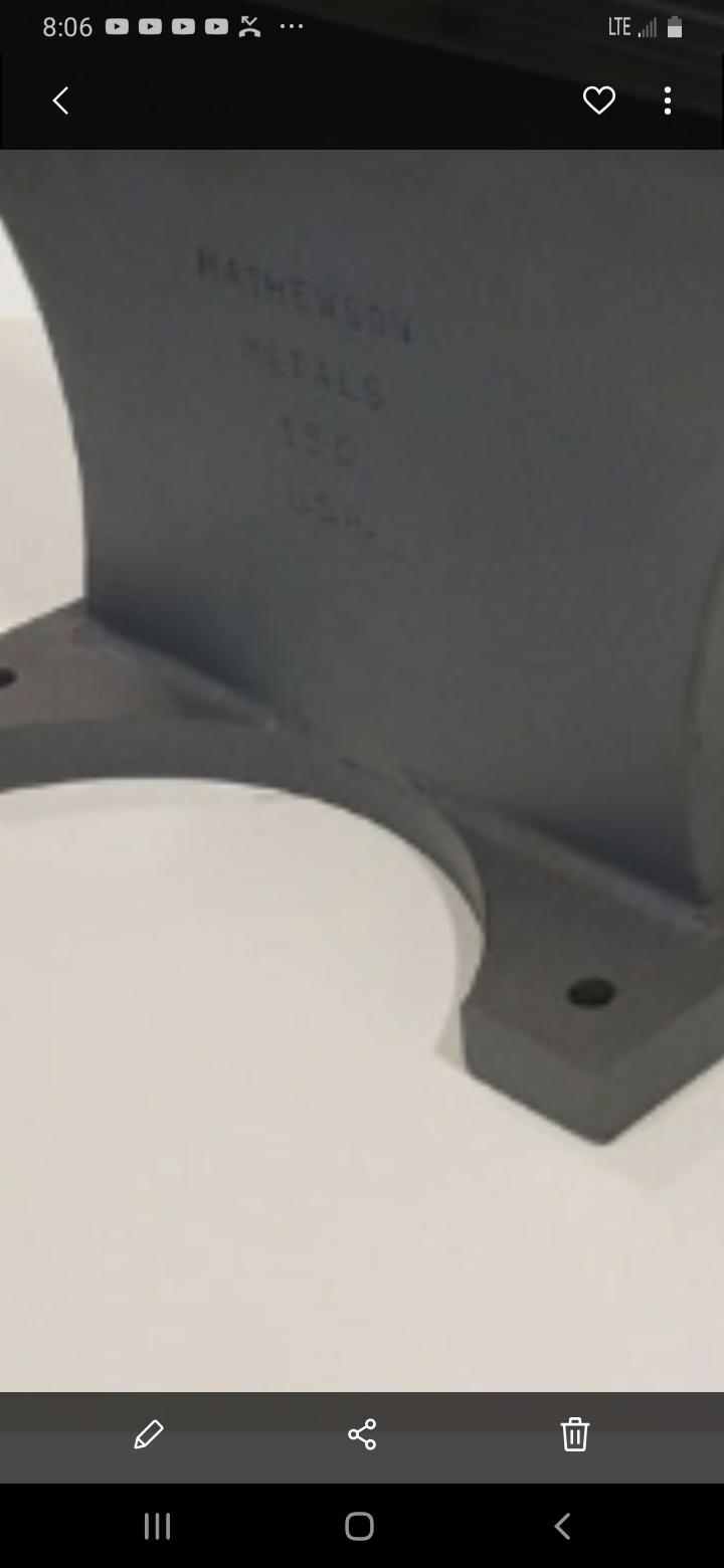

Hi Benona blacksmith. The Mathewson Metals anvils look good but I have concerns about them. From what I can make out from the small photos on their website, it looks as if the base is welded on with an electric welder, which is ok if done properly. They also claim that that the anvils have a Fully hardened and heat treated tool steel face. Does this mean face plate? If so, do they mean it has a welded on face plate? I doubt it would be forge welded on and if its welded on with an electric welder it would need to be done properly, full penetration right to the middle of the anvil.
Maybe im wrong and its a quality hardened cast steel anvil, has anyone here had any experience with them?
I don't see any welding lines and it has mathewson metals on the side which appears to be cast in the side.
The only way to zoom in on the photo was with a screenshot so it's not the best quality
Good point about the writing, shame there aren't better quality photos on the website so we could see for sure
