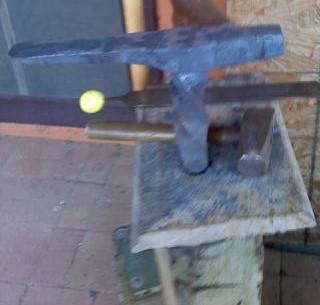

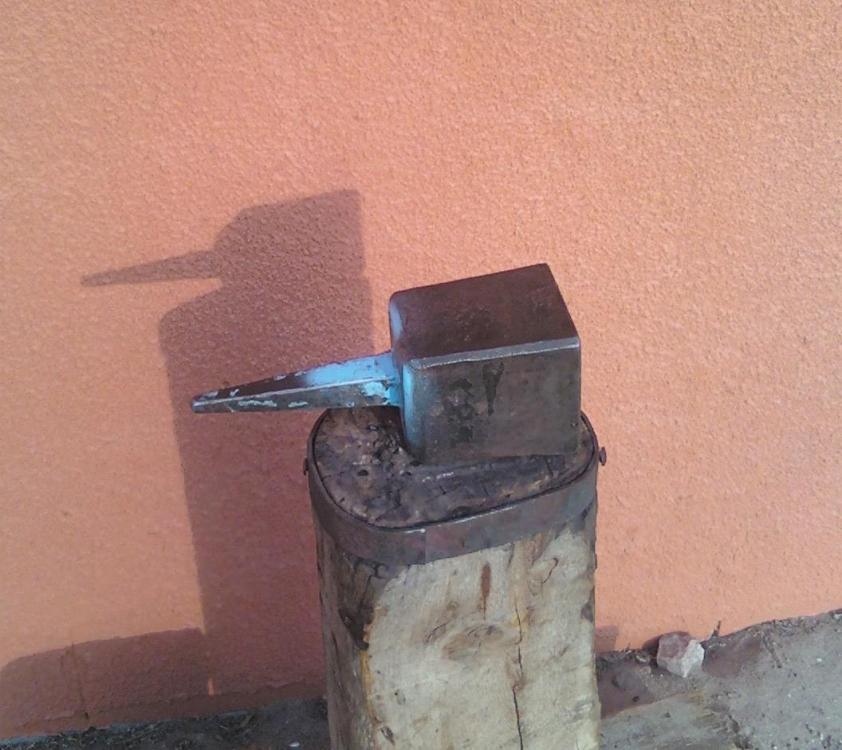

However there are ways to make your own; see my avatar picture?  I was forging a chunk of 2.5" steel to make a shaft for a stake anvil that was made from a RR spike driving sledge hammer head.   Note that I didn't own the 200# Chambersburg Hammer I was using. Below is a couple of shots of a different stake anvil I did, again with help of another smith and finally a picture of my "historic" anvil; forged from a singe piece of 5" sq stock by a highly skilled smith with access to the big tools!
930763857_stakeanvelette1(2).jpg.a252f3fdfa6c46cfdf882963f615833d.jpg1759307953_stakeanvilette2(2).jpg.569c99dfa459c324cbd59508b68cf771.jpgY1Kanvil2.jpg..thumb.jpg.4f860fc1e439ae037e793ab4bd3b679d.jpg
So stop by the shop and I'll get you started on one---I've been collecting odd sledge heads to make a bunch more---note no electricity in my shop currently so it will all be done by hand!
