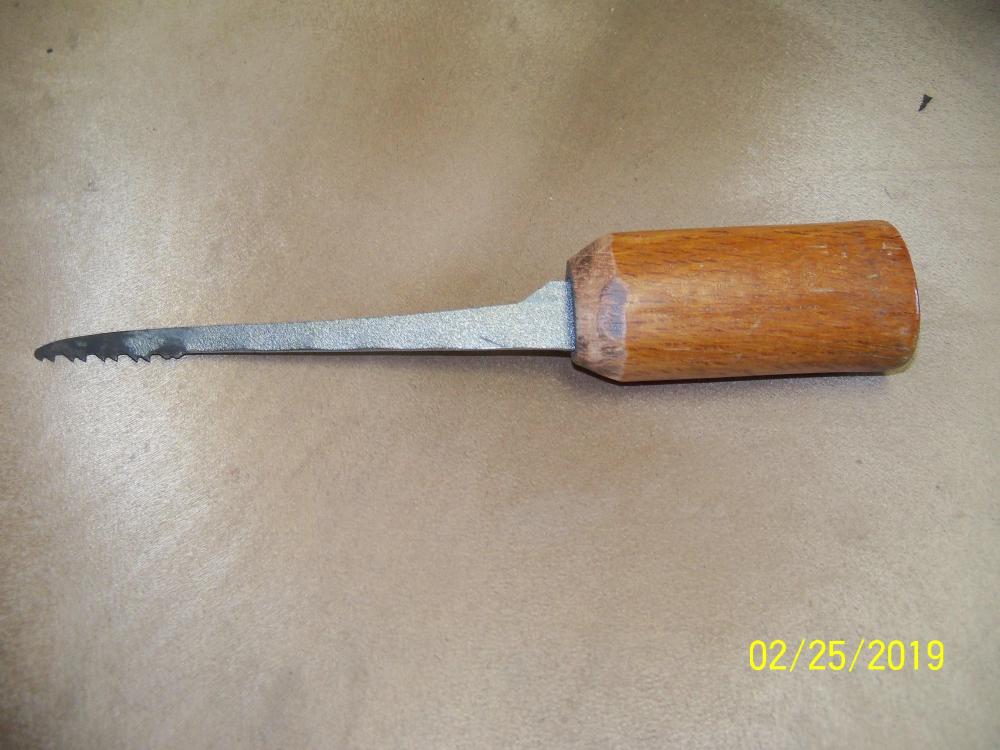

Apologies if this isn’t the right thread for this post but I have what may be a silly question. I’m trying to find a small saw to use to hollow out handles for through tang knives. Any idea on the name of this? I tried searching keyhole saw but that’s mostly for drywall. If you know anything let me know!
You might try looking at mortising cutters.  Though most are for "thicker" cuts than a tang, there are some finer sizes available when you dig a bit.
Or grind your own from a power hacksaw blade---might make 2 a cut on pull which can be very thin or a cut on push which needs a bit more heft.
Echo that, IFC! I'm making a couple of these tomorrow! Thanks for lighting the spark!
Does this mean I don't have to mess with the coping say anymore?  Tang broach it is. Thanks again. :)
Excellent. For hidden tangs, it should beat heck out of the flame/smoke/fire/stink/char & burn method, which I never liked, and the broach will still allow carving a "slotted" tang hole. I have never trusted epoxy to properly bond to charred wood, although haven't had any failures (yet).
To get the epoxy to bond better to a burned in tang,would roughing up the tang  a bit with a file and gently sanding away the char in the handle material taking care not to remove too much material help?  I don't trust epoxy on its own either. I feel much better using epoxy and a mechanical fastener. I haven't tried making pins from the same material as the handle in a hidden tang to disguise the pins. I might have to give it a try. Example making little pins from walnut for a walnut handle. Hmmmm.
