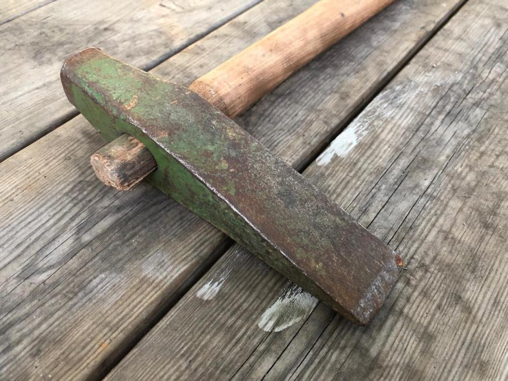

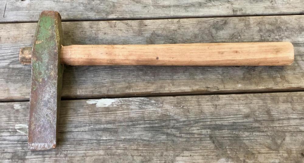

SmedjaSlitvarg Posted August 25, 2019 Share Posted August 25, 2019 I have this handled chisel, and as the title says I'm unsure if it's a hot cut or some sort of masonry chisel? Or perhaps even a woodworking item? Quote Link to comment Share on other sites More sharing options...
SLAG Posted August 25, 2019 Share Posted August 25, 2019 Mr. sm - sl, Let me hazard a guess. Your tool looks like a "mill bill". They were tools in the nineteenth century, (and earlier) that were used for dressing mill stones. (that ground grain). SLAG. Quote Link to comment Share on other sites More sharing options...
pnut Posted August 25, 2019 Share Posted August 25, 2019 There's a tool similar to that for cutting RR track cold. There was recently a picture posted in the it followed me home thread with a tape measure next to it. Your tool appears to be about two inches shorter but You can compare it to that picture and see what you think. Pnut Quote Link to comment Share on other sites More sharing options...
Chris C Posted August 25, 2019 Share Posted August 25, 2019 Wood Working Tool???? Definitely not. Only thing about it connected to wood working is the handle. Quote Link to comment Share on other sites More sharing options...
SLAG Posted August 25, 2019 Share Posted August 25, 2019 Mr. Pnut. Good guess. I think that you are right. Check this tool out at, https://www.aldonco.com/store/p/356-Track-Chisel.aspx SLAG. Quote Link to comment Share on other sites More sharing options...

SmedjaSlitvarg Posted August 26, 2019 Author Share Posted August 26, 2019 On 8/25/2019 at 6:22 PM, SLAG said: Mr. sm - sl, Let me hazard a guess. Your tool looks like a "mill bill". They were tools in the nineteenth century, (and earlier) that were used for dressing mill stones. (that ground grain). SLAG. Good guess, the only thing is that I find few examples that are handled in this way, and also all of them seem to have the edge across the handle orientation and not in the same line as this one has. On 8/25/2019 at 6:38 PM, pnut said: There's a tool similar to that for cutting RR track cold. There was recently a picture posted in the it followed me home thread with a tape measure next to it. Your tool appears to be about two inches shorter but You can compare it to that picture and see what you think. Pnut Thanks, I would say you solved it! 20 hours ago, SLAG said: Mr. Pnut. Good guess. I think that you are right. Check this tool out at, https://www.aldonco.com/store/p/356-Track-Chisel.aspx SLAG. This makes me think that pnuts idea is right, that looks very similar. I can't imagine cutting a piece of track with it though, must be hard work. Quote Link to comment Share on other sites More sharing options...
SLAG Posted August 26, 2019 Share Posted August 26, 2019 Mr. SM-SL. I remember that somewhere on this site is a description of quick train track cutting, where they scored the top portion of the rain. The score was transverse to the length of the rail. Once scored a heavy weight was dropped close by the score line. This was said to cleanly shear the rail at the score line, into two pieces. The search function on this site is trashy. So, I suggest that you use a search engine, (like google), with a search phrase, plus I forge iron for your search. Good luck with your search, SLAG. Quote Link to comment Share on other sites More sharing options...
