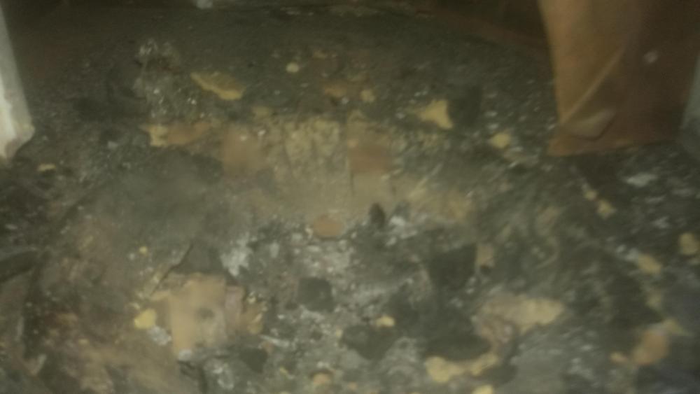

A sideblast fire pot
After a year using a JABOD forge (using charcoal), I decided to solidify make a steel fire pot. I was tired of having to reform the sides because they'd crumble.

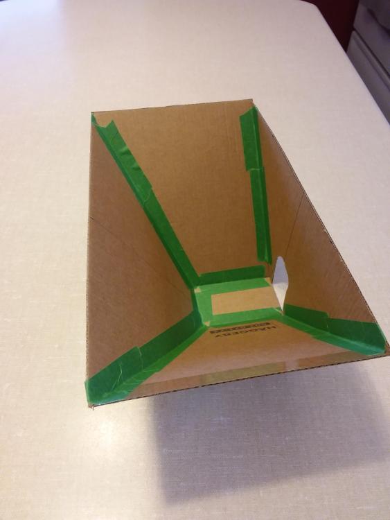

So, inspired by the fire pot that Charles R. Stevens showed us in a different topic, I made my own.

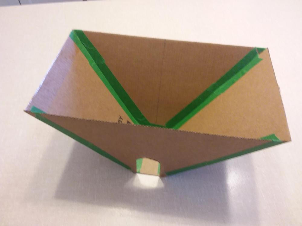

I work mostly on small items (hooks, leaves, etc.), so I wanted a shape that would conserve fuel as much as possible. This is why I added a slope on the wall opposite the tuyere. A slightly more complex shape but the bottom is only 2" by 3", while the top is 5" by 10". Total height is 6".
First I made a cardboard mockup to be sure my plan worked:

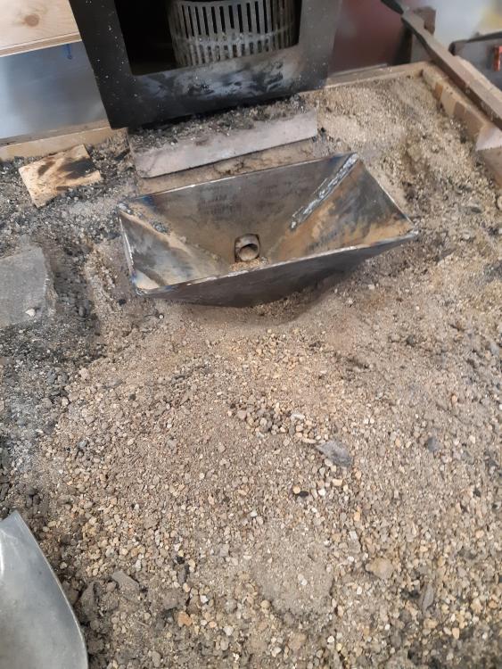

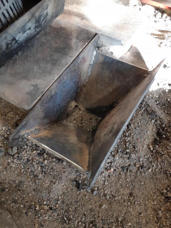

Everything looked good, so I proceeded with steel. I used pieces from a wood stove I took apart last year. The plates are 3/16" thick. Should be thick enough to last me a good while, considering that I spend less than 10 hours a week.

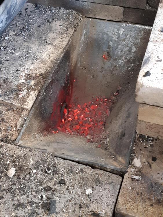

Overall, it took me about 3 hours to cut the pieces, fit and weld them together. I immediately moved it into place in my existing forge.
I only had time for a quick test burn.
Worked well, although the sides are higher than what I was using by about an inch. It still took less charcoal to fill than the JABOD. Even better, it was much faster and easier to clean up.
I should be able to do more complete testing tomorrow and deteemine whether I need to shorten it a bit. Once that is determined, I may add a rim to finish it.

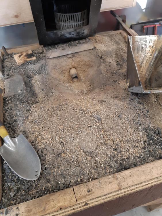

Full testing performed earlier today, and as I suspected the pot is a little too deep. I needed to either pile up more charcoal and pump more air than usual, or angle my steel down.
This will be easy to fix, by simply shortening the side of the pot. I will be doing that tomorrow.
Made the adjustment to my fire pot, lowering the short sides by about 1". I kept the long sides higher, as this will help keep the charcoal contained.
I tested it again and it's now at a good height, with the steel sitting right at the top of the fireball.
Last step will be to weld a flange around the pot. This will make it easier to push back the hot coals into the pot.

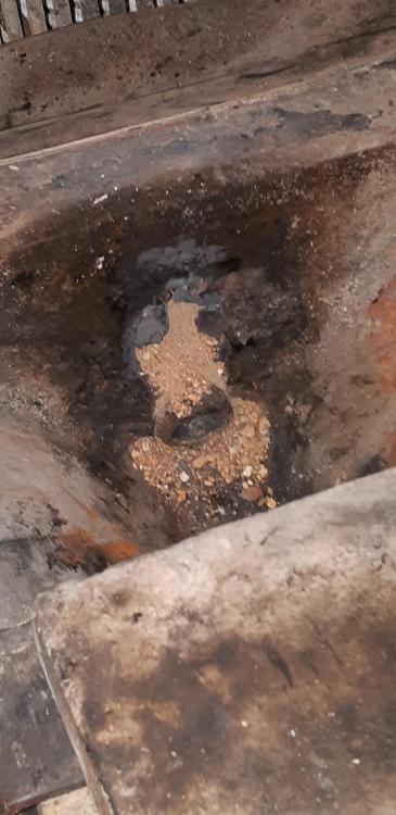

Now a year later, and this morning I had to patch my fire pot. As expected a part of it wore out (or burned through). I estimate usage over the last year to be about 100 hours.
Since the damage was localized right above the tuyere, I repaired it by adding a thick piece of steel where the hole was. Almost 1/2" thick (cut from a rail tie plate), compared to 1/8" for the original plate. Took about 30 mimutes to cut and weld in place. That should last a while longer.

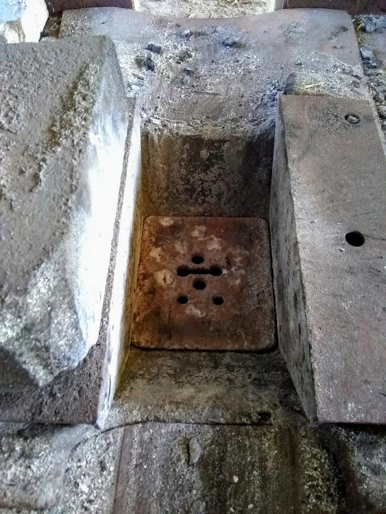

Here's what I came up with. It's bottom blast using an inherited fire pot. I made the grate to raise the fire and used angle iron to form the trench. It took some experimenting to get the air flow right. I can go all day on less than five gallons of charcoal and still have the convenience of the ash dump. I was daydreaming and burned some half inch round in no time.

Well how you guys manage to find correct depth for your firepots  for longer stocks, or you need to forge lets say 2 foot stock at midle.  I have to place stock over fire then place more charcoal on it i feel like iam wasting fuel that way and far awaz from sweet spot.
If you use a bottom blast fire pot you're stuck with what you have unless you go to lengths to make it so you can adjust the depth.
I usually use a bottom blast "duck's nest" forge rather than a fire pot. The duck's nest just a shallow less than 50mm. depression in the rammed soil bed in my rivet forge. The larger one I no longer use was more elaborate but didn't work better.
A side blast works really well across a shallow trench. Guys  keep making them deeper and deeper and having ever more trouble getting them to work.
If you use a shallow depression or trench and need a deeper fire put a fire brick on each side and it's 50-60 mm deeper, stand the bricks on edge and it's 100-160mm deeper. Long stock passes through the trench between the firebricks. If it's too low in the fire put something under the stock and raise it up. You can make any shape, size or depth fire "pot" you need with firebricks around the duck's nest.
I've been burning coal and occasionally charcoal, even wood this way for I don't know how long.
I usually burn propane but there are things you just can't do in a propane forge, say make a tea cup size fire for delicate work.

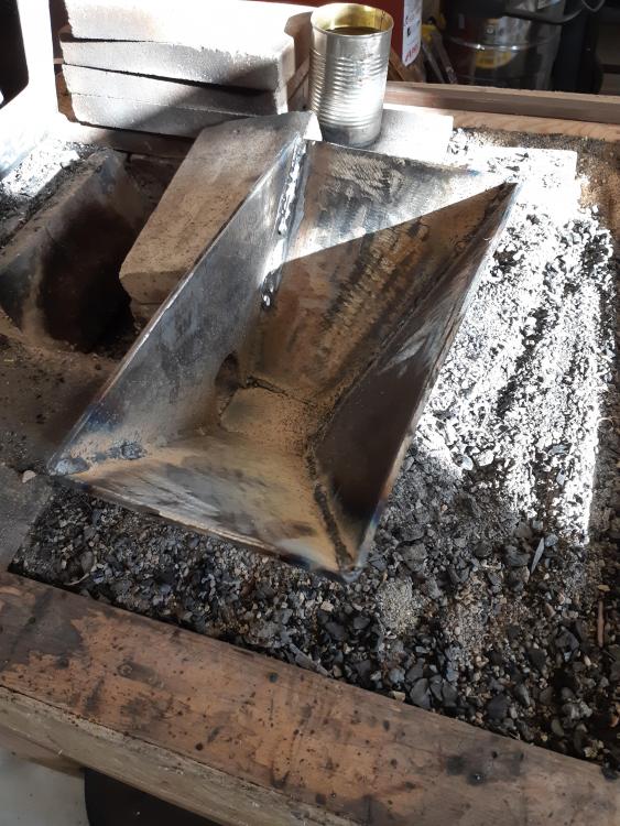

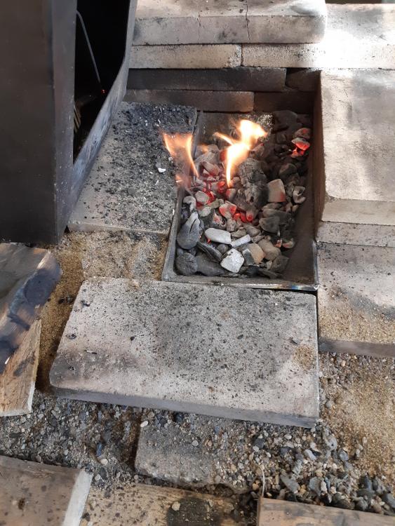

I use bricks on two sides of my firepot to contain my charcoal when I need to pile more on, as you can see on the following picture. For longer stock that I need to heat in the middle, I make a crack between firebricks on the far side so that the stock can pass through. When it is narrow enough, the coal doesn't spill anywhere. (I can take another picture later today showing the fire bricks on the far side if you want.)
If I had to do this often or with much longer stock, I would probably use a larger forge table, with more surface area. This would prevent coals from spilling too far and I could then rake them right back into the fire. Essentially it would be a trench between added fire bricks, with the fire in the middle.
But essentially yes, I am only heating up about 6-8 inches of steel at a time with my current setup. I could probably manage at least twice that long with a slightly modified configuraiton. For longer, I would need a different forge and tuyere.

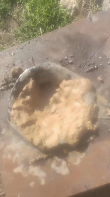

Before (one with clay) and after resize.
I made it shalower now.

I noticed bellows or airmatress blower dont do it when there is slight depression in firpot, you can clearly se how it got contained in one place.

I don't have trouble with fuel blowing away, unless I am running low on fuel in the forge. When it happens, I just add a bit more charcoal (or a small piece of scrap wood) on top of the stock.
Note that I have angled the tuyere down a little bit (about 5 degrees). That may be helping. So is the fact that I am using box bellows. Charcoal likes a gentle breeze.
