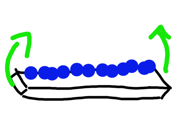

I'm just making sure I understand this
You lay the bar(black) down flat on the anvil and use med light blows on one side(blue), causing the bar to curve(green)?

No, I don't think you understand Shabumi and your drawing is just confusing. This is a FLAT ring, NOT a hoop like going around a barrel or wagon tire.

Let's see if I can make this a little more clear for you. Draw parallel lines a 2" apart on your anvil. Visualize this being 1/8" x 2" strap stock laying flat on your anvil. Without lifting it strike blows one side of the center, that will make it thinner but wider that side of the centerline. By making the stock wider on one side of the centerline the steel will bend AWAY from the side struck. It won't want to stay flat but it can flattened and be trued up easily.
Does that make sense? If not, give it a try on some strap stock, strike one side of center and watch what happens.
Yes that's makes it more clear. And I don't know why I thought it would bend towards the blows, as soon as you said it I had one of those DUH moments and slapped my head. Thank you for the clarification

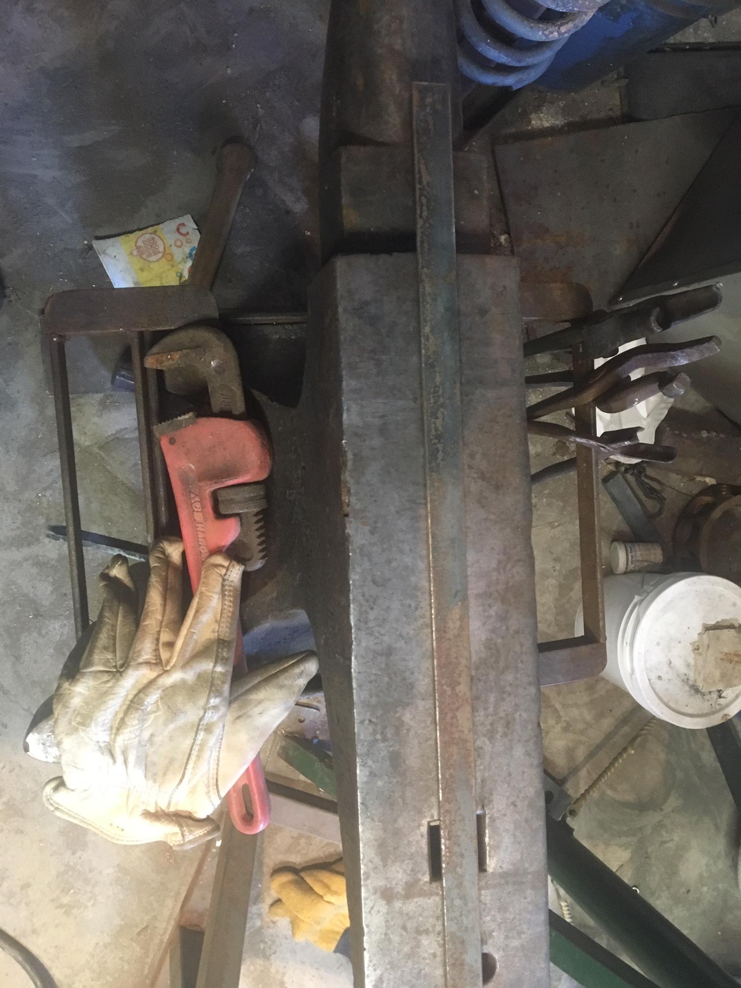

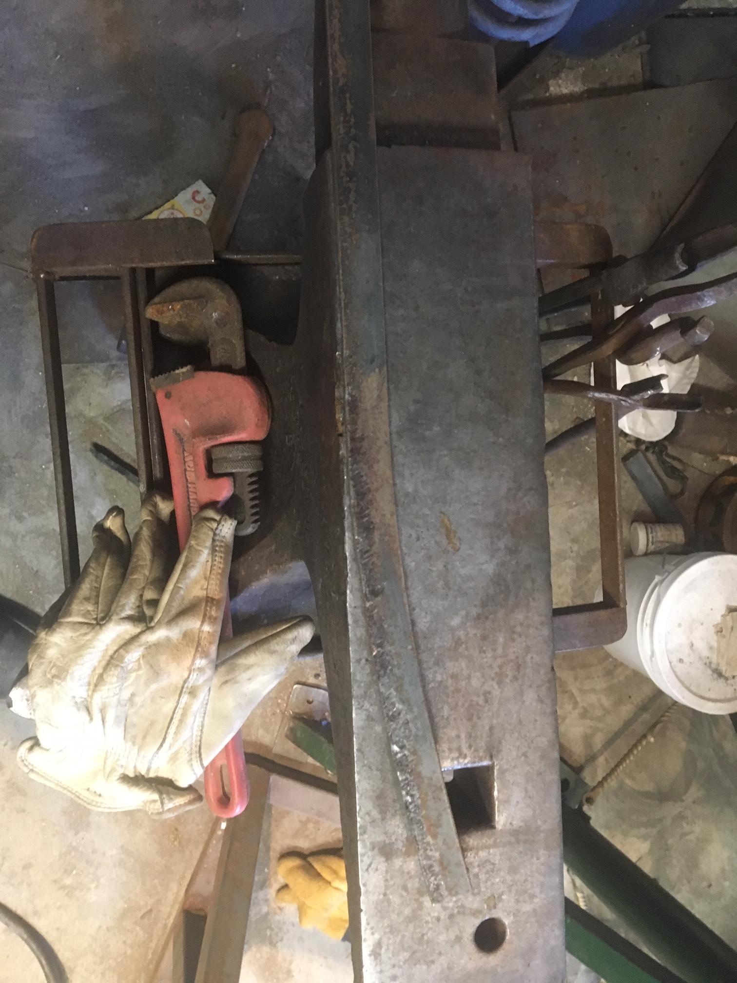

I'd already gone to the shop and did a quick demo of the method for forging a flat ring I was talking about. The beginning stock is 1/8" x 3/4" and I spent maybe 5-6 minutes. Where the bend is sharper is where I struck closer to a full half way, the more shallow is where I struck mostly edge.
I could;t believe how out of practice I am, please disregard the evidence of hammer edge marks. :unsure:

I guess frosty was right, my drawing was confusing. Funny, it made perfect sense to me when I drew it. But hearing how others perceive it, I can see how it would confuse. I hadn't meant that the bar would bend up, instead I thought it would bend towards the blows on the edge, along the flat of the bar. I did, however, have a brain lapse and forgot the basic principle that metal moves away from the hammer, not towards it. Too busy looking at the forest, I forgot to look at the trees, or the ground it's growing in.
