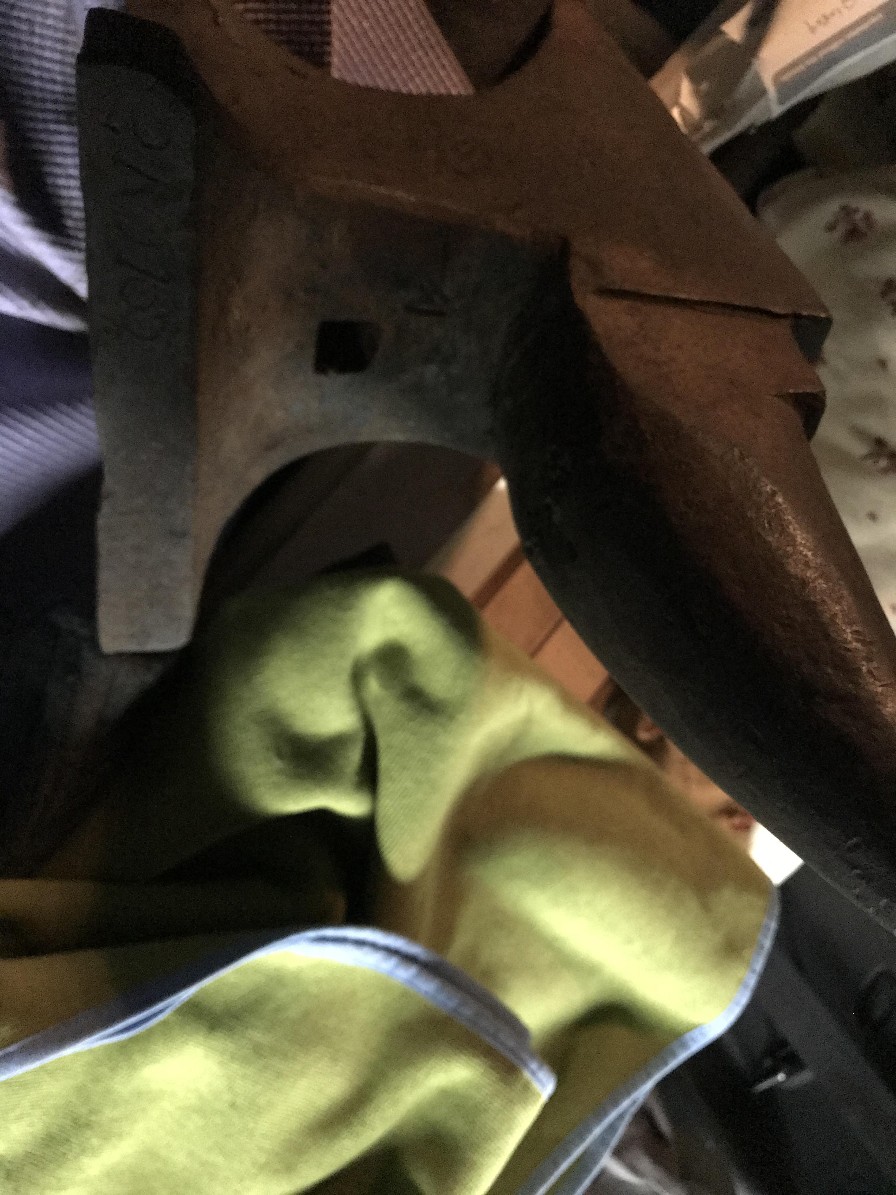

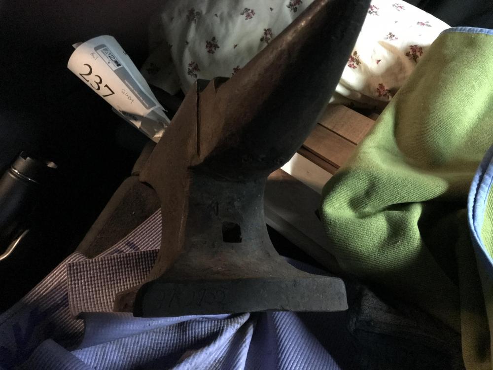

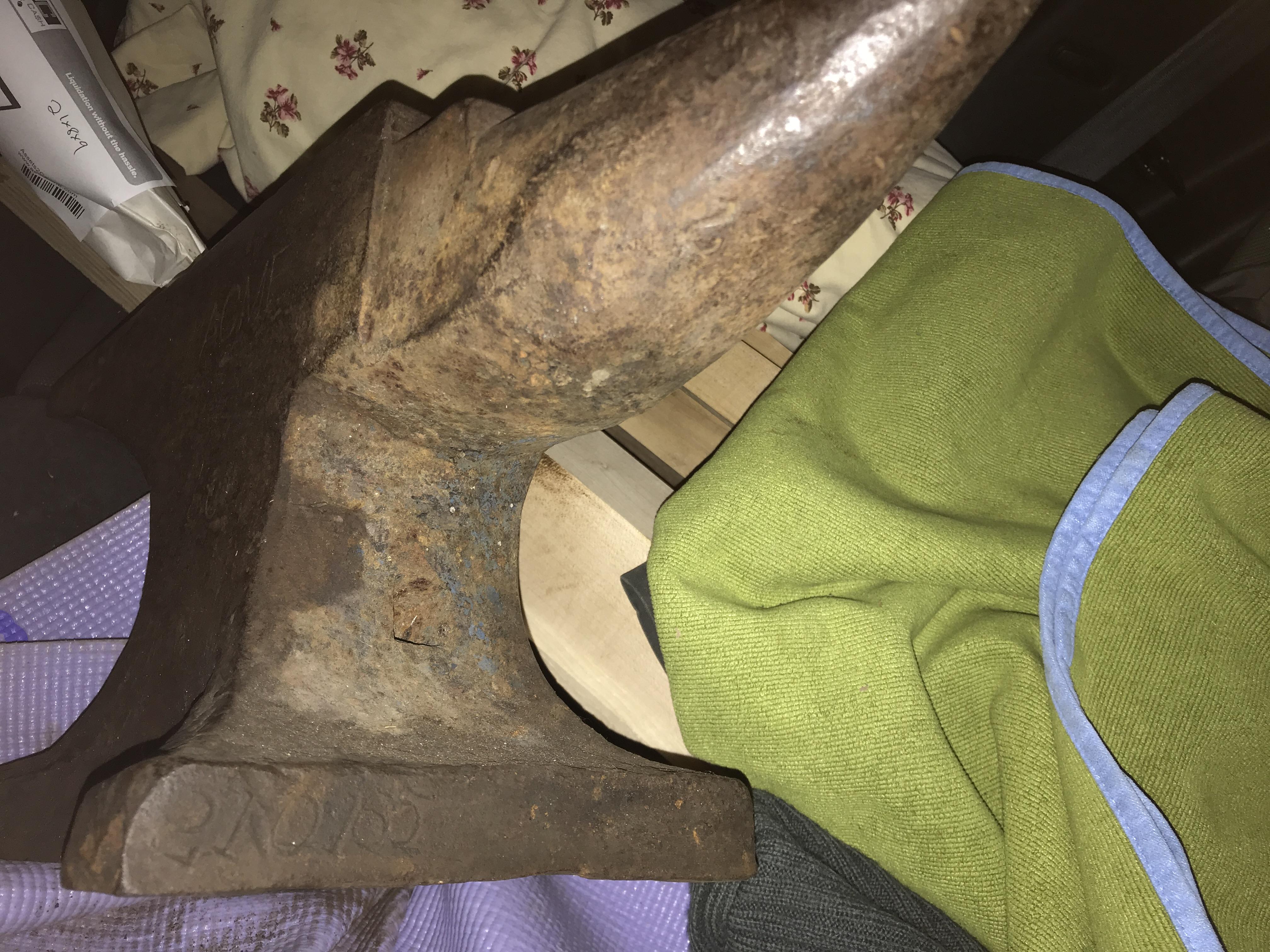

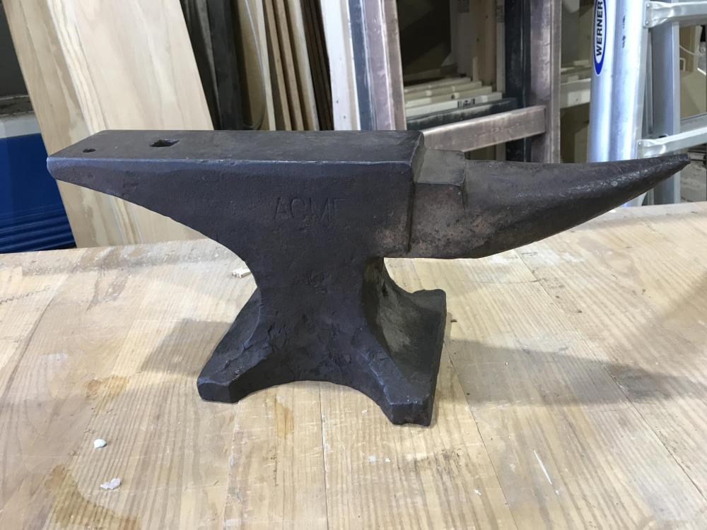

Would someone please help me learn about this anvil? Thank you in advance!

Sure is shaped like a Hay Budden though. It even looks like it has a waist weld.
If I'm not mistaken, I believe both Trenton and Hay Budden made anvils with the Acme stamp. That one looks Very much like a Hay Budden to me.
A large number of American anvils have waist welds; not very specific...

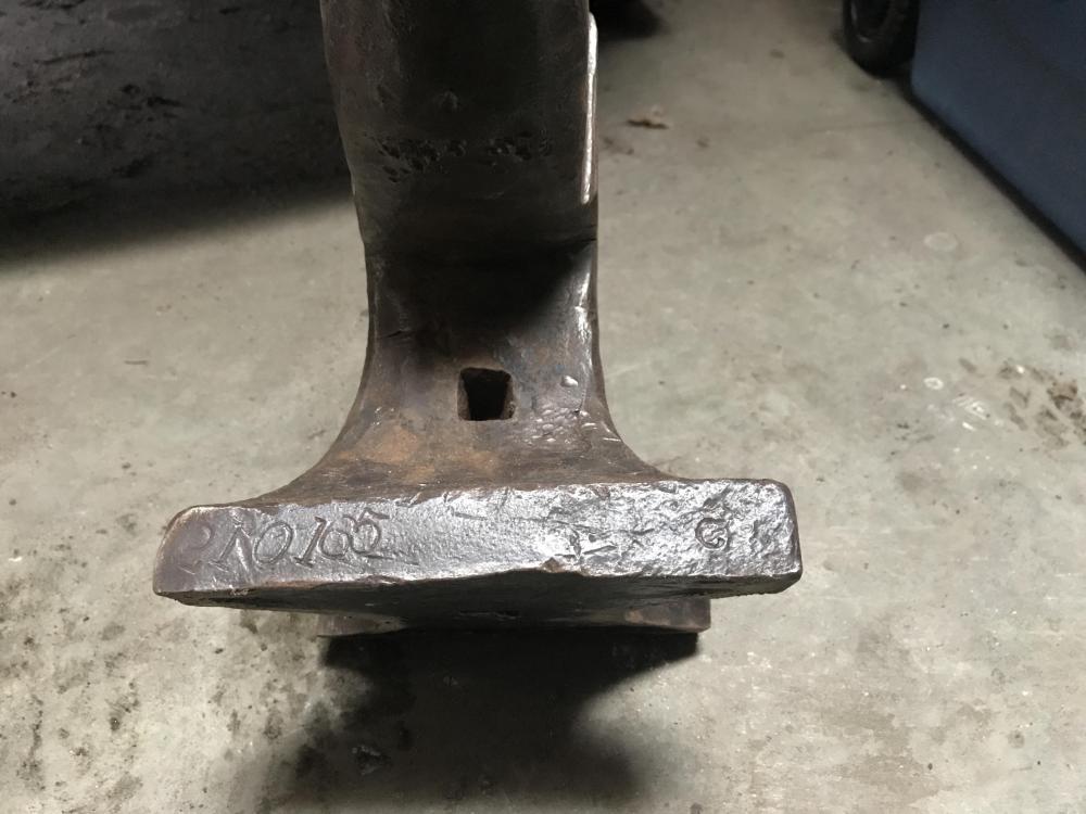

Can we have a photo of the bottom?  That should clearly differentiate between Trenton and Hay Budden!
Many large retailers would contract out orders for things like anvils and have them stamped with their mark---ACME is a Sears Roebuck brand and it's known that SR used several different suppliers over the years.

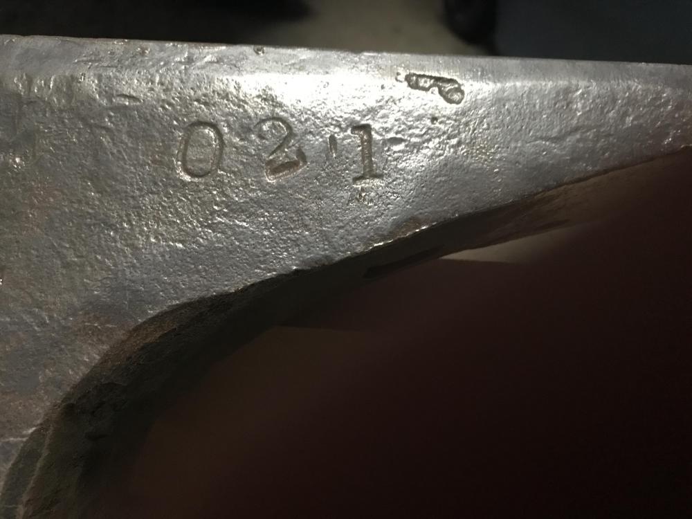

Most likely the serial number and the weight on the front of the foot under the horn.  What does it weigh?
Wow, you guys rock! It weighs 84.5 lbs. Tpowers: I think you might be onto something with your bottom inquiry. So, the bottom surface is fairly flat with a slight depression that measures app.  0.375” deep in the center. I’ll snap a photo later and post it. In the mean time, the angled photos above actually show the entire bottom surface, but the shadowing definitely makes it difficult to see. Regardless, thanks all for the help, and I’ll be back in touch!
HB's are known for their "hourglass" indentation where the outer edge of the base extends slightly more than the center---this can vary from very pronounced to almost worn off.  Trenton's in their later years used a "caplet" indentation---quite pronounced; but sometimes A&H anvil will have it too. (IIRC Postman speculated that they would share bases between them if needed.)
I'm on the HB side.
Thank you Black Frog. If I may ask, how are you certain?
Also, I will post a photo of the base surface tomorrow.
Additionally, what sort of info might the serial number reveal?
General shape, serial number number style, serial number location, upper numbers on near heel on opposite side,  the style of the ACME stamp.
No question.
