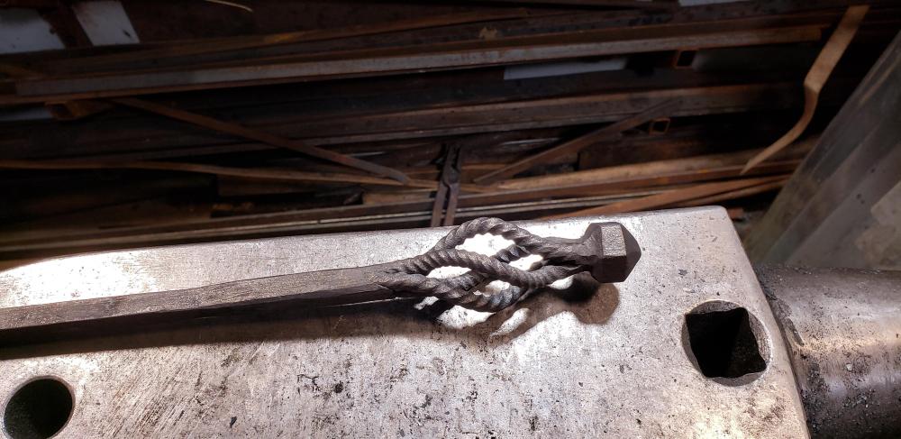

How to forge Fancy Blacksmith Basket Handle (4 rod twist). #1
This latest video has a production glitch..  I am posting it because it's has good information other than the non sync issue which is in process with the software company..
I really don't want to edit it again in the other software as I'm burnt out..  I can do about 40hrs on the edit than I start going crazy and want to run away..
****  this video was in response to a comment from a fellow smith about how plain and not really graceful a 4 rod handle is vs a higher count handle..   While I for the most part agree there are ways to make a lower count handle as graceful and interesting..
This is an example I forged to show him..
This video is more about the handle itself and how it's done..  The  end finial is not really covered as this technique was covered in the "How to Forge bolts"video..
Just amazing that we learn new tricks for doing things with every one of your videos. Thirty four or so years in the forge and I have never seen using a pair of scrolling tongs in the hardy hole to hold stock when making twists. It's one of those head slap moments and why didn't I think of that.:)
Thanks..
LOL.. More than likely you won't see it anywhere else..  Well up till now..    If you use it and someone asks please share where you found the info.. I keep making the videos hoping it will help or make a difference for someone..
I use the scroll tongs because they are handy in the trailer.. I have a different pair in storage.. Might make the next video how to on the subject..
Ms. Sheila and I just finished watching - one more vote of appreciation for your elegant twisting vise. Yes, it took me a bit to get around the audio mismatch, as my vicarious muscle twitches were not syncing. We enjoyed hearing you "mumble" - Sheila said, "If that was mumbling, I loved it." I think that if you were mic'd up, and put no extra effort into the narration, in effect, not attempt to make it another tedious production value, it would be great. You don't want to be "spinning so many plates" as to take all of the enjoyment out of the project! Much appreciation for all of your time and effort!!
As to the finial - I thought that it was very easy to follow your process as illustrated.

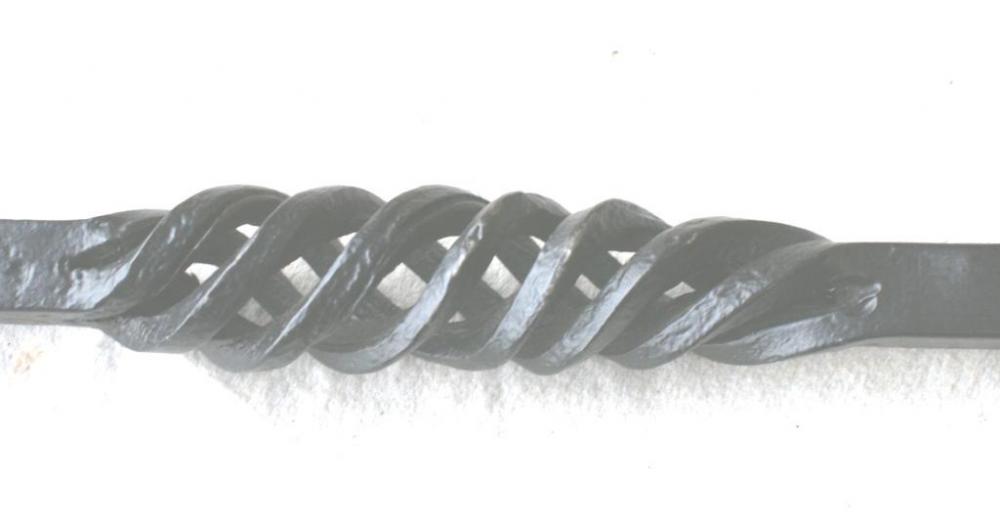

From JLPS previous item ;
There is a point with 4 rod handles though that can fail to be graceful or pleasant to look at..  This was what we were discussing.. Of course there was much more to the conversation so was paraphrased.. "
I think this pic of the experimental stages help to illustrate its not just the 4 rod handles that edict applies to.
To follow on the   "If it looks right it is right" this is a pic of the progress to get on to produce something I was comfortable with, your opinion may be different.
My preference is ths lower one, Third attempt.
369330572_Doubletwistcagefirstattemptstogetittolookandfeelright..JPG.74708628c4f66d140d4ee838ec7823b4.JPG
My preference also is for the 3rd attempt..
I have mentioned before about the S effect..  The  2 earlier attempts show this S effect where the coils are pushed up onto themselves thus creating more of an S look..
The 3rd attempt creates a flow that is much more graceful to the eye..
The flat twists though interesting from a smithing stand point for myself do not hold that eye catching look..  It's just lacking..  I keep thinking how to bring that alive and keep it traditional tooling only..
There is a reason for that, the first two attempts had excessive material on the inner core although from the same diameter material, This caused the S effect.
By reducing the number of rods in the inner section, when the outer section is placed and twisted to form the cage, the inner section does not bind up and cause the S effect
If you look carefully you will see five rods internally, six rods externally. Which can cause problems other problems. on the plus side,  no mandrels were needed or used in the production of this item
But it's all good fun
Enjoy
Sorry..  You were not in on the S effect and was referencing a different thread..       I should have elaborated more but forget which information is discussed where..
We again were talking about the S effect and how this S effect is controlled by how  many twists are first used and then the amount of pressure applied to open the basket in a traditionally done basket..  To many twists or to much pressure on opening will create a section that looks more like an S than flowing..
..      In your example this can also happen if the inner and outer baskets can't move together to get the same length ratio..    IE the inner is longer so it gets pushed together (can't expand the same as the outer so to much pressure)  or vicea versa..
 On a lot of the earlier handles I had done I never noticed this S effect but knew there was something about the twist which I did not like..
Wasn't till I came back to smithing that I noticed this as being the culprit..  IE  (as applied to traditional baskets) to many twists and/or to much pressure applied when opening the basket.
I also think that the distribution of the heat is a major factor in any twisting being undertaken.
1861770525_16ElongatedCagetwistinsolidbar.thumb.jpg.a522dbfb54740dd680e3237a5a14a89c.jpg
On this old example the right hand end was slightly cooler than the left.
So many variables, tricky to tie them down, but all worthy of consideration.
