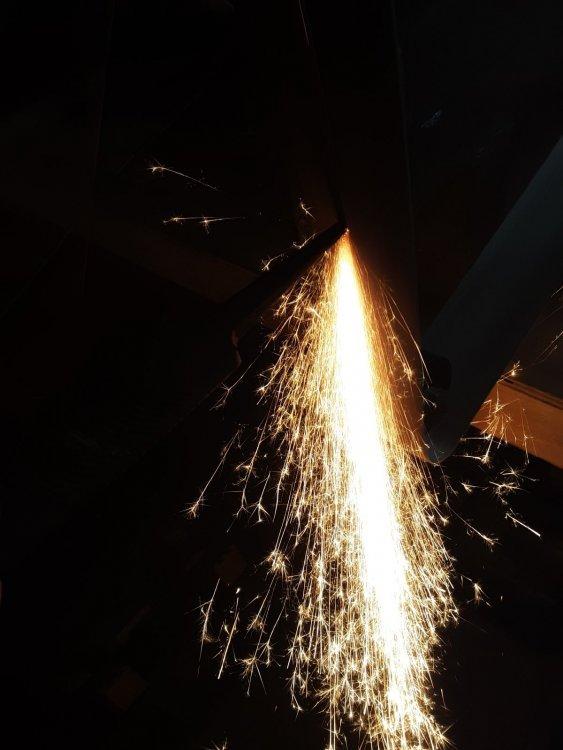

Nobby Posted March 11, 2019 Author Share Posted March 11, 2019 Hello again, still attempting to get to the bottom of my issues with attempting to harden coil spring steel so I thought I'd post an image of the spark test under the grinder. Any opinions as to whether this indicates a relatively high carbon content or not would be appreciated. cheers Nobby Quote Link to comment Share on other sites More sharing options...
Frosty Posted March 11, 2019 Share Posted March 11, 2019 That doesn't look high carbon to me, probably has an alloy to make it springy rather than much carbon. Spark test with the grinder before spending a bunch of time making strikers next time. The sparks shown aren't branching in general at all. You want a fireworks display of branching sparks. Try boot sale Hex wrenches, punches and chisels, they're usually reasonably high carbon but spark test before trying. You'll want to do a test coupon in oil before using water quench to be sure nothing goes wrong in use. If it's hard enough to spark with an oil quench it'll be safer from breaking in use. Frosty The Lucky. Quote Link to comment Share on other sites More sharing options...
ThomasPowers Posted March 11, 2019 Share Posted March 11, 2019 The best way to judge a spark test is to get a number of known samples and compare one to another till you get a pretty good match. Try a file, piece of automotive coil spring, some A-36, a piece of silver steel, etc. It's handy to build up a known steel collection and be able to get pretty close to the unknown piece. Quote Link to comment Share on other sites More sharing options...
Nobby Posted March 12, 2019 Author Share Posted March 12, 2019 Frosty/Thomas thanks for the replies. I was finding it difficult comparing the results of the spark test with illustrations. I'll definitely start a trial of different steels. Thanks for the suggestion. Nobby Quote Link to comment Share on other sites More sharing options...
Benona blacksmith Posted March 12, 2019 Share Posted March 12, 2019 Here is sparks from some 1095 I had laying around. This is what your looking for. Quote Link to comment Share on other sites More sharing options...
Nobby Posted March 12, 2019 Author Share Posted March 12, 2019 Benona thanks for that. It illustrates the difference quite dramatically. Still learning ! Quote Link to comment Share on other sites More sharing options...
