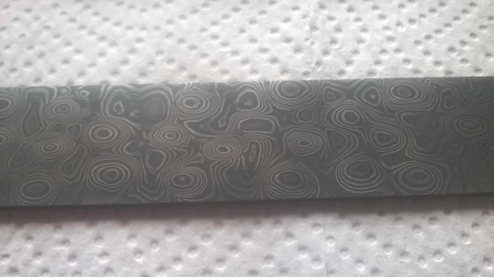

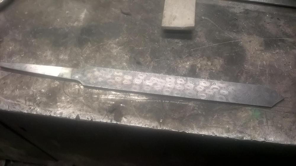

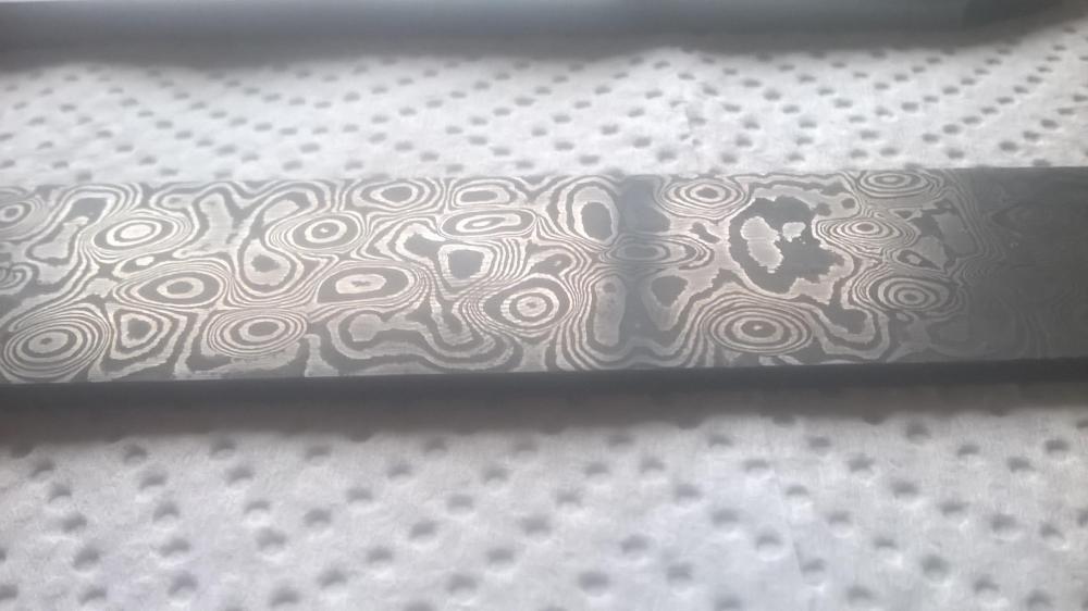

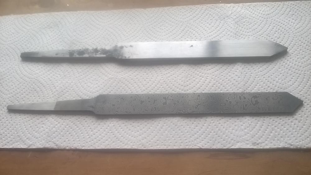

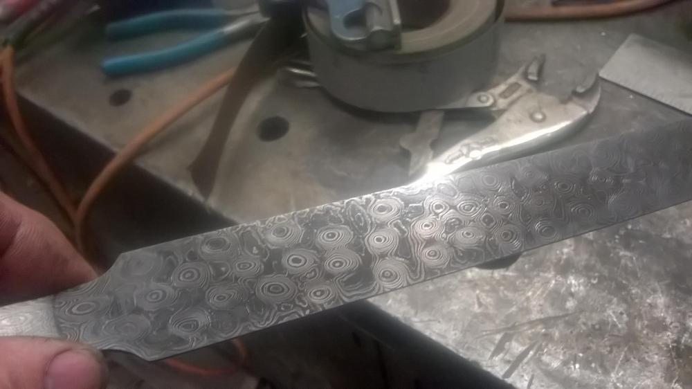

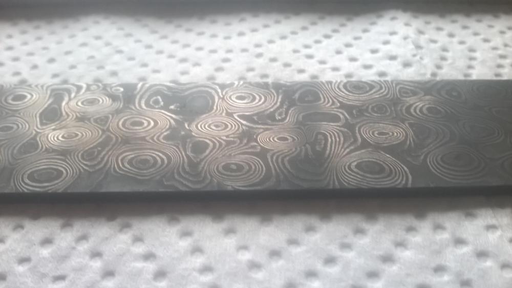

I made a set of Wood turning parting tools for my stepson yesterday they could of been finished better but they had to be finished last night. The plain one is made from 1080 crane rail track and is 6mm thick and the birds eye one is crane rail and band saw blade and is 3mm thick
