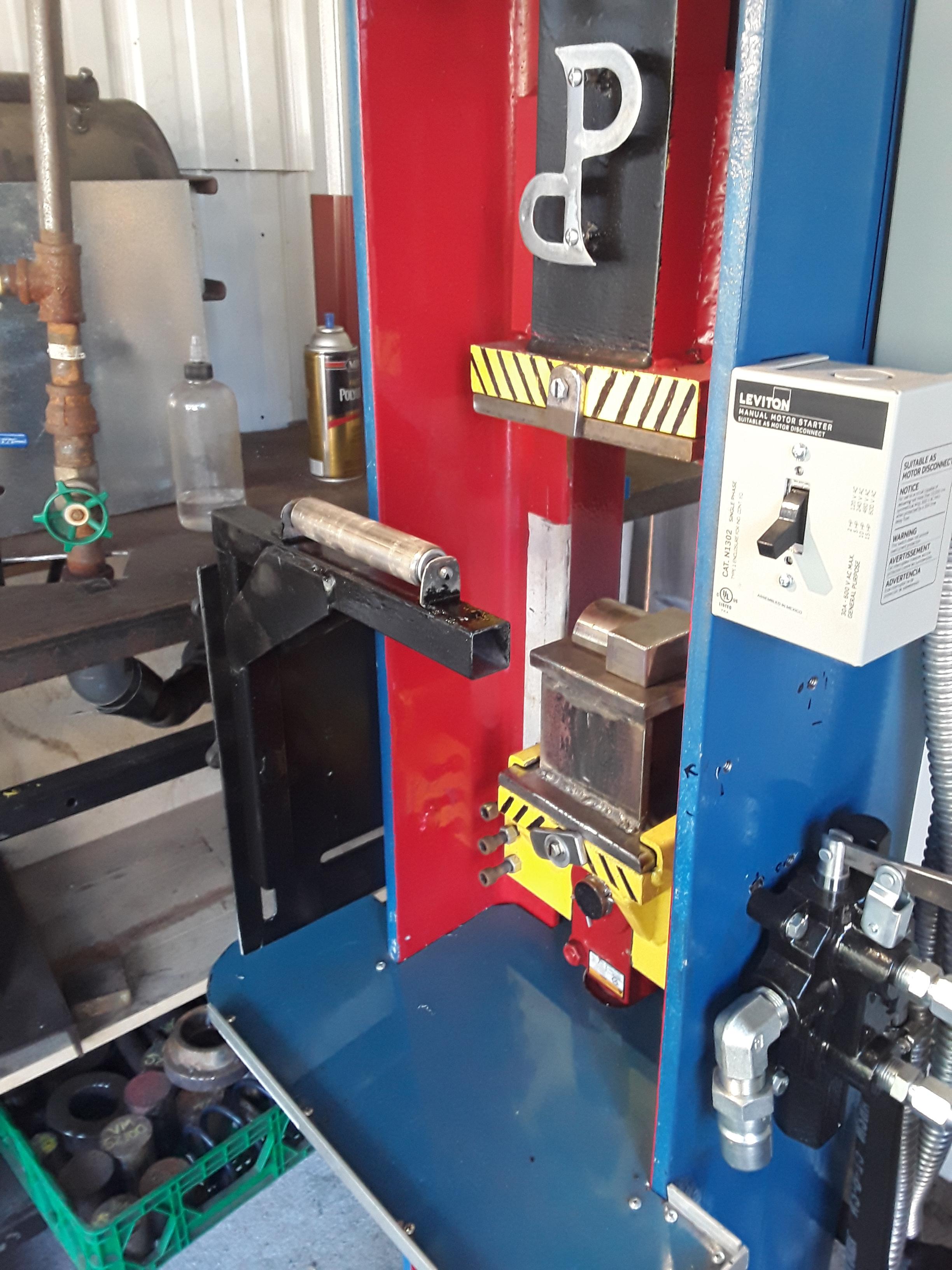

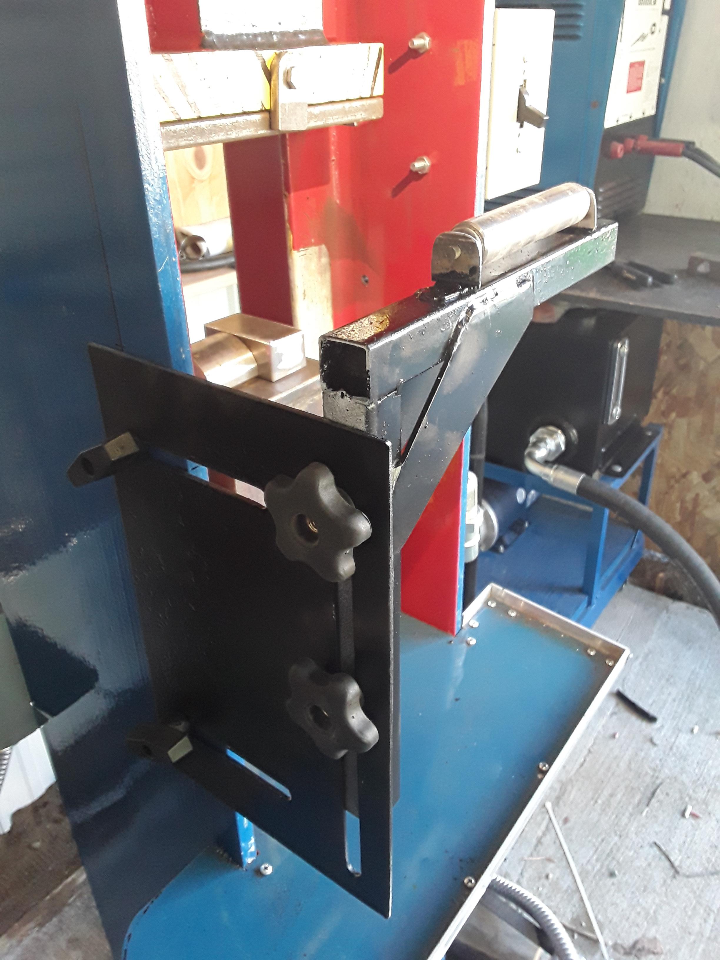

Little odds and ends, while I wait for my electrician.
Added a steady rest to help hold up the hot metal. It is fully  adjustable, in and out, up and down.

It is now official
Big THANK YOU to Frosty for the crap on my tidy forge wall
All funny things aside. The start up when off without a  hitch ( less 2 small fitting leaks, nothing a wrench didn't fix).
Very proud of this project.  It was way out of my wheelhouse when I  first decided to build. But with some deep research and a bit of hard work, it turned out as I had envisioned.
The pump is still set at factory spec.(1500 psi) I will leave it there until I get use to the press.

Thought about increasing the pump size, but would have only increased the second stage speed by less than a 1/4 " per second. Splitting hairs at that point.
Works good makes the same noises mine does they make life easier lol...
Bubba this is definitely a labor changer!
Played with it all day today. Going to take some time and practice to get a good feel for it. Managed to ruin a billet of Damascus I had started by hand a while back. Was all good until I tried folding it over, instead of cutting, grinding,cleaning, then welding. Lesson learned!

I love the die lifter! Looks a lot like mine.  Did you do this in order to have the room for a billet splitter?
Jaspool, yes and no. Yes for punching holes. Also helps to keep the ram shaft from being over extended. I think k it is better for the ram if there is 1/2 to 1/3 of the shaft still in the cylinder while working

I designed the press with an 8" throw, I built the press with 10" between the dies, so as to have room for a punch system in the future.
Many press owners have stated the it is better to not extend the shaft to full length. So I started building my dies on a platform to keep approximately 1/2 of the shaft buried in the cylinder. After building 6 different platforms, I realized that I am a true idiot! It's a wonder I designed and built this press.
I have just finished building a couple of platforms to accept, and quick change the dies. This method will save me 28" of welding bead, not to mention the added material and time.
You can research until the cows come home. But NOTHING compares to experience. After using my press for the past six weeks or so, I have realized there are going to be some major changes on the next build!
