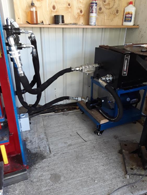

Got alot done this weekend. Built a mobile cart for the power pack.  The motor , and pump will mount below. Waiting on the mailman for my locking swivel casters.

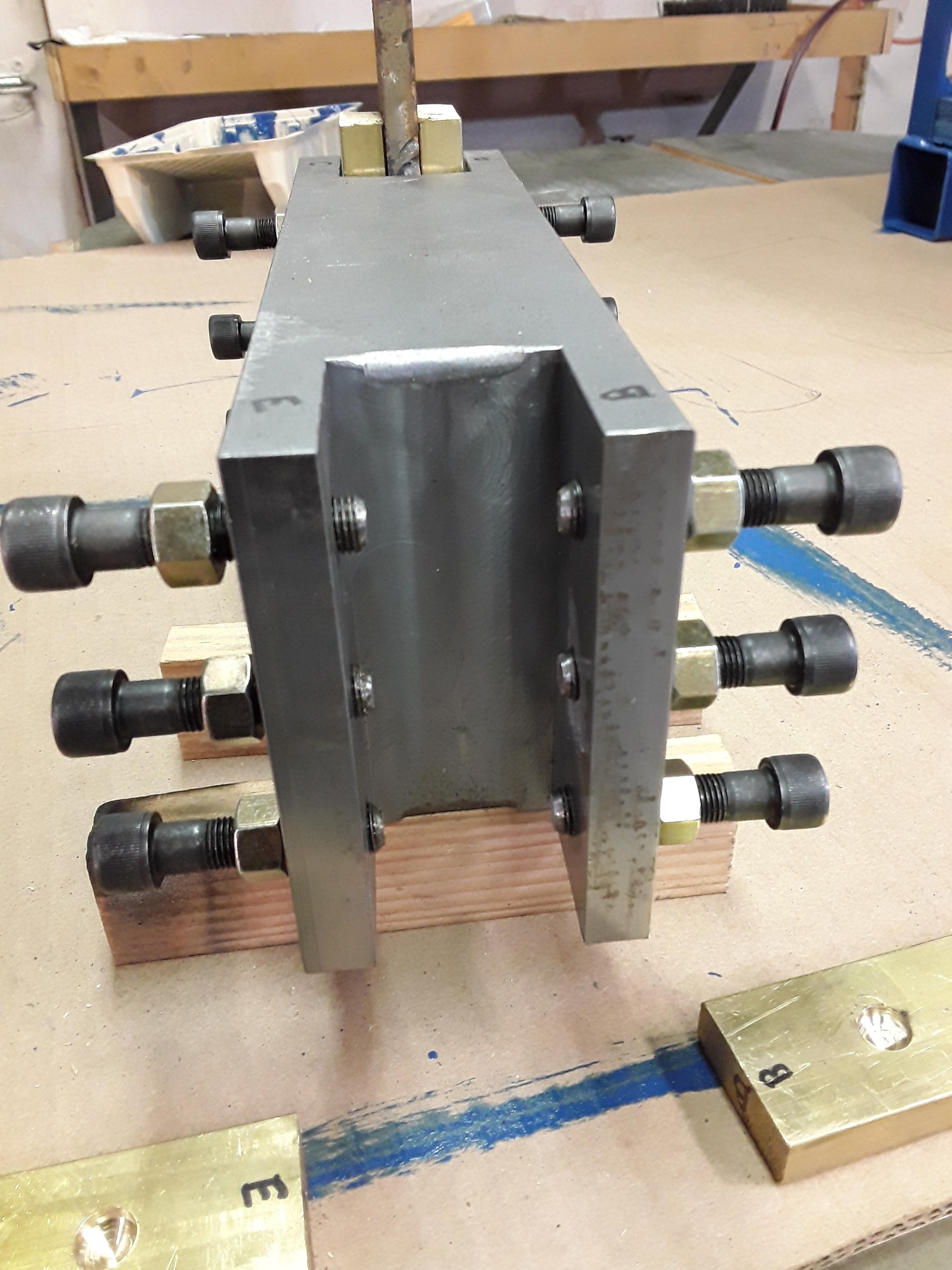

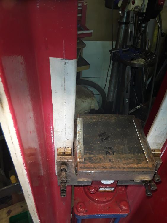

Was also able to work on the guide block. Wanted it adjustable,  and able to replace the brass when worn. 3/8" X 24 bolts with a jam nut. Wondering  if I should attach a spring to the brass, back to the block to keep the brass snug to the bolts. Or am I over thinking?

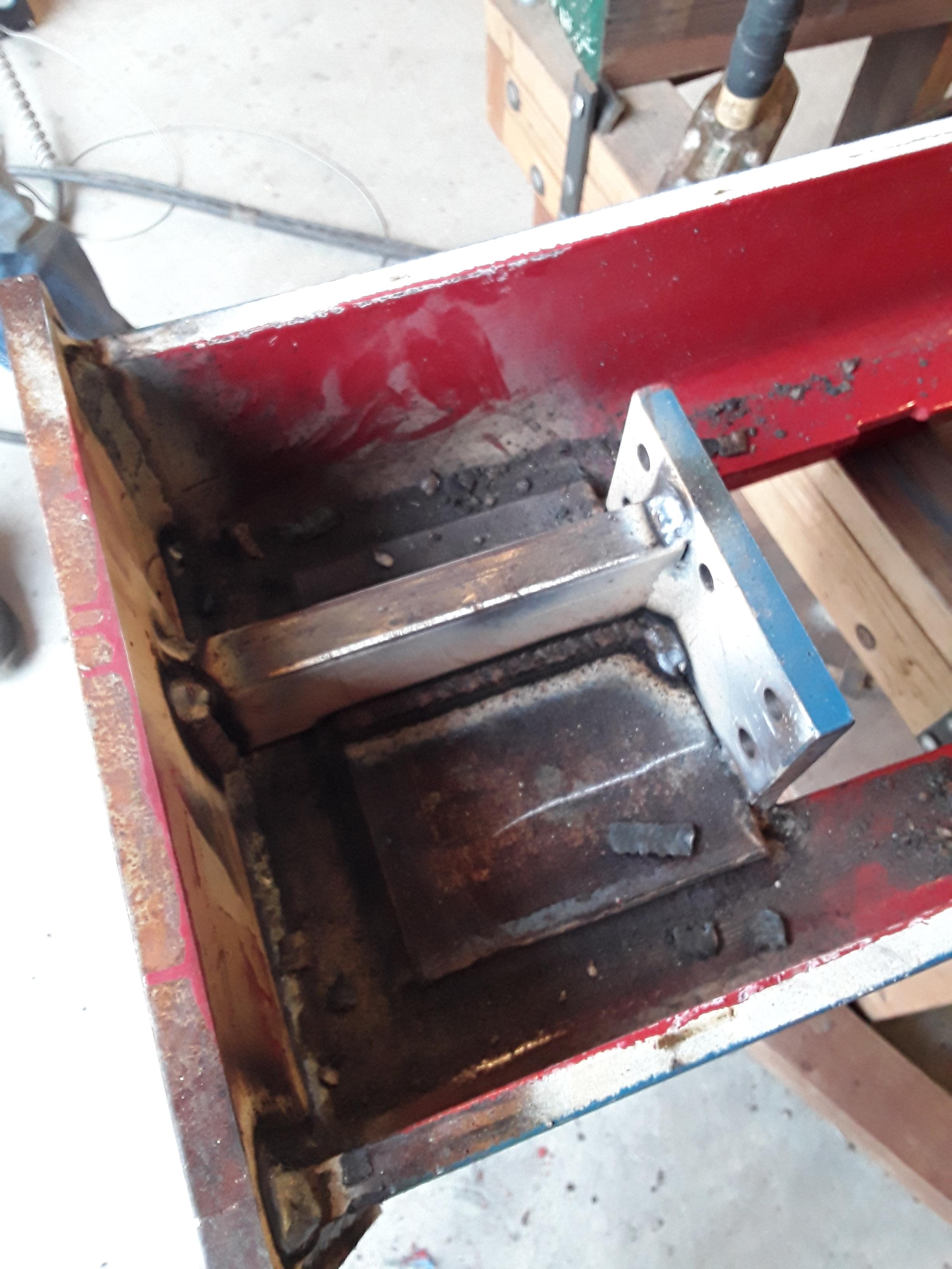

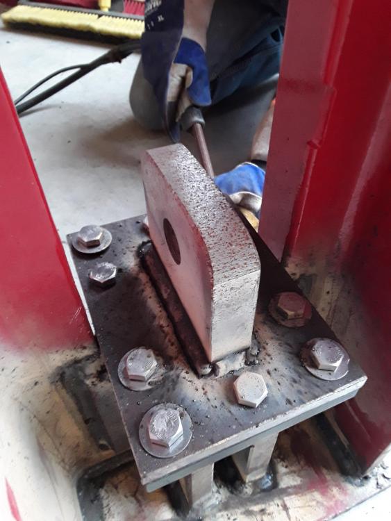

Spent most of the day at my welders shop. Got it all put together. Here are a few picks of the welds. Hope to get it from my truck, to my shop in the next couple  of days.  Then I can clean it up and get some paint on it were needed. Then it is off to the hydraulics,and electrics.
Had to build a cart to haul this press(less the ram) from my truck to the shop.

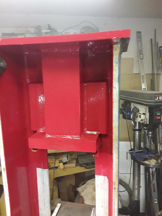

Once inside I assembled all the parts to be sure all fit well enough after all the welding has been finished.
So far so good.

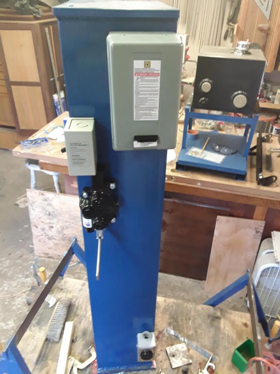

Question for those who are following, that are in the know.
I have a 4 way 3 position valve with no indents and will return to neutral when the handle  is released. Prince item # 2010. It is fitted with a center spring. This valve was recommended in Batson's book. He states that the valve will need to be balanced, to be used as a foot control. He doesn't go into detail on how or why it should be balanced. What does that mean? And how is it done?

Mounted up some controls today.
5 hp contactor, 30 amp switch, and receptacle. Also mounted the control valve with a reworked arm to fit a foot control.

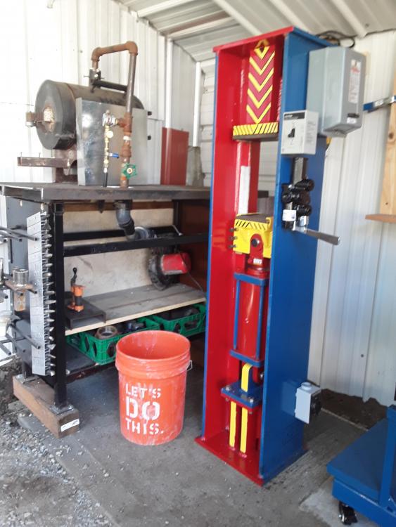

Got it out of the shop today, and semi-placed in the forge. Bucket is for size reference. This press is small compared to most
As long as it puts the squeeze on is what matters looks good.
Thanks bubba.
I agree. Size doesn't matter. "So they say". It's all about " the force". Lol
I way under estimated the cost of hydraulic fittings,hoses,and assembly labor! It is as much as what I payed for my 5" cylinder!
I was shocked to find out the cost of my hydraulic lines, fittings, and assembly.  It was near the same amount I payed for my 5" cylinder!
Nuthens cheap in this rackett lol i got lucky on the hoses and connections i knew a guy that knew a guy who had the connections lol and the hoses to get it done for a pretty good price.What was your overall price i'll give ya mine just pm me to compare ...

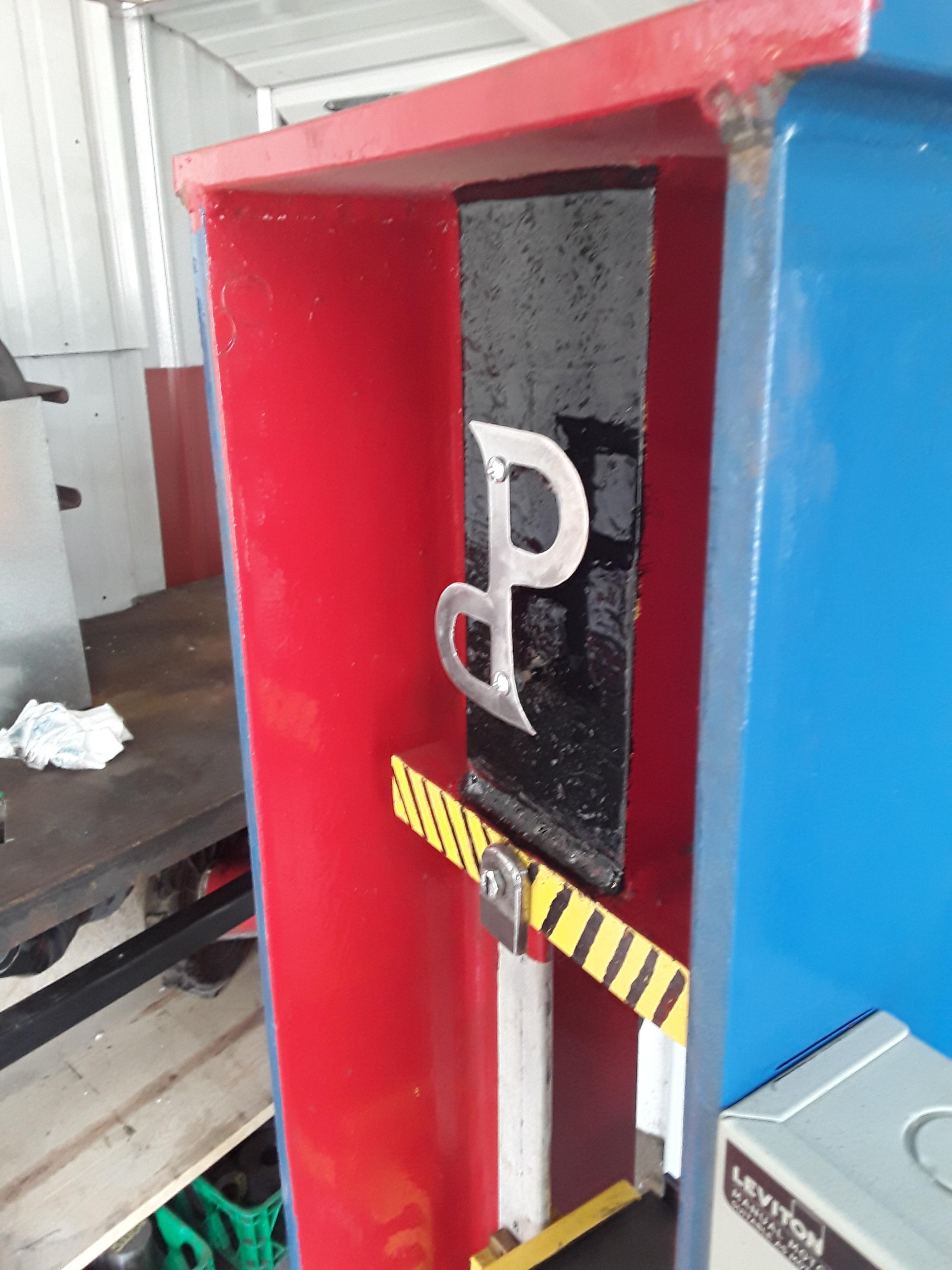

As if I haven't personalized this press enough already.
Personalize away Peppie, she's looking beautiful. At least you haven't given her a cutsy name.
Ty Frosty.
Going to name HIM "Popeye ". I found a vinyl sticker to use as a pattern to etch a steel plate. It shows his huge forearm.  Hope that's not to cutsy???

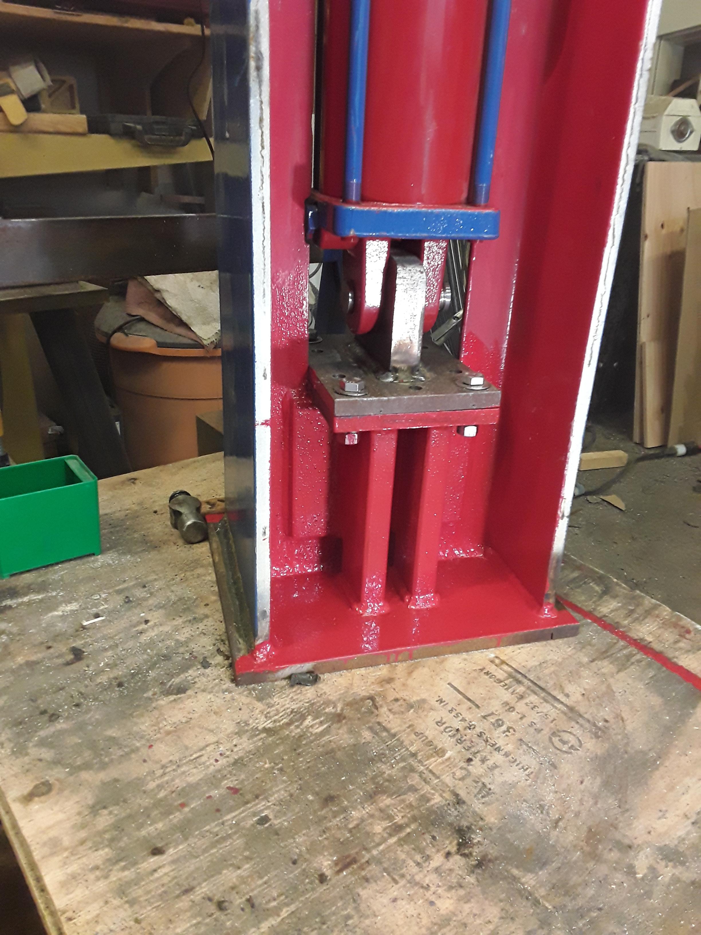

Looking good My only critique would be the ram sprear eye looks like its a close fit in the moving table and unless there is very little movement or tipping side ways you will either bend the ram spear or break the eye off the spear as the ram spear is not that big in dia. If i was making a press like this I would use a table with much longer guides and a spear bigger in dia, All you need to do with yours is give it a bit more clearance around the spear eye other than that its a well built press Cheers Beaver

There is less than a 1/16" movement from side to side on the ram table. The ram eye is inset to the ram guide block. I am confident that it will not bind.....but I have been wrong  in the past....once.

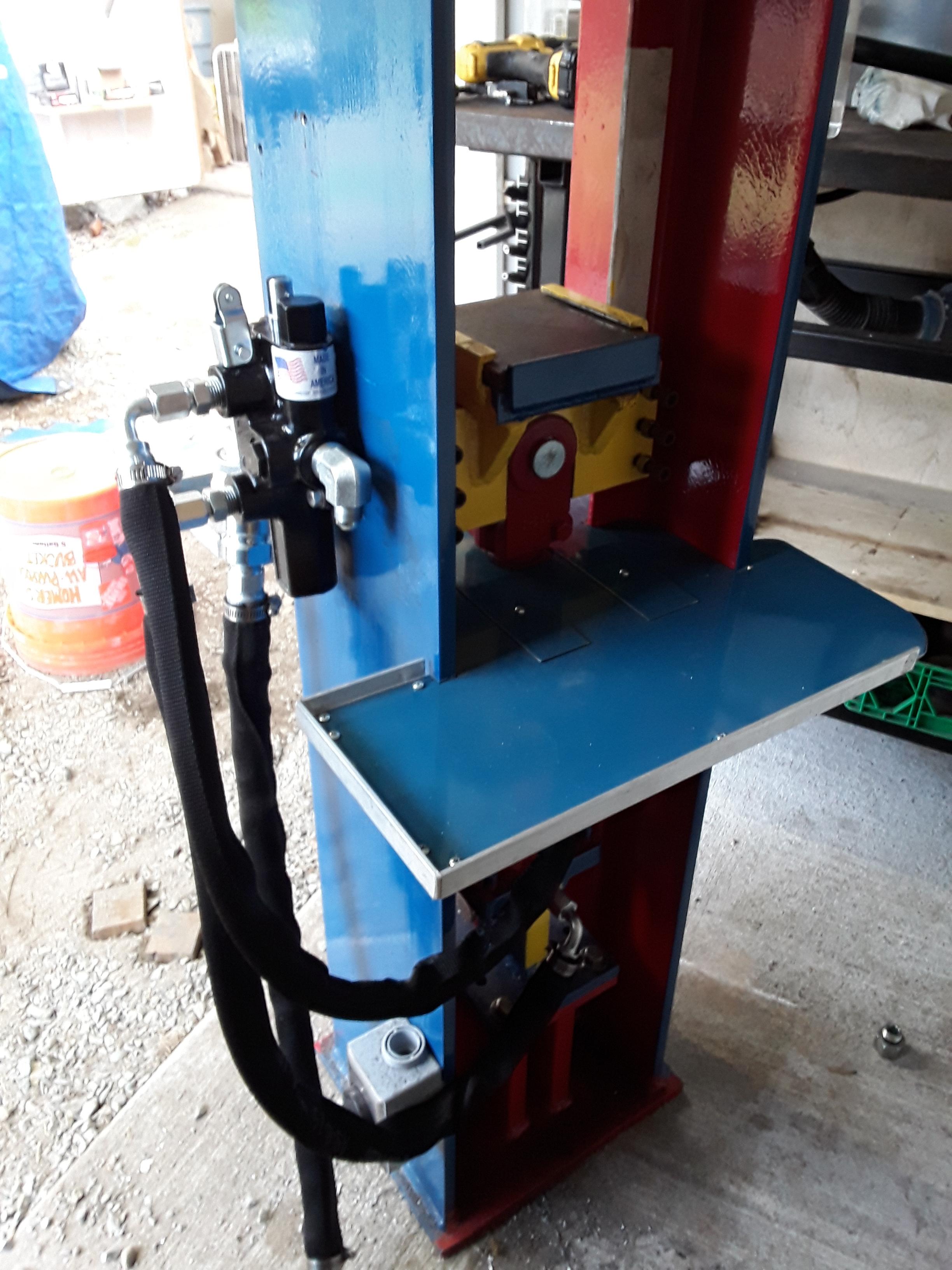

Got my lines connected.  Only took me 5 trips to the hose store.
Waiting on my parts to hook the pump to the motor.
Sparky will be here in a couple weeks to energize the press.

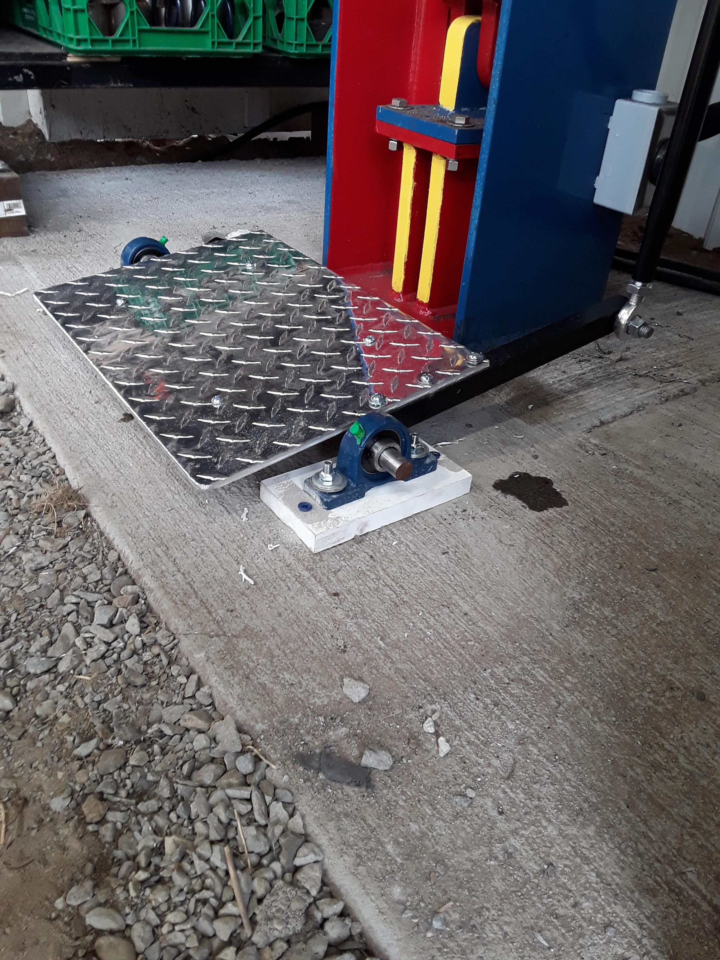

Got my foot control all fabricated and installed.
