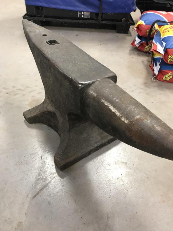

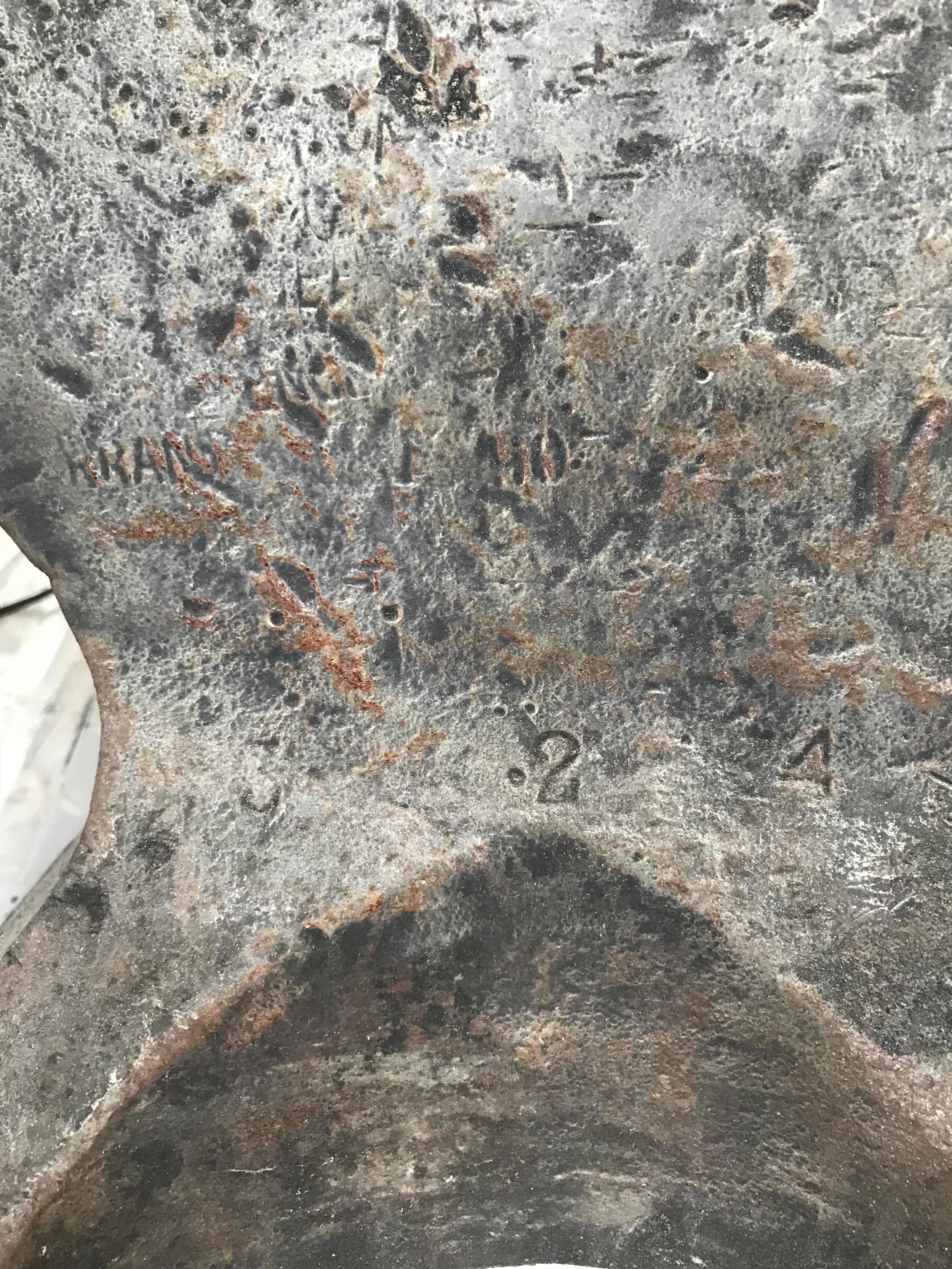

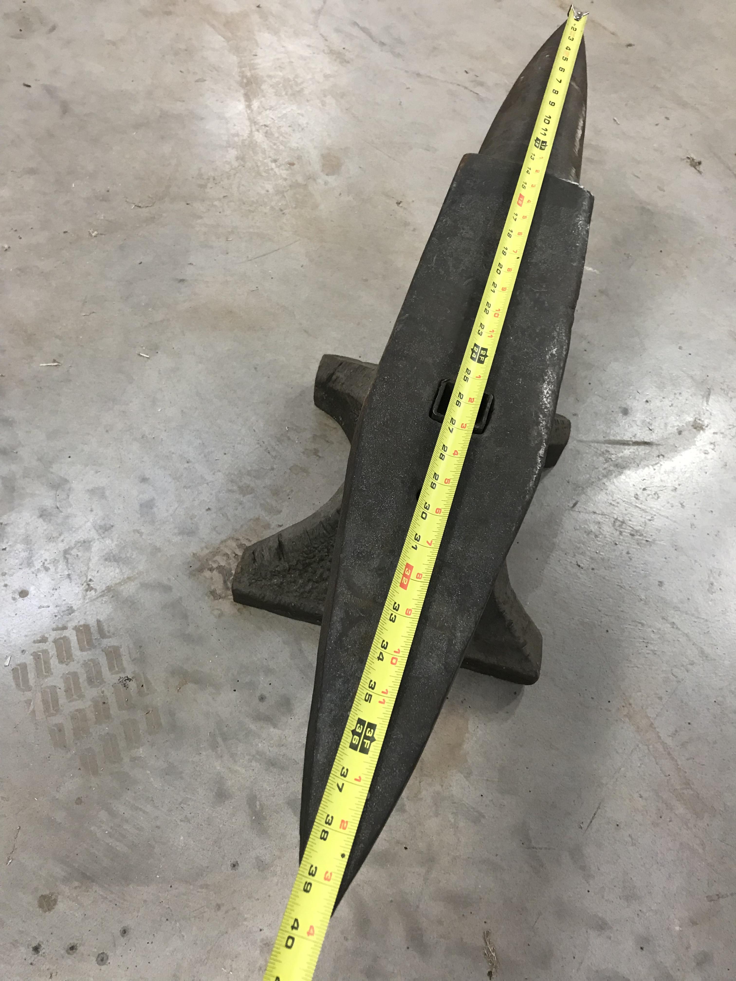

I recently traded for a new to me anvil.  I was wondering if you guys can tell me anything about it, maybe the manufacturer?  I don’t see a name stamped on it.

Lovely anvil! Just the right size and shape.

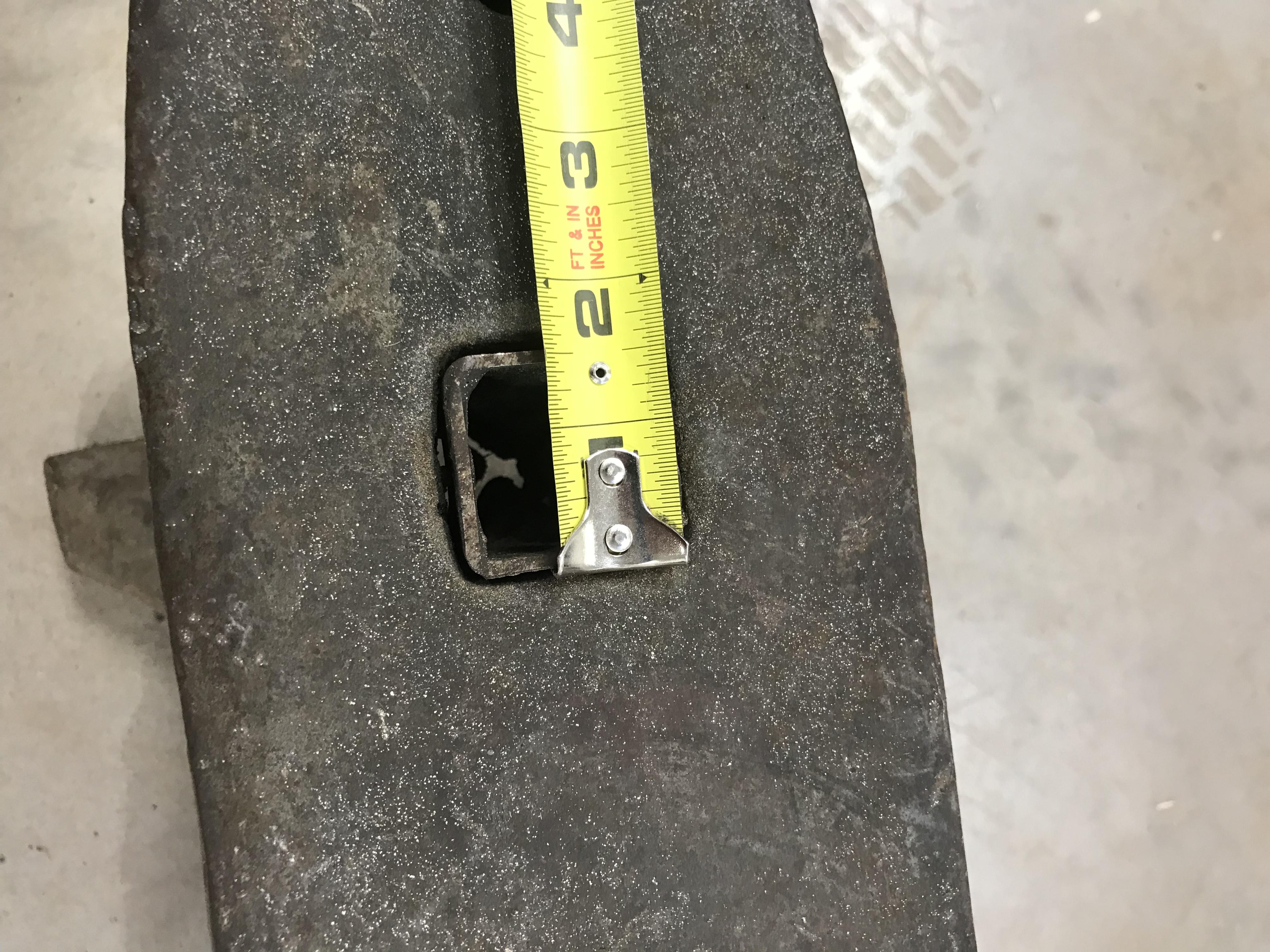

Someone sleeved the hardy to use smaller tools.

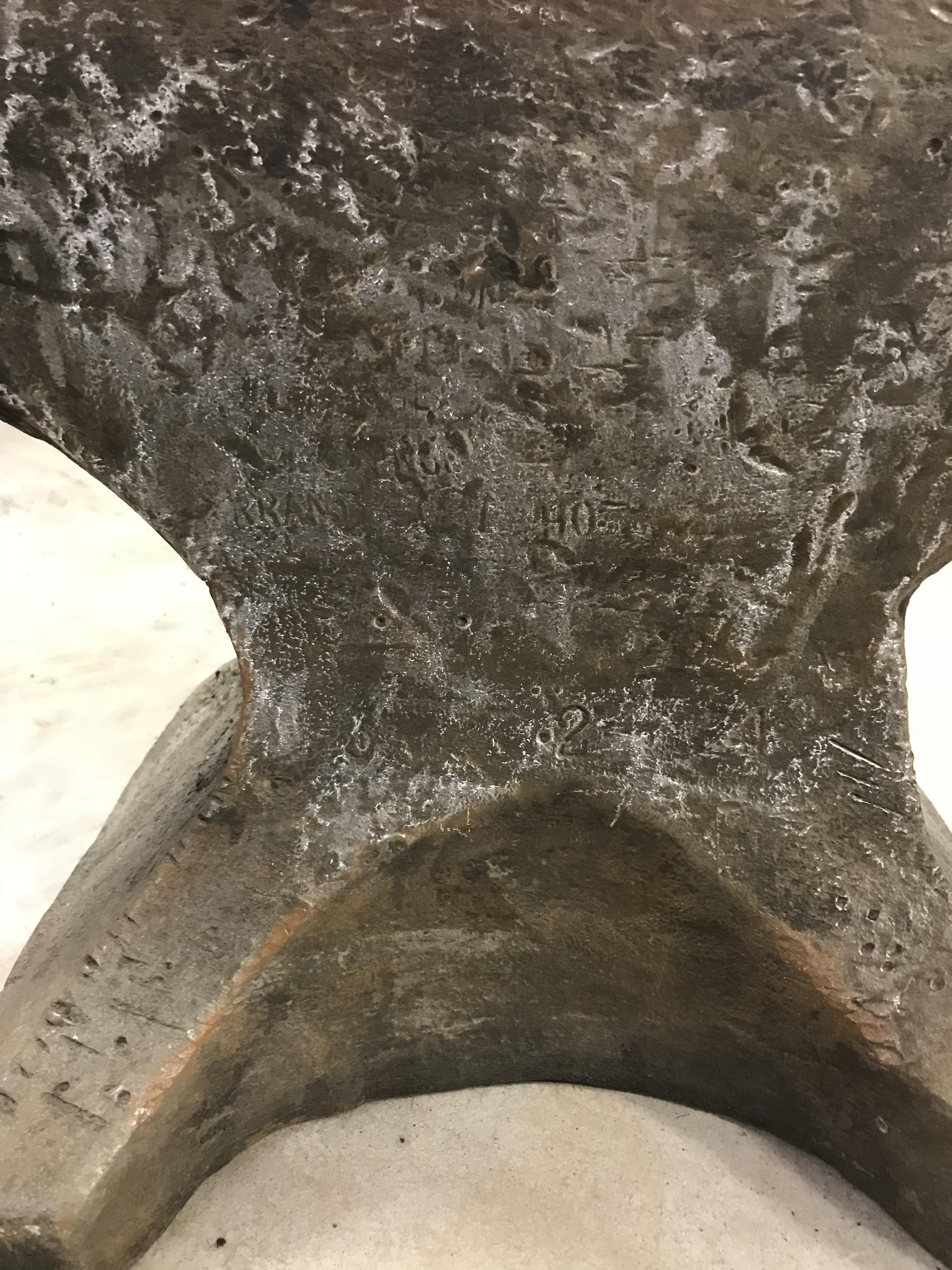

There is some writing on it. Use chalk to reveal it. All I can see is RKANS ... and HO ... I really like it. Did you pay much for it?
Any manufacturers in ARKANSAS perhaps?

Since the only words that I can seem to make out in the first photo are "shEFField" "wARREnted" "MOuse" "HOle", I am afraid I can't help you.
Wow, I didn’t see any of those word.  But I don’t know what I’m looking for either.  Thanks.
Certainly no mouse hole I have seen before. Great spotting John! I'd love to find one of these.

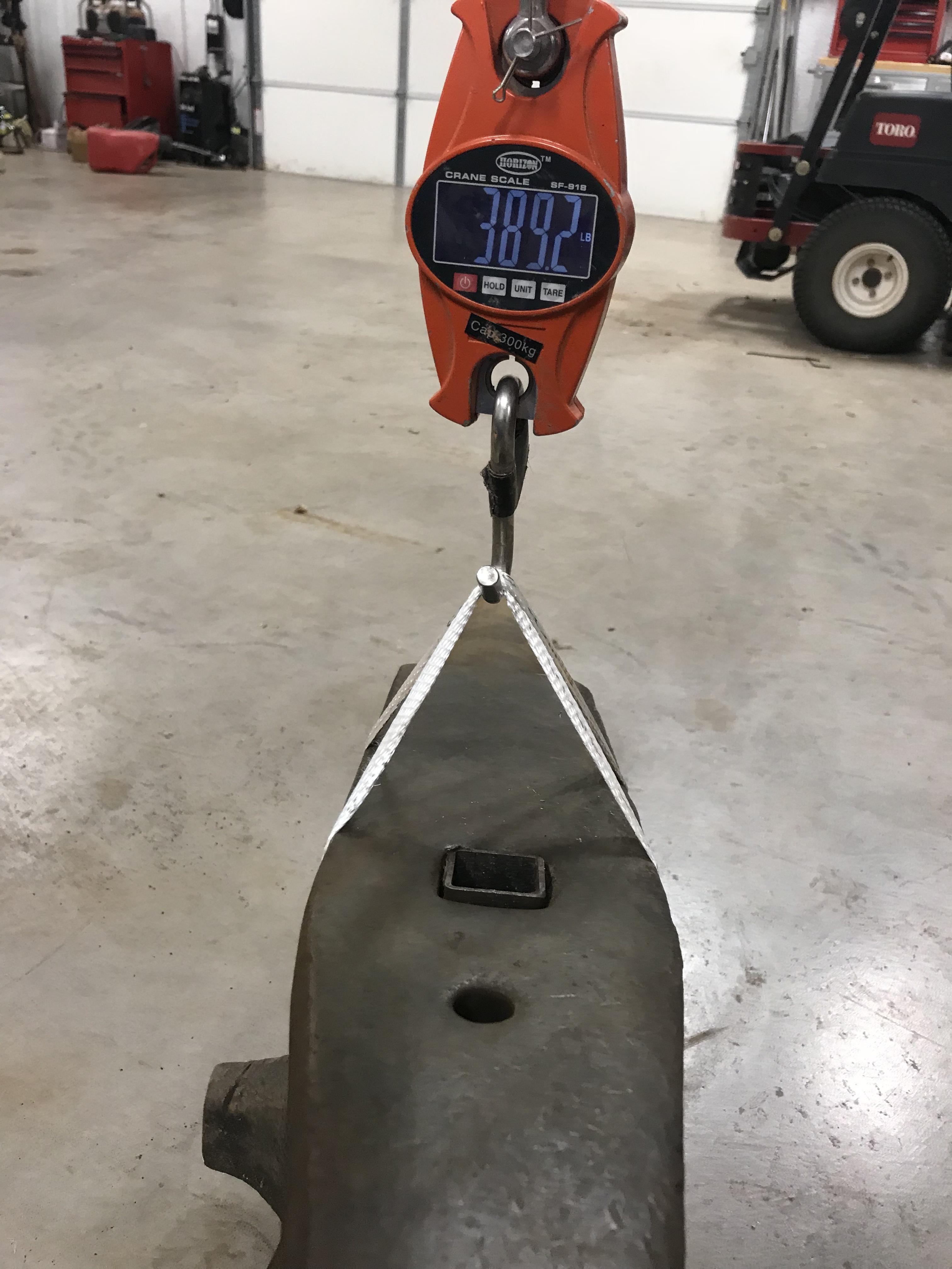

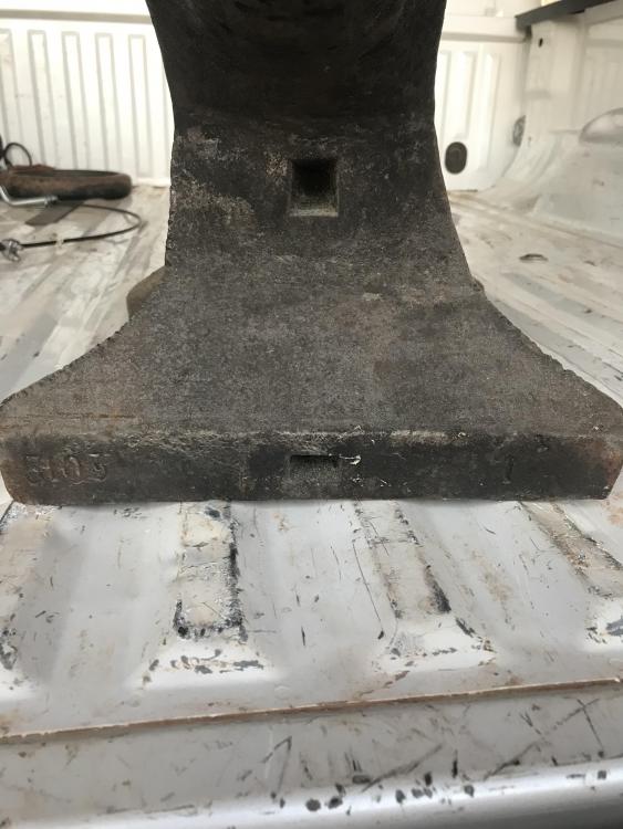

Does that weight marking say 3-2-4? That would make it 396 pounds, or a bit over $3/pound. Not half bad for an anvil that size, let alone The Undisputed King of Anvils­™.
It's NOT a Soderfors John, weren't you paying attention? Oh I get it you were joking.
Really nice score! Beautiful top shelf anvil and great shop size.

I got a scale and weighed it.  It came in at 389.2, but it wasn’t a high dollar scale.
I can't argue about how nice it is to use a Fisher and not have to wear ear protection and shout. It's one of those trade off things but if you get the right ear protection you can listen to the radio or chip or your Rice Crispies the next day.
389.2 is close enough, anvils weren't weighed on precision scales back in the day and they tend to lose a little weight over the years. The 0.2 lbs might be the sleeve in the hardy hole. :rolleyes:
