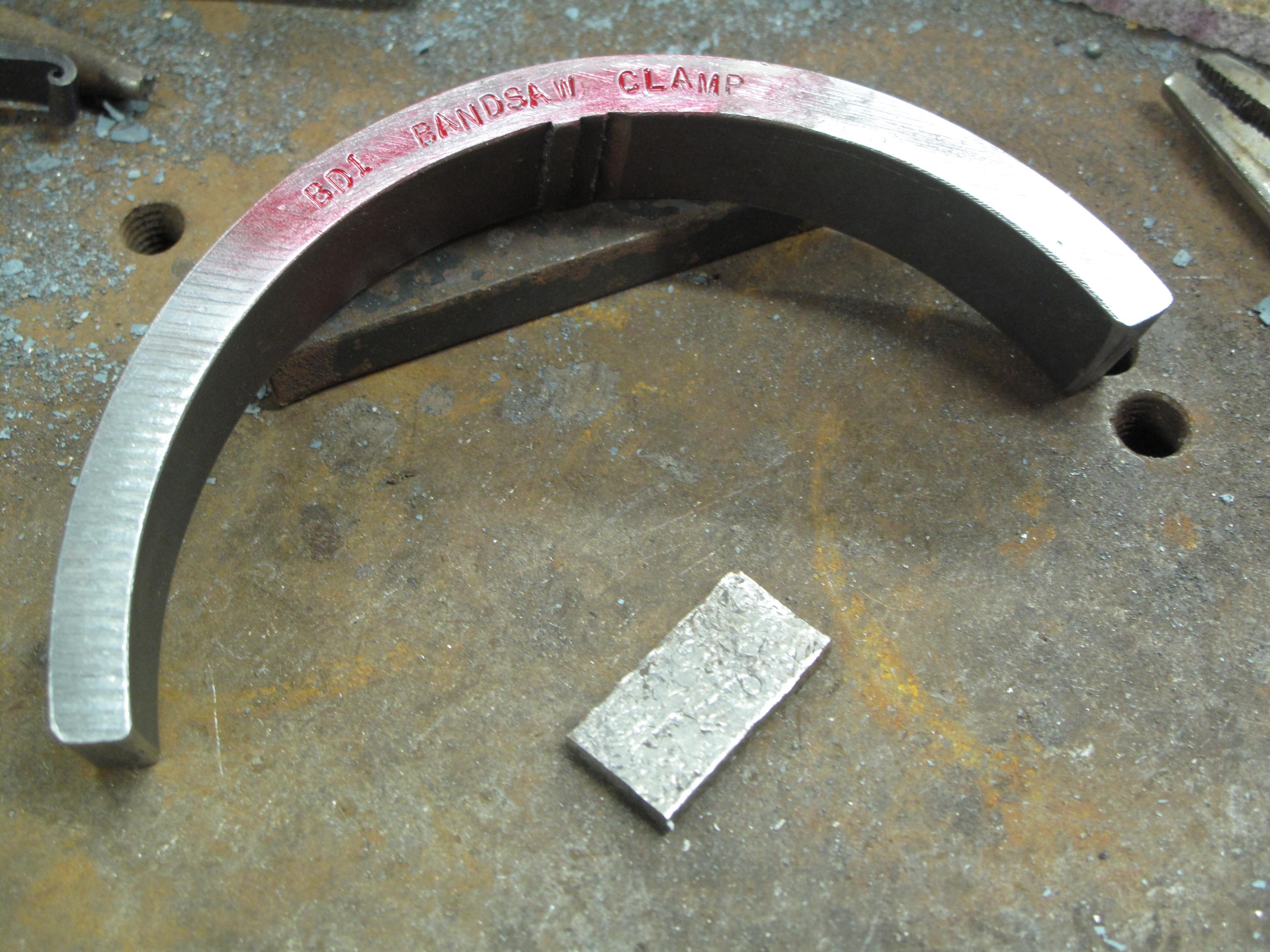

The clamp is just a 1" slice taken off some heavy-wall pipe I had.  In this case, 3/8", but you could use anything you might have.  I was thinking you could even forge a flat bar into a curve and use it rather than wait to find a piece of pipe the right size.
The clamp bridges the gap, so to speak, so you can cut a short piece from a short piece.  If the OEM table clamp on your bandsaw doesn't reach, or the piece is too short to get a good grab, the BD1BC comes in really handy!
I needed to make up a rune pendant for a nice lady, but didn't have a long bar of the weathered metal handy.  Rather than forge some new bar, I opted to make a BD1BC first thing this morning and give it a go.  Worked like a champ allowing me to cut 1-3/8" off a 5" bar.
Action shot!
After Action, with the cut piece.  Not much to the "construction" of these things.  I didn't use a full half-circle, opting to leave the rest of the tube for a circle jig that'll look good hanging on the wall.  Just cut a slice, ease the edges with a file, and you're done.  I do recommend you stamp in the name like I did just so you don't accidentally throw this thing away.  I'll likely end up painting the whole thing red just so I can find it easily and don't think it's scrap for the scrap yard!

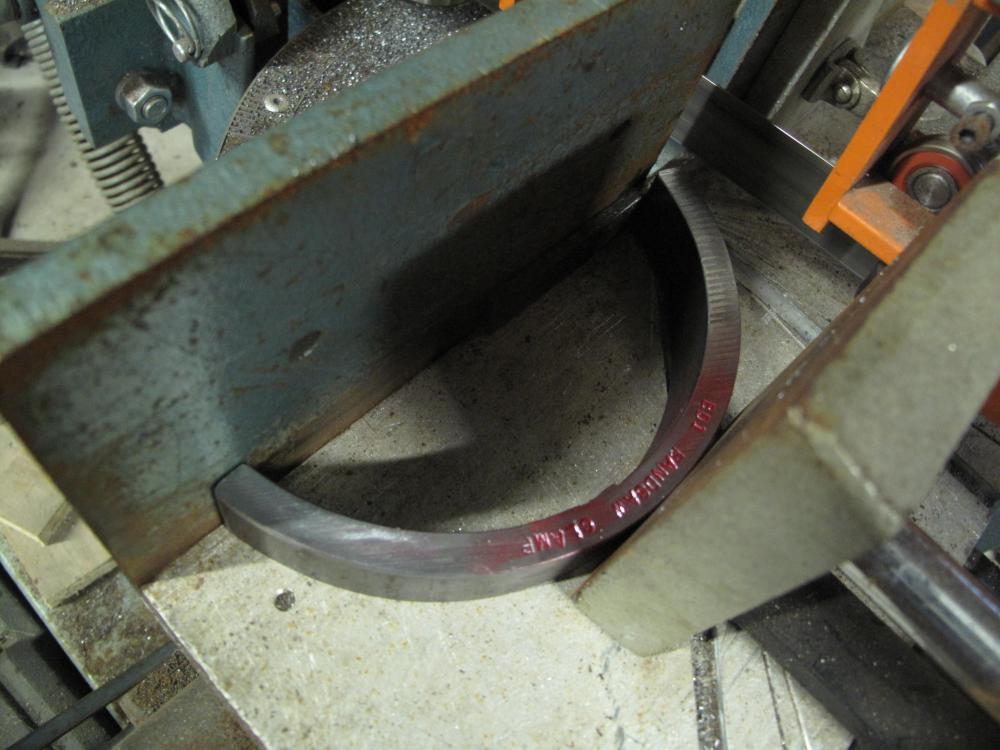

Frosty, it’s for holding pieces that are too short to reach the movable jaw of the vise. It’s a third class lever: one end rests on the workpiece (load), the other rests on the immovable jaw (fulcrum), and the movable jaw presses against the center (effort).

The curve of the BD1 Bandsaw Clamp does away with the need for any filler packing.  It reaches from the fence to the end of the piece, right before the gap where the blade passes through, and fits any size stock you have. In this case, I was cutting 3/16"x3/4"  bar, but the one clamp would work on anything from 1/16" up to, well, whatever size the curvature will accommodate.  No filler packing needed, so you don't have to hunt down a piece the right size for what you're needing to cut.
Not being a screw vise, there's only so much pressure the bandsaw's vise can apply.  While my BD1 did deform a bit when I threw the lever on the vise, it bounced right back when I let off the pressure.  At 3/8"x1", it's pretty stout and I don't think it'd be a problem to forge it back to shape if it ever took a permanent set.

Frosty, here's a better picture -- the original BD1 Bandsaw Clamp in action!
As you can see, the piece being cut is far too short for the OEM vise to grab solidly.  With the arc of the BD1 clamp, though, the vise can apply pressure right up to the edge of the gap in the fence.  Because the pressure of the clamp is distributed over those two little points of contact, it's a very strong grip and you don't have to worry about slippage.

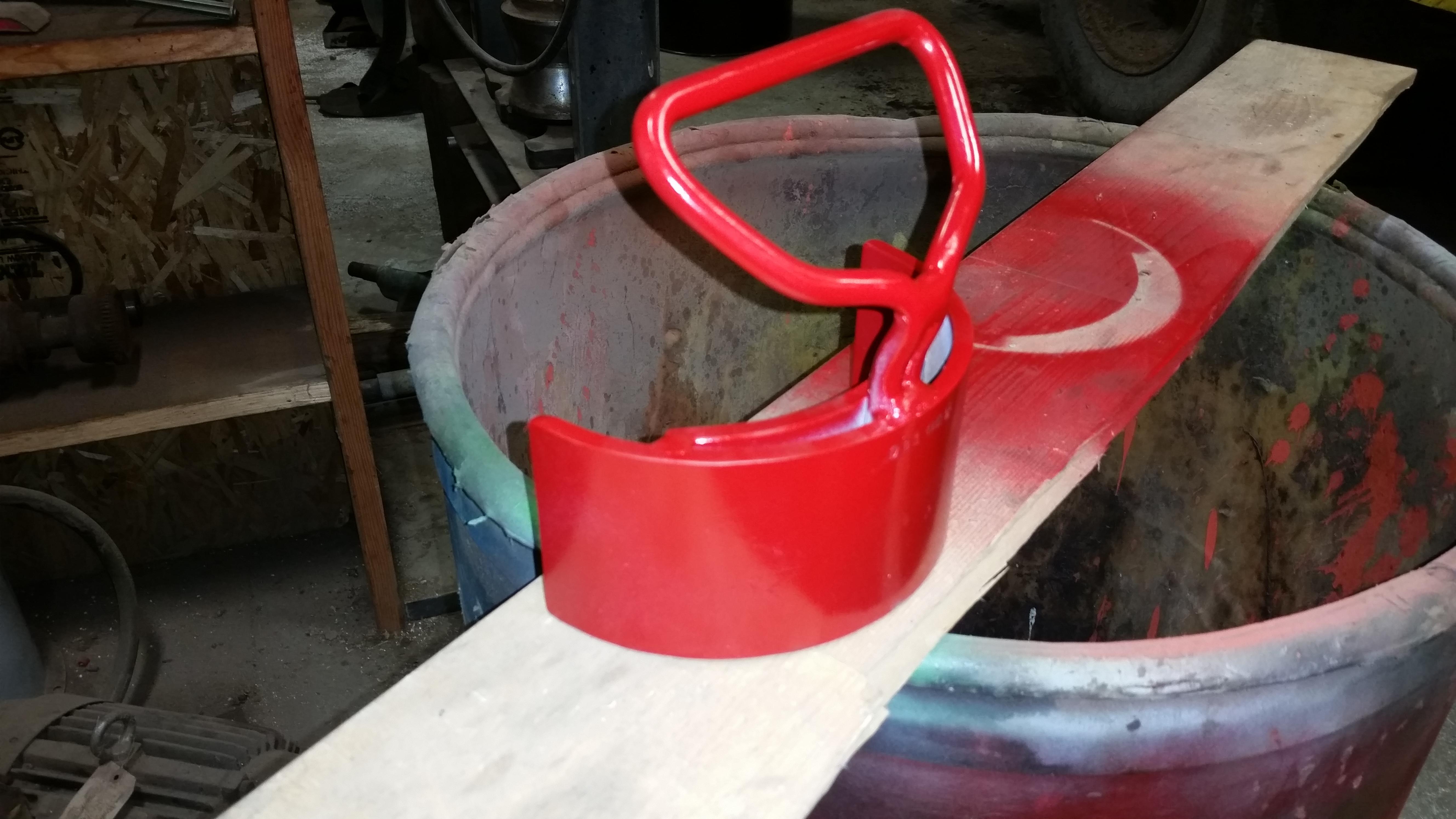

Made this one out of 6"pipe. The only drop we had was schedule 80 so I reinforced it with another section of pipe leaving the ends alone hoping to keep some spring to it. 20180821_083657.thumb.jpg.9fd07333ba1235f82cb91ab73bec3843.jpg

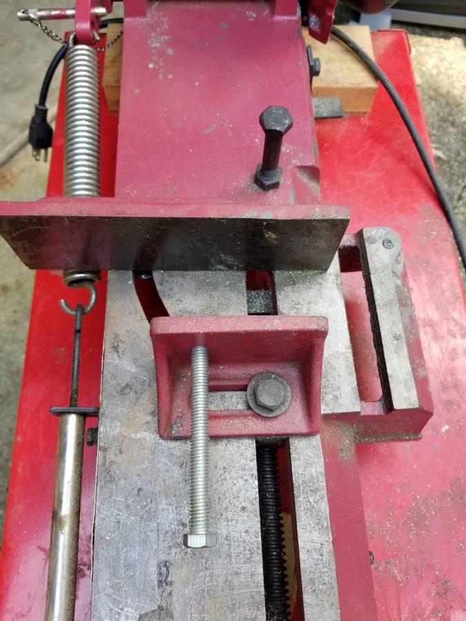

Has anyone seen the jackscrew method to accomplish the same thing?  I just drilled and tapped a hole for a 1/2" bolt through the side of the clamp furthest from the blade.
Really gorgeous.  I like the overkill design and nice big handle.  That's not likely to get lost around the shop any time soon!
