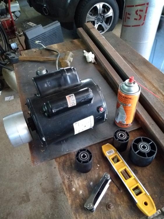

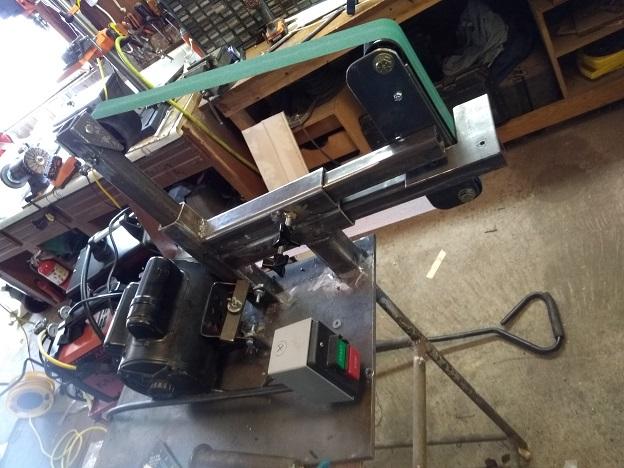

Get a load of my new Grinder
Though not fully fleshed out yet, I am now getting excited .

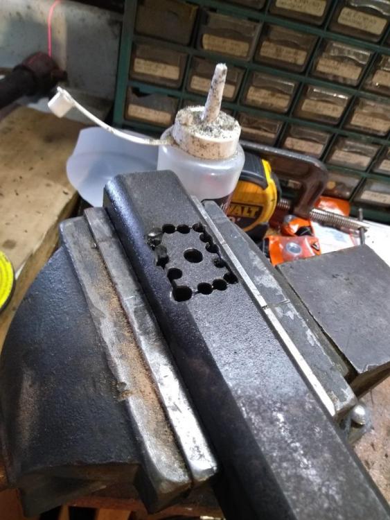

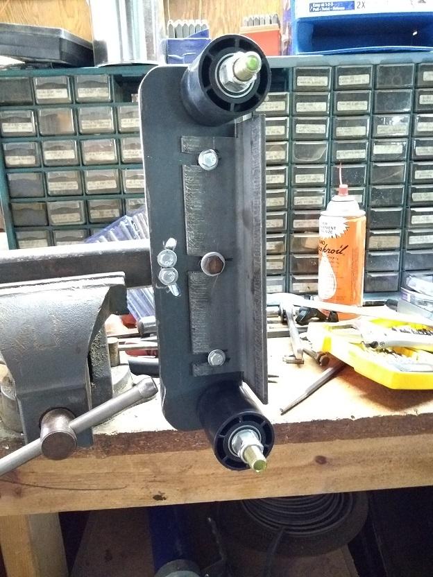

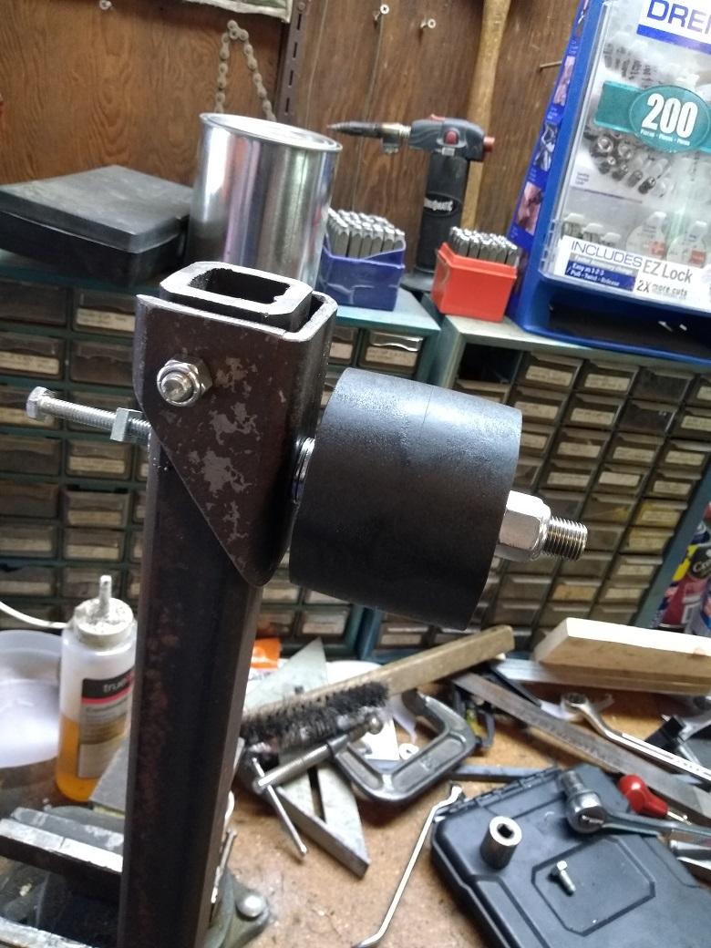

Not so oppressively hot today, so spent some time in the garage today working on the tracking wheel assembly.
forge180a.thumb.jpg.60b57e937f51be6bb93923d28e8611e7.jpgforge178a.thumb.jpg.8273b8f52d87a33f7064891100da5bde.jpgforge179a.thumb.jpg.99230ce42c3fc9c74e7f1627bd36308d.jpg
Thanks Shawn.   going to steel mart tomorrow to nose around their cut offs for the idler wheel plate and platen parts.
Coming along! Looking forward to the finished project.

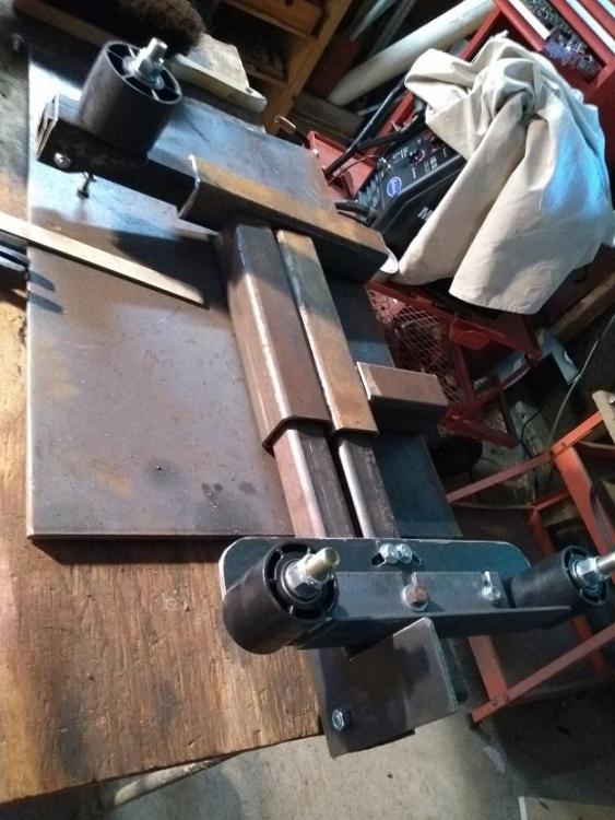

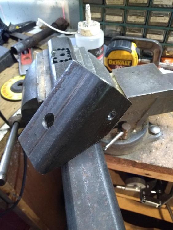

Got the guide wheel plate, adjustable platen and tool rest built today.  Should be welding it up soon.

Got it tacked down and squared.  Mocked it up just to gander at it.  I know my welding leaves room for improvement.
Thanks John.  I hope it all works out.
She's running!  took a while to get the tracking set, but now it seems to be doing well.  this is just to show it running.  I have the platen too far from the belt in this shot.  Now disassembled for painting.

I can now say it is finished.  Almost.  still must affix a signature handle on the tracking pillar to compress the tension spring.  But other than that, she's a runner.  the tracking pillar does not fit the support tube tightly, so right now it has some plastic shims coated with graphite to keep it square.  might do something to make that a more permanent and precise tolerance.  Other than that it works fine.  Already second guessing my choice of black as it really seems to collect the dust.   Oh yeah, I still need to put the static draining brush on it.

Thanks very much Stevo.  I've already used it quite a bit and am wondering how I got by without it.  It is so useful.  In fact, I've not even truly finished it as I plan on a lever to slacken the belt for change.  the plans called for a static discharge brush.  will that cause the dust to not stick to is so much?  Is it really needed?
Since you are running non-conductive wheels it is likely that you will see a  build up static electricity if it's not drained away.  I've had it happen a little with aluminum wheels on some high grit belts with a soft kind of fuzzy backing.  Not sure how that will affect the dust.  To me it seems it gets everywhere in the general vicinity of the grinder no matter what I do.
