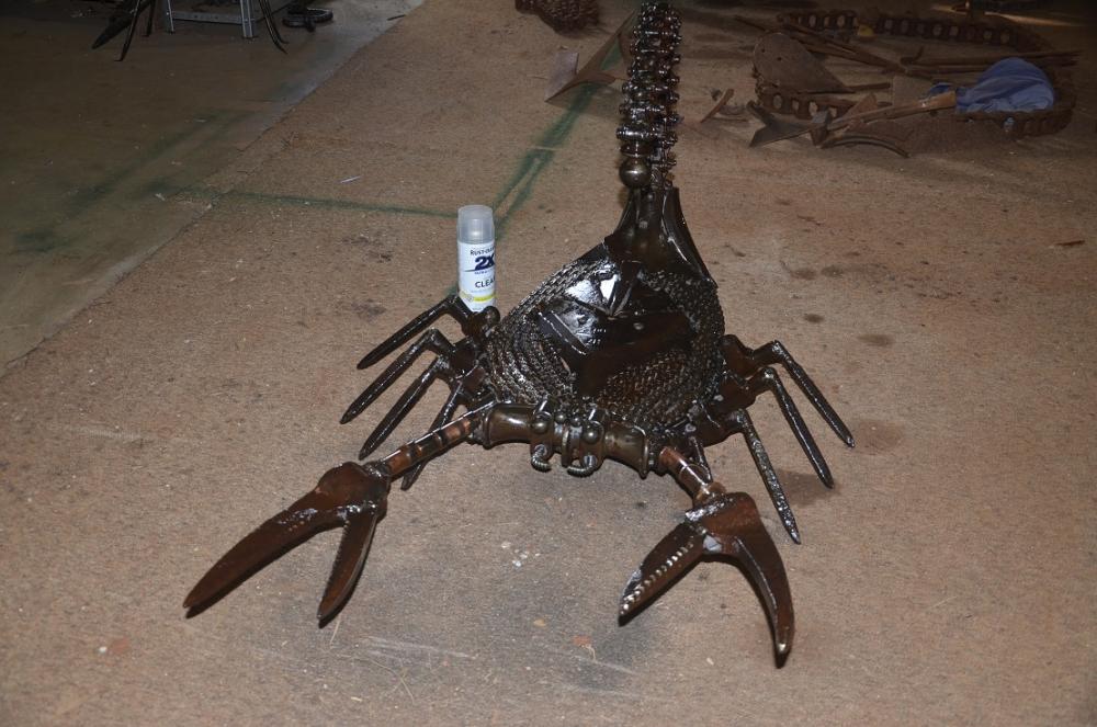

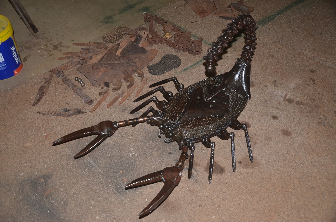

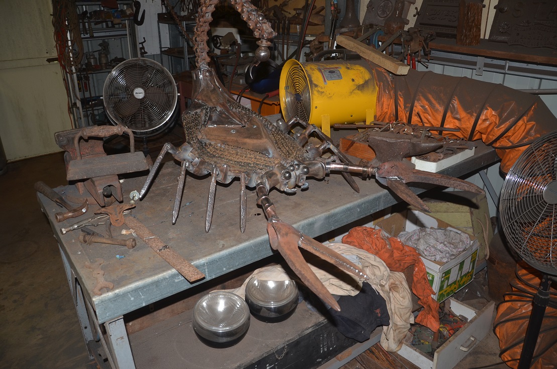

ausfire Posted May 27, 2018 Share Posted May 27, 2018 Finally got this big ol' scorpion together. Started with a large plate off some sort of shredding machine and added the rest. The legs are claw hammers with harrow spikes. The tail is a chain from a corn sheller and the sting is a file handle welded to a tow ball. The head is a thing used to carry cables on a high voltage power line - needed a lot of zinc removal. I decided to add the motorcycle chains as a texture for the body. It is finished with Rustmasters, but I'm thinking of a gloss black spray paint. It has quite a weight to it - definitely a two person lift. I put the spray paint can beside it for size comparison. Quote Link to comment Share on other sites More sharing options...

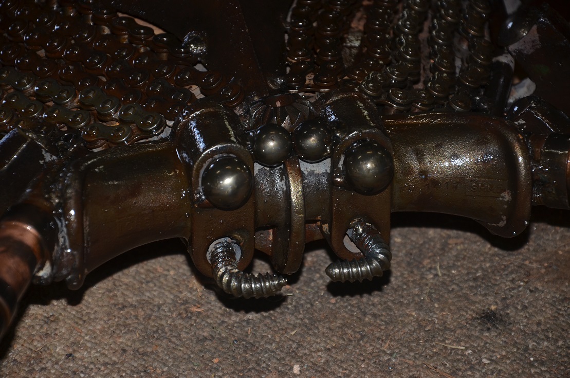

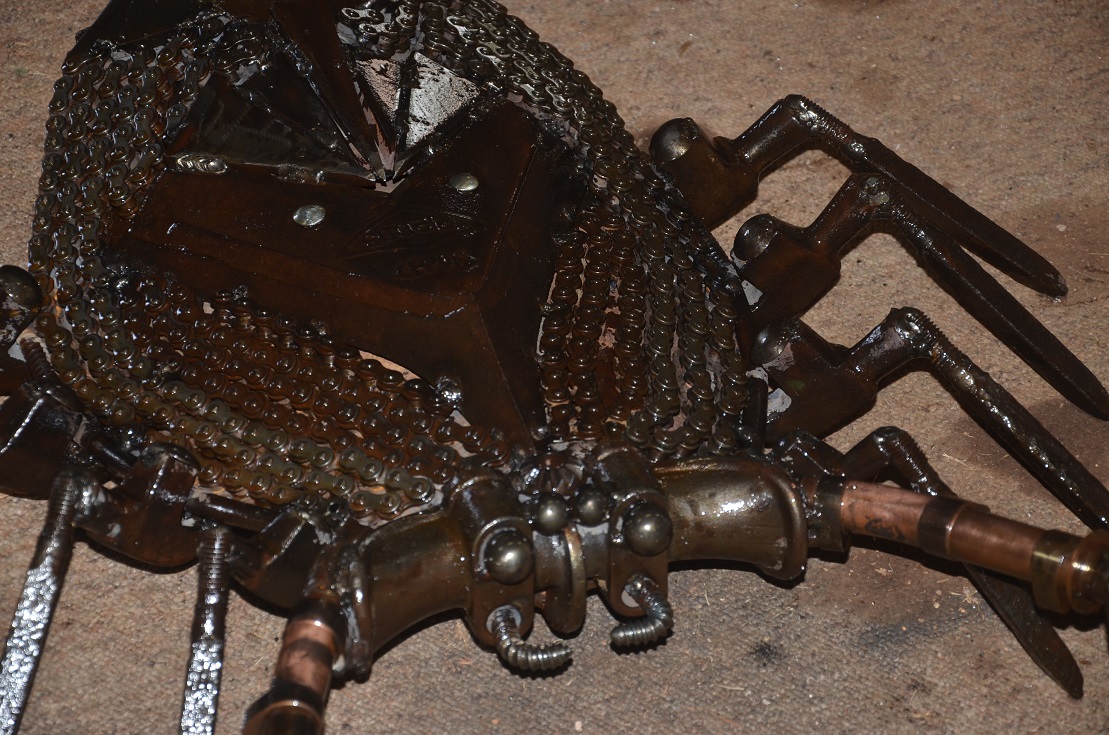

Daswulf Posted May 27, 2018 Share Posted May 27, 2018 It turned out Awesome Aus. That's going to really turn some heads or send people running lol. The pick heads worked out great as the pinchers. The grinding on them adds good effect. The chain on the body is a good touch. That had to be a pain. I like the look of the eyes. Ball bearings always darken up with the clearcoat. I'd like to find a better way to keep them brighter myself as they lose a little life when they darken up. Really neat chain for the tail. And nice use of the claw hammers for the leg parts. Over all there's a lot going on in that guy and it looks great. Almost need to add forks to a dolly to move him around Quote Link to comment Share on other sites More sharing options...
Rojo Pedro Posted May 27, 2018 Share Posted May 27, 2018 Cool! how long did it take to build? Having been stung twice, I hate scorpions big time. I'd want that one to scare off the little ones. Nice work Quote Link to comment Share on other sites More sharing options...
ausfire Posted May 28, 2018 Author Share Posted May 28, 2018 16 hours ago, Rojo. Pedro said: Cool! how long did it take to build? It's hard to put a number of hours on it. Do you count the hours digging around in the scrap piles to find the right scarifier point? I've been doing at bit at home in the afternoons after mornings at the forge for a week or so. I think the time to assemble and adapt all the bits exceeds the actual welding time. 16 hours ago, Daswulf said: The chain on the body is a good touch. That had to be a pain. I like the look of the eyes. Ball bearings always darken up with the clearcoat. I'd like to find a better way to keep them brighter myself as they lose a little life when they darken up. Yes, welding that chain was a pain all right. I still haven't got the MIG going so this was all done with the stick welder. The chain on the tail was a bit rusted and there was lousy earth between the links. I thought of leaving the eyes uncoated so that they shine, but they would possibly rust in time, so the clear coat will have to do. 19 hours ago, tkunkel said: Now I could have nightmares:) Nice work! Thanks. I went into the shed to clean up a bit tonight, and it looks pretty scary in torchlight. While cleaning up all the spare parts and stuff, I realised that I have enough left over to make a twin for this one. Maybe I should have two of them engaged in an almighty battle. Nah, I'm over scorpions for a while. The chains would make a good covering for a crocodile though. Hmmmmm. Quote Link to comment Share on other sites More sharing options...
