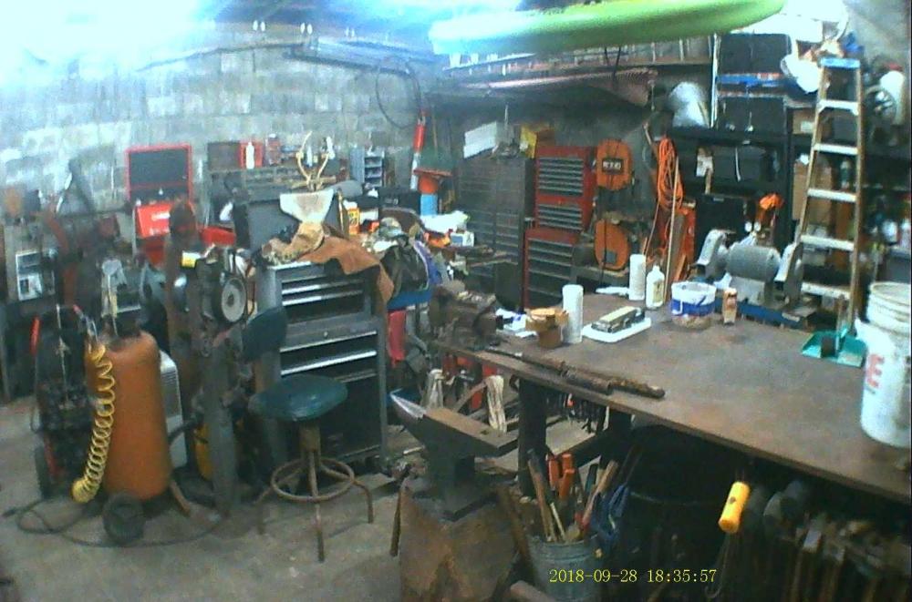

I have an old work/welding table that is 3' X 5'.  I haven't really cleaned it in 20 years.  I would just grind or wire brush a small area to get a ground.  I have used it for everything and as a result, it has 20 years of different colored paint.  I'm going to clean the entire table now.  I'm using an electric angle grinder with a twisted wire wheel and a grinder with a grinding disk that is most likely 36 grit.  I was thinking that a solution of some sort may help the process?  I was thinking of vinegar since it will help taking off rust.  Any other ideas would be appreciated.
Flip it upside down and drag it behind the pickup for a minute or two. A paved road is good but dirt or gravel works fine, it just might dig in so chain it close.
If it's got legs, it can run behind the Truck......... Oops, trip, crash...
Put the stuff you clean off the top of the table away where it is suppose to go. Half the problem solved. Find a proper place for the rest of the stuff.
I've made paint scrapers from old files- just a 45 degree bevel that would make short work of the paint, as well as heavy rust. Quieter and less dusty than a grinder. You'll need the grinder with a disk or wire wheel to finish up.

SoCal,
I used a gel based paint remover from Wallyworld that worked a treat removing a baked enamel finish from steel.  PPE is critical for that stuff but probably 90% of the paint slid off with a putty knife. The tenacious stuff took a second treatment but no more.  As memory serves that gel was soap and water cleanup.
I left it on overnight for the first application, and maybe 15 minutes for the second.

I started cleaning off my work table; it just led to more projects completed and started...stuff is still on it :)
