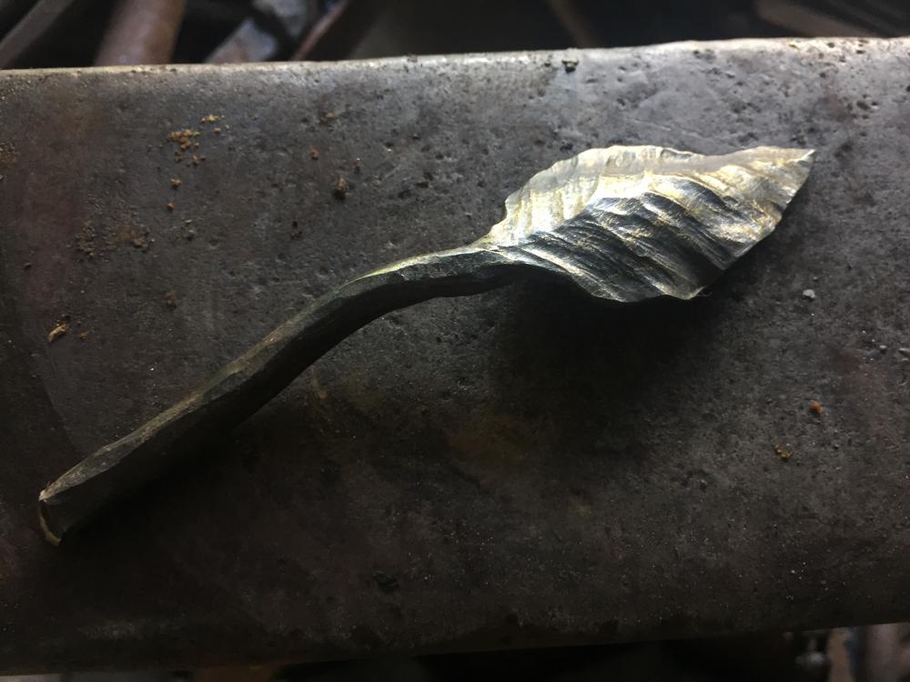

Another option for a slightly different effect (also good if you can't find a brass brush) is to use a piece of solid brass. A brush will do almost the entire surface, while a solid piece will only give color to the highest points. It's a more subtle effect, but it really helps bring out the texture of a hammered piece. For example, here's a leaf that I did with brassed highlights:
Just as with the brush, the solid piece should be like Baby Bear's porridge: not to hot, not too cold; just right.
