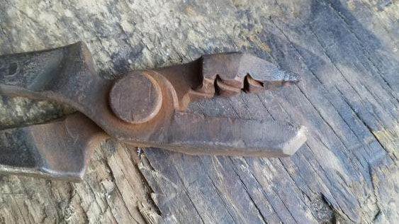

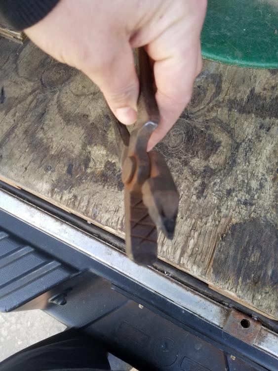

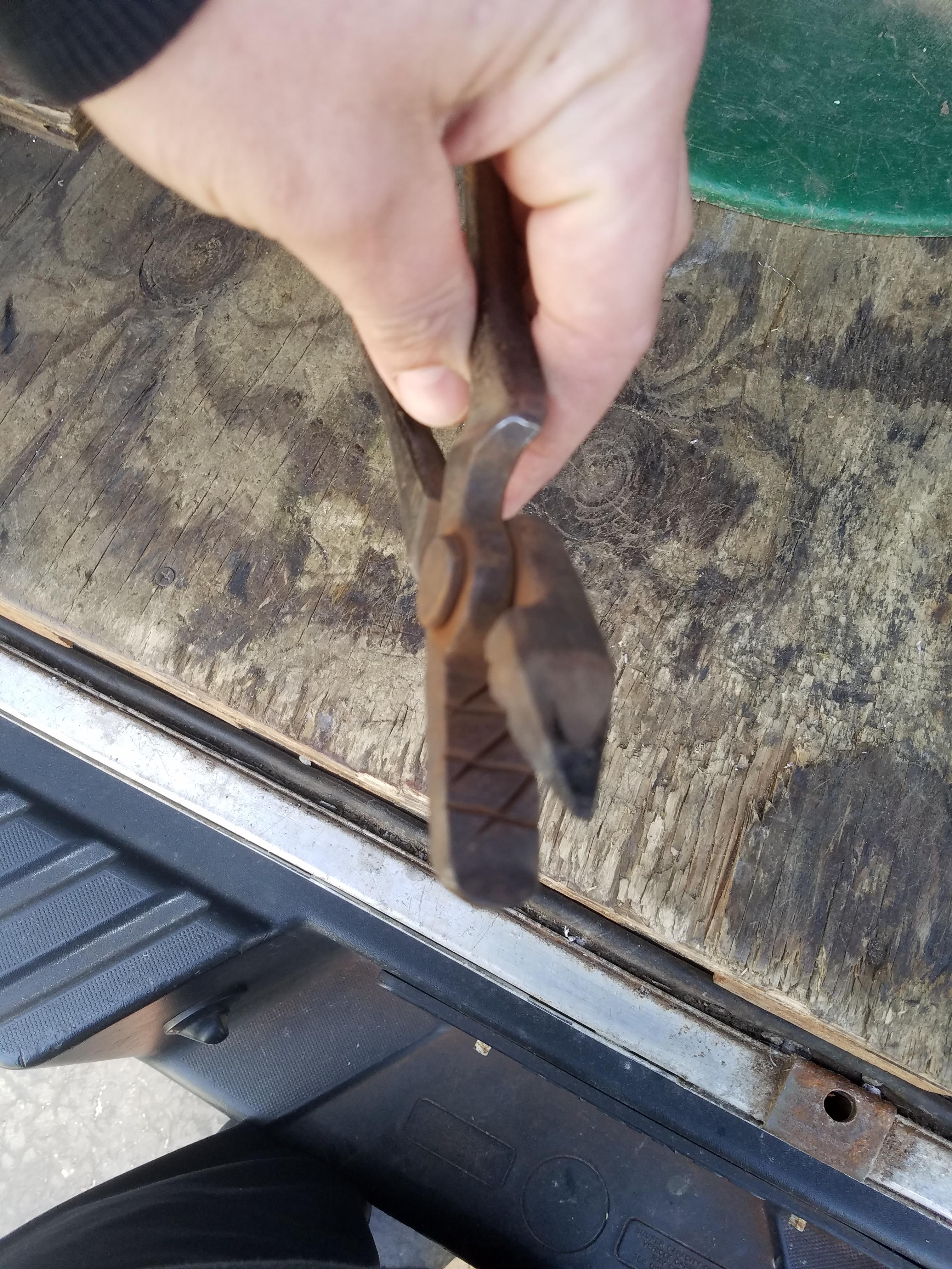

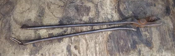

Hotshoein4 (Mark) Posted February 28, 2018 Share Posted February 28, 2018 I like and prefer the tong style. Point on 1 jaw to go in the nail hole and flat on the other jaw going against the inside rim of the shoe. I also like a ring on the end of the reins so I don't have to worry about the shoe falling out when I set it on the ground while making sole relief. And usually, from what I've used, they'll generally fit a 5/16" thick shoe in the jaws. Can make quick adjustments at the anvil without switching tongs. I'll take a picture of mine later today for ya. Hope all that helps ya out. Quote Link to comment Share on other sites More sharing options...
Hotshoein4 (Mark) Posted February 28, 2018 Share Posted February 28, 2018 Here are the ones I like. 17" from the tip of jaws to the end of the reins Quote Link to comment Share on other sites More sharing options...
Ranchmanben Posted March 1, 2018 Author Share Posted March 1, 2018 Thanks Horseshoein4 (Mark) That’s pretty dang close to what I’d like my final result to be. I’ve got a pair of Roy Bloom’s and a set of Jim Quick’s borrowed to use for scale. Who made those? Quote Link to comment Share on other sites More sharing options...
Ranchmanben Posted March 1, 2018 Author Share Posted March 1, 2018 Also, are the “teeth” in the jaws necessary? Quote Link to comment Share on other sites More sharing options...

Hotshoein4 (Mark) Posted March 1, 2018 Share Posted March 1, 2018 Ranchmanben - I doubt the teeth are necessary, but I'm not sure. You'd have to test with and without. These are just about the same as Jim's tongs. They were made by Yukon Forge. Long time out of business unfortunately. They are absolutely not weaker. I feel they are stronger with the shoulder in the reins honestly. And yes, they look sweet. Latticino - here is a fantastic reference video for bolt tongs with the shoulder and offset. And here are flat jaw tongs Quote Link to comment Share on other sites More sharing options...
