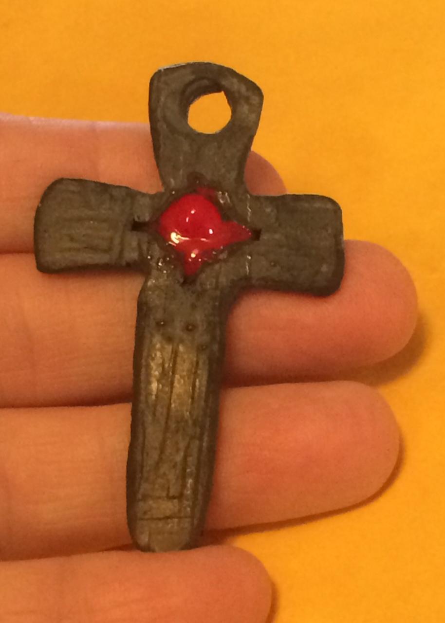

Frosty Posted April 10, 2022 Share Posted April 10, 2022 I slump bright red glass frit into the center of spread crosses. The guy at the art glass supply insisted it couldn't work even after I showed one to him. I bought a tube of different color "noodles" and use chips to accent things. Molten glass is about as sticky and stringy as it gets, the front of my forge looks like a pyrospider lives in it. Frosty The Lucky. Link to comment Share on other sites More sharing options...

Frosty Posted April 10, 2022 Share Posted April 10, 2022 An early one, I got better at both crosses and slumping frit but I forget to take pics. Frosty The Lucky. Link to comment Share on other sites More sharing options...
TWISTEDWILLOW Posted April 10, 2022 Share Posted April 10, 2022 That’s awesome Jerry! Did you do that using a gasser or solid fuel forge? You got me wanting to try that on my split crosses! Link to comment Share on other sites More sharing options...
Frosty Posted April 11, 2022 Share Posted April 11, 2022 The gasser, I don't burn solid fuel at home. Well rarely, very . The real trick is keeping it from flowing out through the bottom of the cross and coating the other side in a curdled globbery mess or hopelessly cementing it to what it's laying on. Soap stone works petty well, I picked up a couple tiles at the local tile shop. Let us know if you come up with a way to keep the glass where you want it. The one pictured is barely slumped and didn't fill the corners of the negative space. However get it much hotter and the glass goes everywhere. Some shapes are easier to fill than others, the negative space in a spread cross is one of the more difficult. In my limited experience that is. Frosty The Lucky. Link to comment Share on other sites More sharing options...

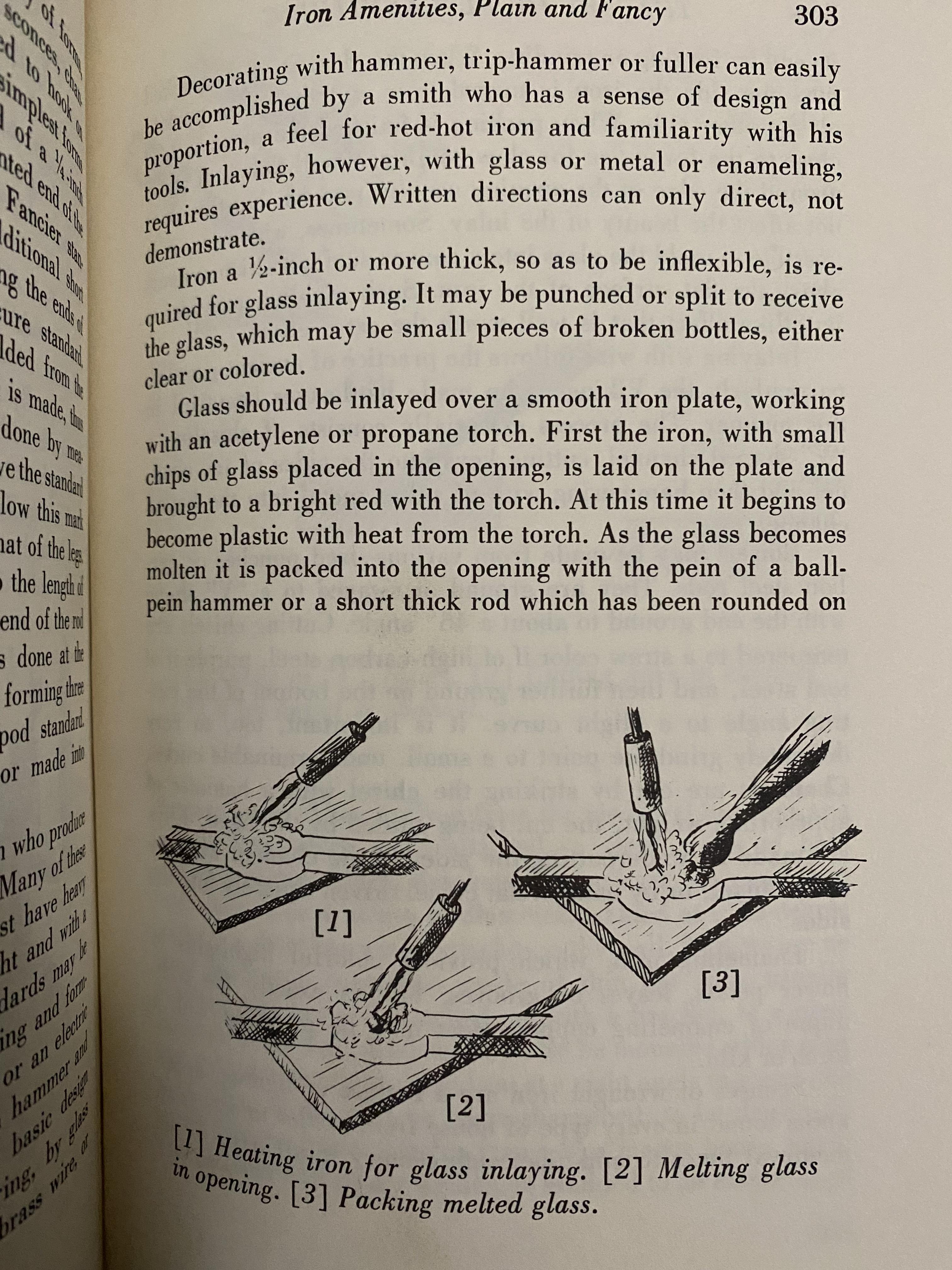

anvil Posted April 13, 2022 Share Posted April 13, 2022 I have limited experience with glass and iron. I did some glass in a punched eye as finials in handled tools. I used glass bottles I found and crushed the glass to a fine powder. The powder went in the punched hole and all was heated on the top of my forge on a preheated 1\2" plate until the glass melted and fused. I then "packed" the glass into the void to fill the space and slow cooled the whole deal to prevent thermal shock. I covered the plate and glass unit with thermal blanket and buried it in lime. The bottles were common so the colors were brown, green and clear. The idea for this came from "The art of the Blacksmith" by Alex Bealer. note": I just gave a quick look thru his book, but did not locate the article. I'm still pretty sure it came from there or perhaps one of Weiger's books. I also worked with a glass blower who ordered basically trivet shapes from me. Three riveted legs and varying shaped tops forge welded from rectangular stock. He wanted my hand work as forged detail to accent his glass. He then slumped the glass into the open top. The height of the legs varied per piece and I believe he sold them as glass and iron planter pots. I saw some of the finished units, but do not know what his techniques were. Link to comment Share on other sites More sharing options...
JHCC Posted April 13, 2022 Share Posted April 13, 2022 I'm pretty sure that's in Bealer, not Weygers; I'll check later. Link to comment Share on other sites More sharing options...

JHCC Posted April 17, 2022 Share Posted April 17, 2022 On 4/13/2022 at 1:00 PM, anvil said: The idea for this came from "The art of the Blacksmith" by Alex Bealer. note": I just gave a quick look thru his book, but did not locate the article. Found it: it’s on pp. 303-4. Link to comment Share on other sites More sharing options...
anvil Posted April 20, 2022 Share Posted April 20, 2022 Thats the article. Thanks for finding it. Link to comment Share on other sites More sharing options...
