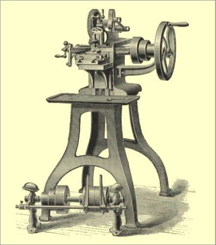

Kozzy Posted September 30, 2019 Share Posted September 30, 2019 As artfist said, this is NOT the same thing as a woodworking "shaper". It's a handy tool to have around but rarely used these days because they are too slow and take some thought to set up. That being said, don't pass up one of the small units if you run across one at scrap prices. There are some things they really shine at...especially making ugly stock into something flat and usable. Once you start "dreaming" of set-ups, all sorts of stuff begin to come to mind. The machinist brains of 100+ years ago were even cutting things like curved dovetails with them. Mine is a veeeery old Giddings & Lewis traversing head shaper. It mostly collects dust but there is nothing like the slow clacking of the clapper as it creeps across work to make for a relaxing afternoon. This one but motorized. Quote Link to comment Share on other sites More sharing options...
