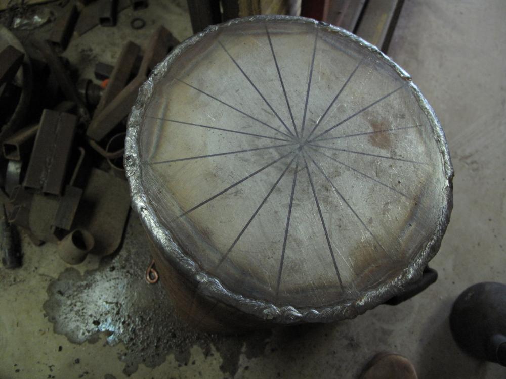

In this case, I filled an old nitrogen tank with sand, oil and scraps of steel to make a nice heavy dishing stump.  No idea how much it weighs right now, but I'm betting it's every bit of 300 pounds, if not more.

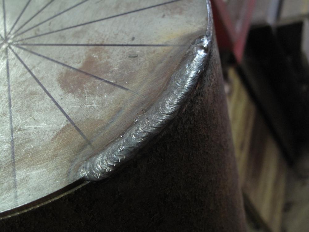

The base plate is 1/8" mild steel I had cut just a hair undersize.  The OD of the tank was about 9.125", so I figured having that little lip would give me a nice clean surface between the plate and the freshly cut end of the tank.  I wasn't disappointed.
Using 1/8" 7018 with my machine set around 116 amps, I went around the perimeter as good as I could manage.  Short bead, then go to the opposite side and run another short bead.  Once it was tied down at four points, it was just a matter of filling it in.   I still have to grind all the beads down so the stump will sit nicely on the floor, and I might have to do some fill-in work if I see any problems.  Overall, though, I think it's water-tight and I won't have to worry about the oil eventually leaking out!IMG_5771.thumb.JPG.2504d7de6b235b6538b0eab790b031fd.JPGIMG_5774.thumb.JPG.d94f7bc43a3395fe127ee6be45523cf1.JPG
Interestingly, I noted that whenever I get into long beads like this, I seem to be better going from right to left rather than left to right.  No idea why that is, but....

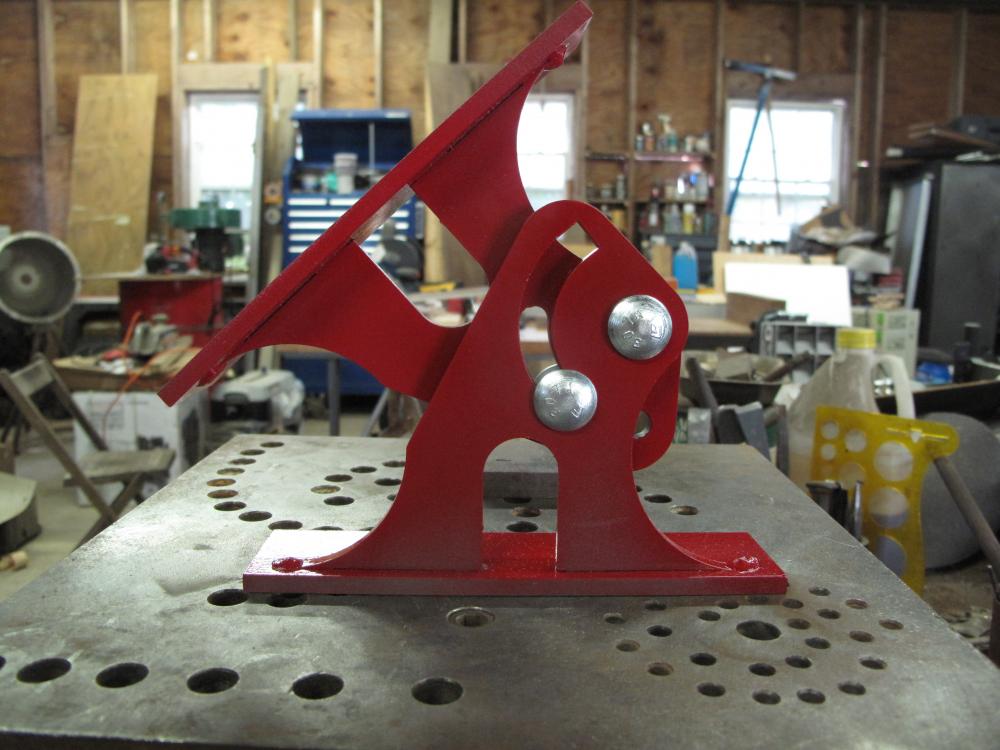

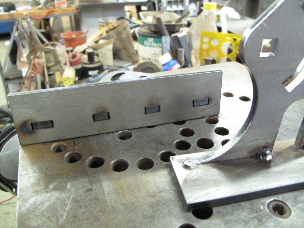

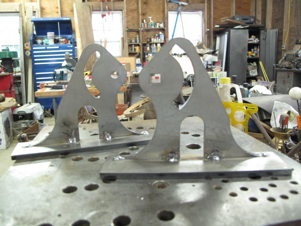

Oh, and to get warmed up a little bit, I tacked together this neat little adjust able angle contraption I picked up.  It comes as a kit and all the pieces are laser-cut.  All you have to do is tack it at a few points and then bolt the two pieces together.  When I saw it, I thought it would come in very handy when I'm building things, acting as something of a third-hand.  Clamp one side to the table and the other side to whatever I need held.  Being adjustable, I can swing it to any angle and then lock it tight.
IMG_5761.thumb.JPG.f63243d28c16b79b82fd49d9167cce0d.JPGIMG_5763.thumb.JPG.466bb0a78f4ebc8a9380efef4cd2bc20.JPG20597323_1940061922949273_19189088372380
Looks good i dont know if its the pic or my eyes but it looks like a little perosity on the bottom were you started goin left then right once you grind it down youll know for sure.Got a quik ques not to bust your chops or nuthen why use 1/8 on thin plate and was there any heat warpage.ME i would of used 3/32 but thats me, regardless nice layout and work.
Bubba, I'm far from being an educated welder, so it's entirely likely that your way is the better way.  I used the rods I had and that I'm familiar with.  I've tried some thinner 6013 rods once or twice and it was an absolute nightmare experience.  I can't seem to figure out what settings to put on the welder to get that stuff to run right, so I stick with what I know.
Porosity?  Probably.  Could be my technique, the rods, the settings on the welder, or a combination of all three.  Getting those three things to line up right..... that's the hard part! :o
Got the adjustable square all painted and looking good.
The Super Stump got flipped and I spent a few minutes going over the working face with the angle grinder.  I'm going to need to weld up the big stamp down in the bottom of the depression, but she's looking pretty good with the 60-grit finish.
