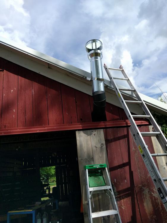

CreekSideForge Posted August 7, 2017 Author Share Posted August 7, 2017 Yes it is at anvil height. Probably just gonna go with a few handfuls of sand. Next problem is the chimney stack. I honestly have no idea what I'm doing here. It's in an old metal roofed barn and I don't know what to do. Kinda hoping you guys had examples of what you did or just suggestions on what to do. The pipe on it is 9 and 1/4 inches in diameter. Quote Link to comment Share on other sites More sharing options...
ThomasPowers Posted August 7, 2017 Share Posted August 7, 2017 A 10" or larger stack is usually considered appropriate. I use used spiral seamed ductwork for mine. Stacks can penetrate roofs with an appropriate thimble or go out a side wall and then up, like Hoffi uses in his school forges. I split the difference: as my shop is all steel and one of the side walls had a hole in it. (it was a hail damaged roof that was replaced and a friend gave it to me). The hole was originally for a wood stove chimney. I have my coal forge under it and ran a 10' section of 10' spiral seamed duct work out that hole at a sharp angle and it seems to work fine for my set up. Coal forges tend to run a cooler stack than wood stoves strangely enough. Quote Link to comment Share on other sites More sharing options...
CreekSideForge Posted August 14, 2017 Author Share Posted August 14, 2017 Well, I got everything all set up and tested it. Tried to do 10" pipe but I had no way to support the weight and its pretty windy where I live so I went with 8" pipe that extends about 2 feet about the roof. During testing, the smoke mostly went up the stack but there was some spill out that I don't think matters because the barn is well vented. Quote Link to comment Share on other sites More sharing options...
ThomasPowers Posted August 14, 2017 Share Posted August 14, 2017 Look into the side sucker designs as that one is still mostly taking in ambient air and so has a lower efficiency. (But if it works ok for you...) Quote Link to comment Share on other sites More sharing options...
