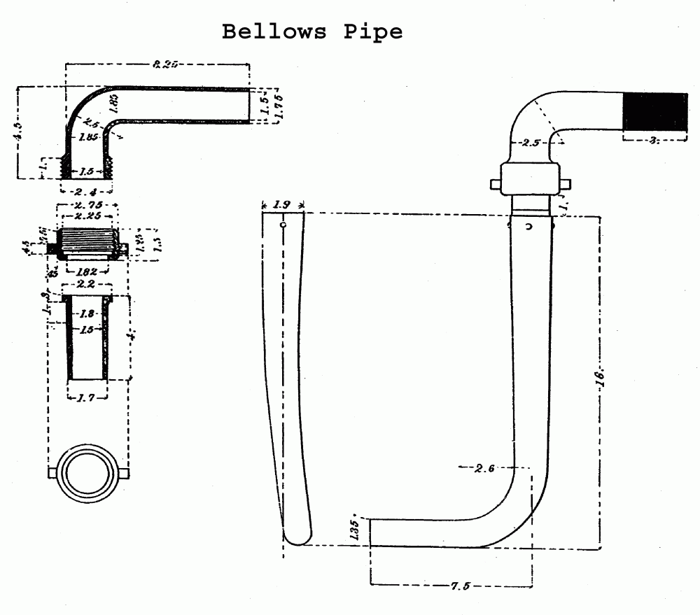

David Einhorn Posted September 25, 2017 Share Posted September 25, 2017 I don't feel young. I'm always happy to help anyone that I can, especially anyone working on gear for historical presentations. As for some corrections, such as casting the brass parts for the pipe and joint is likely to be forever beyond my ability and reach. Having already spent 11 years researching, and four years working at building it averaging 2 hours, 7 days a week, that comes to around three thousand hours of of physical labor. Beyond doing some repairs, rewiring the trailer that hauls it, and a box to support the anvil, that is pretty much my limit of what I can realistically invest in the project. My advice to someone wanting to build one is to purchase the wheels, as that would save them at least 1/4th, or more, of the labor hours. Quote Link to comment Share on other sites More sharing options...

David Einhorn Posted April 12, 2020 Share Posted April 12, 2020 2 hours ago, Reb_Cav said: I am looking to make an actual traveling / Battery forge ...... spend the money on construction and operation than on plans. Antique Ordnance Publishers …. publish reproductions of measured drawings that were provided to manufacturers in the mid-1800s to manufacture Traveling Forges, cannon carriages, and other carriages for the U.S. Army http://gunneyg.info/html/AOPCatalog.htm Quote Link to comment Share on other sites More sharing options...

David Einhorn Posted April 13, 2020 Share Posted April 13, 2020 You are very welcome. Unfortunately, I have never seen a copy of the full plans, for free, on the Internet. The first step in building an authentic Traveling Forge is to spend a few bucks on a paper copy of the plans. That way you can review the blueprints(actually in black ink on white paper) and I can try to answer your questions on the diagrams. Quote Link to comment Share on other sites More sharing options...
