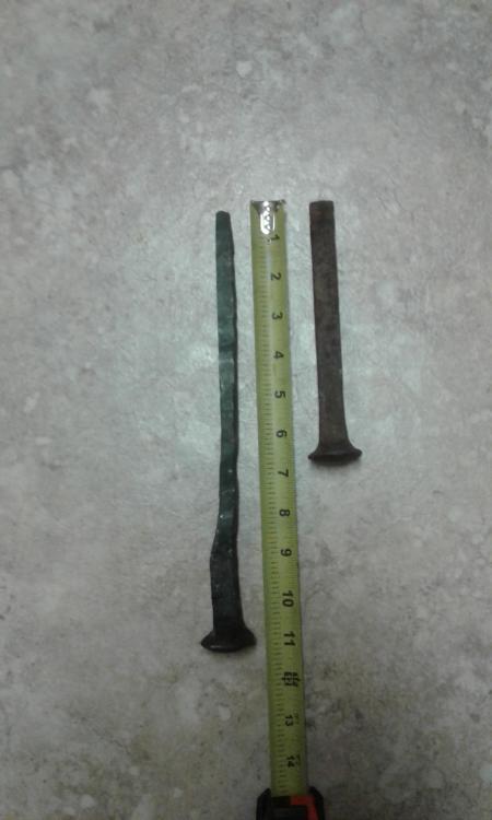

19Branden86 Posted July 12, 2017 Share Posted July 12, 2017 I have a question for you fine craftsmen: My main material, for now anyway, is railroad spikes. Now, before you all start in on me!!! Lol. I can get tons of them for free. (My neighbor is a rail cop so I guess if he's the one giving me buckets of them at a time then there is no need for me to ask legal questions. Lol) But, anyway, I see a lot of neat items made from these. Fire pokers, shovels, Joey Van Der Steeg (TechnicusJoe) makes tongs out of them. My question is, and not just pertaining to railroad spikes, what are some good techniques for drawing out metal? Temperatures ranges? I mean, I see some of this stuff appears to be several feet long, coal rakes, pokers, claimed to be drawn out of one piece, not faggot welded or anything of that nature. How do you do that especially with spikes because I couldn't get one foot out of the last spike I drew out? Thanks fellas! Link to comment Share on other sites More sharing options...
19Branden86 Posted July 12, 2017 Author Share Posted July 12, 2017 P.S. Spike dimensions are 5/8ths square by 6 1/2" HC Link to comment Share on other sites More sharing options...

Joel OF Posted July 14, 2017 Share Posted July 14, 2017 I've seen the odd snippet of videos showing drawing out methods using either quite drastic hammer angles or the corners of anvils, but I wouldn't advise using this method if you're relatively new. It's hard enough as it is to produce a smoothe surfaced and even taper using the flat face of a hammer with on a flat area of an anvil, and to my mind these above mentioned drawing out techniques complicate it by creating many hard lumps and bumps that you have to then very accurately level out. My opinion probably isn't the popular one. In your picture your taper isn't particularly even, there's narrow areas and you can see from the reflective surface that the surface isn't flat. I would just focus on getting the fire and metal up to a nice working temperature (bright yellow) so that it's easier to draw out, and go from there. If you want to reduce surface contact then maybe move over to the bick and use a rounded hammer face (farrier's hammer), then smoothe out any softer lumps and bumps on the flat of the anvil with your flat hammer face. It's taking his advice out of context so he might not thank me for it, but @Alan Evans passed on a great pearl to me via the site a while ago - "do a little to a lot rather than a lot to a little". I find it's far easier to correct mistakes and produce smoothe forgings that way. Once you're completely comfortable with drawing out, then I'd learn the more aggressive methods. Link to comment Share on other sites More sharing options...
JHCC Posted July 14, 2017 Share Posted July 14, 2017 6 hours ago, Joel OF said: I've seen the odd snippet of videos showing drawing out methods using either quite drastic hammer angles or the corners of anvils, but I wouldn't advise using this method if you're relatively new. These methods do require a fair degree of hammer control. Then again, they are also a great way to develop hammer control, as you get immediate feedback on what's working and what's not. 6 hours ago, Joel OF said: "do a little to a lot rather than a lot to a little" Excellent advice. Link to comment Share on other sites More sharing options...
