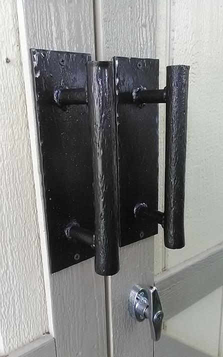

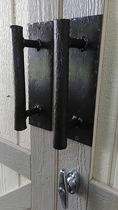

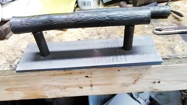

I made a set of tree branch door pulls inspired by Chandler Dickinson on the 4th. I used 1" C.R.S. that was given to me
by a friend. I will be making another set for my brother soon.

Very nice , that gives me an idea that I need a set for my shop
cool!
only thing I would have done differently would have been to use a clear lacquer, I like to see the steel, just think it looks better, but obviously there are people who like the paint too, which is perfectly fine!
                                                                                                                                 Littleblacksmith
Great job. I may try these my self. I enjoy watching Chandler as well
Thanks guys! I finished them with Graphite powder and Olive oil to make a paste. Applied and then buffed off with a cotton cloth. I then gave them 2 coats of clear lacquer.
Just enough to seal and give them a hint of shine which did not show up in the pics. I've never used black paint on my forgings. I really like these on my shop.

Nice pulls, well done. I think I would've broken the edges a bit more those look a little sharp for my taste. That is a matter of taste, not a comment on the craftsmanship.

ooohhh etched wrought iron would have been cool for this.

If I were doing this project I think I would either used tenons into counter sunk holes in the back plate  or plug welded the handles on to the back plate.   That way, no welds would show.
