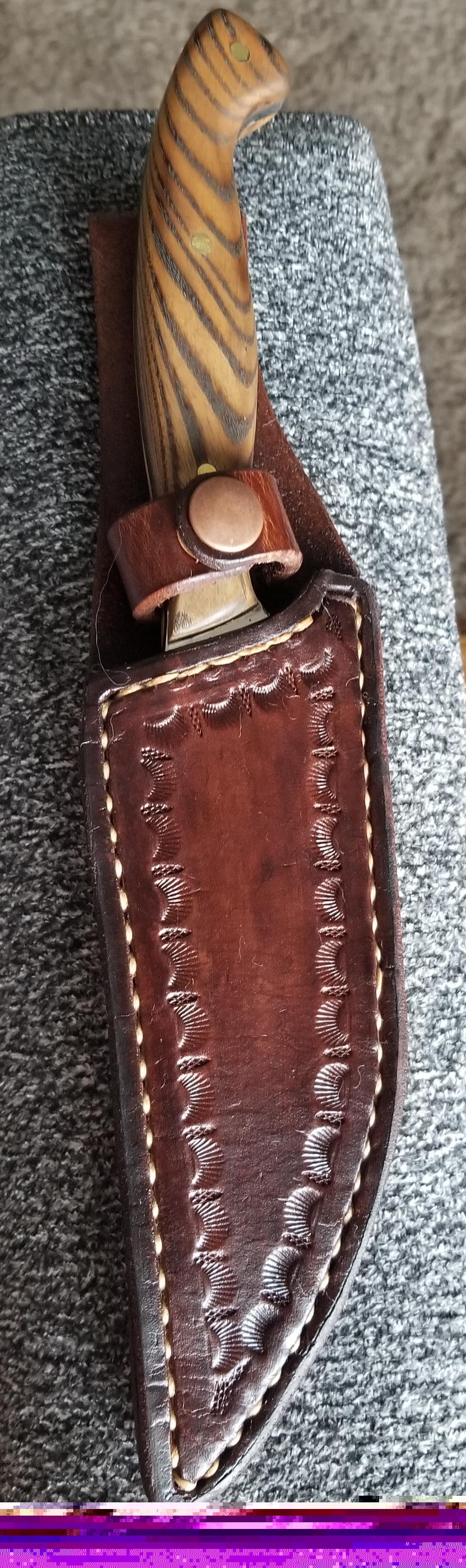

Jack S Posted December 15, 2019 Share Posted December 15, 2019 Hello I've been forging for a little over 3 year and have had alot of success doing canister demascus. I have a set process and never waiver. I clean all the canister can and ends with acetone and rinse with clean water and dry. Use fresh whiteout and dry whiteout until it just doesn't look wet but not powdery. Weld the end caps inside tubing. It will reduce blowout when setting the weld. I also drill a 1/8 cent hole in the side/end of canister. If you don't have a vent hole the canister will expand and my crack the tube. Hope this helped. Note: I also clean and rinse the chain/bandsaw blade pieces with acetone to remove grease and rust and then rinse with Clean water and dry. Quote Link to comment Share on other sites More sharing options...
Frosty Posted December 15, 2019 Share Posted December 15, 2019 It sounds like you have a good method for canister welded billets. I don't know how much help your advice will be though, the preceding post is 2 1/2 years old and Will last visited Iforge 7/23/18. Don't sweat it, I think everybody here has replied to OLD threads and your method is sound. If you're interested in how current a question or discussion is beyond the date of the last post you can click on the person's name or AVATAR and the last date they visited is listed. You didn't REALLY think I remembered the last time Will W. visited the forum or have some kind of secret info source did you? Nice looking blade, do you have pics of it finished? I'm a fan of low layer count high contrast pattern welds. Frosty The Lucky. Quote Link to comment Share on other sites More sharing options...
Irondragon ForgeClay Works Posted December 15, 2019 Share Posted December 15, 2019 When you say weld the end caps inside the tubing, do you mean the end caps sit inside the tubing? Quote Link to comment Share on other sites More sharing options...
Jack S Posted December 16, 2019 Share Posted December 16, 2019 Yes I put the end caps inside the tubing. I use a press to set the welds if I put the caps on the ends they buckle out even more and I loose pressure and end up with delams on the ends of the billet. Just built a new benchtop 25 ton press really helps with demascus. Just finished a nice 208 layer piece for my daughter. Just started making sheaths for my blades. New tools and different skills but adds alot. Quote Link to comment Share on other sites More sharing options...
