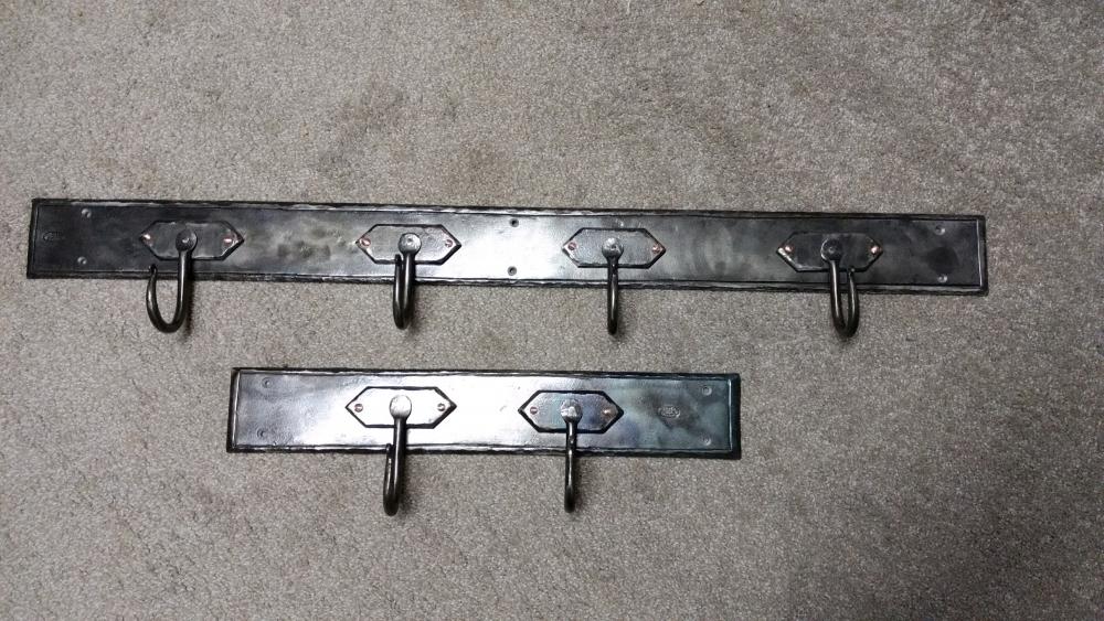

June 29, 20179 yr I have a friend who wants me to make a coat rack for him, he wants 3" wide flat stock to be used...I'm wondering if it would be better one way or the other to get 1/4" thick or 3/16" and also the best way to go about keeping it flat and straight...it's going to be 36" long end to end, and aside from working it in the vise I'm just not sure how to have my finished piece not have some wobble when it's laid on the table. My anvil has slight swayback, it's not a lot but enough that I can't just use my anvil as a guage to see how flat it is/ hammer it back flat Any thoughts appreciated

July 28, 20178 yr Author I got both racks finished up yesterday. The small one is 20" long, and I was laying it flat in the coal forge to heat an entire section up, but it starting twisting pretty badly. After 30 minutes fighting it back flat, I stood the steel straight up in the fire so I would get about a 1"*6" area hot, and just chisel and work one side at a time. This went much better, after the chiseling was done I easily got it back flat with 2-3 blows since I was only working one side, as opposed to heating a section of the 3" wide steel. Also went with Thomas' suggestion and used 1/4" stock, I do agree that it's easier to keep flat than 3/16 (what I'd used for the last one I made)
