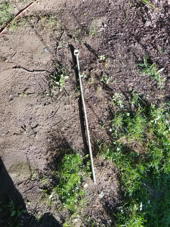

Medic Zack Posted June 14, 2017 Share Posted June 14, 2017 In the scrap pile at the family farm I have found a number of these (see attached picture). By my research, they are double eye guy line anchor rods used to stabilize utility poles. They are obviously galvanize. I am unable to identify any manufacturer. But the comparable one that i have found online state that they are high tensil strength steel. I have not had time to strip one and do a spark test yet. My question is has anyone else ever forged one of these or does anyone have any further information on what type of steel they maybe? Link to comment Share on other sites More sharing options...

Medic Zack Posted June 14, 2017 Author Share Posted June 14, 2017 Well curiosity got the better of me. I had a few minutes before heading to work tonight, so I cut one of the rods and ground the galvanization back enough to do a spark test in the core metal. Here is the result. What do y'all think. Link to comment Share on other sites More sharing options...
Daswulf Posted June 14, 2017 Share Posted June 14, 2017 My guesstimate going off a fairly generalized chart is that it's mild to medium carbon steel. Link to comment Share on other sites More sharing options...
Medic Zack Posted June 14, 2017 Author Share Posted June 14, 2017 That is what I was thinking. Better than the mild steel I have been working with. Not as good as the tool or spring steel I have. Link to comment Share on other sites More sharing options...
