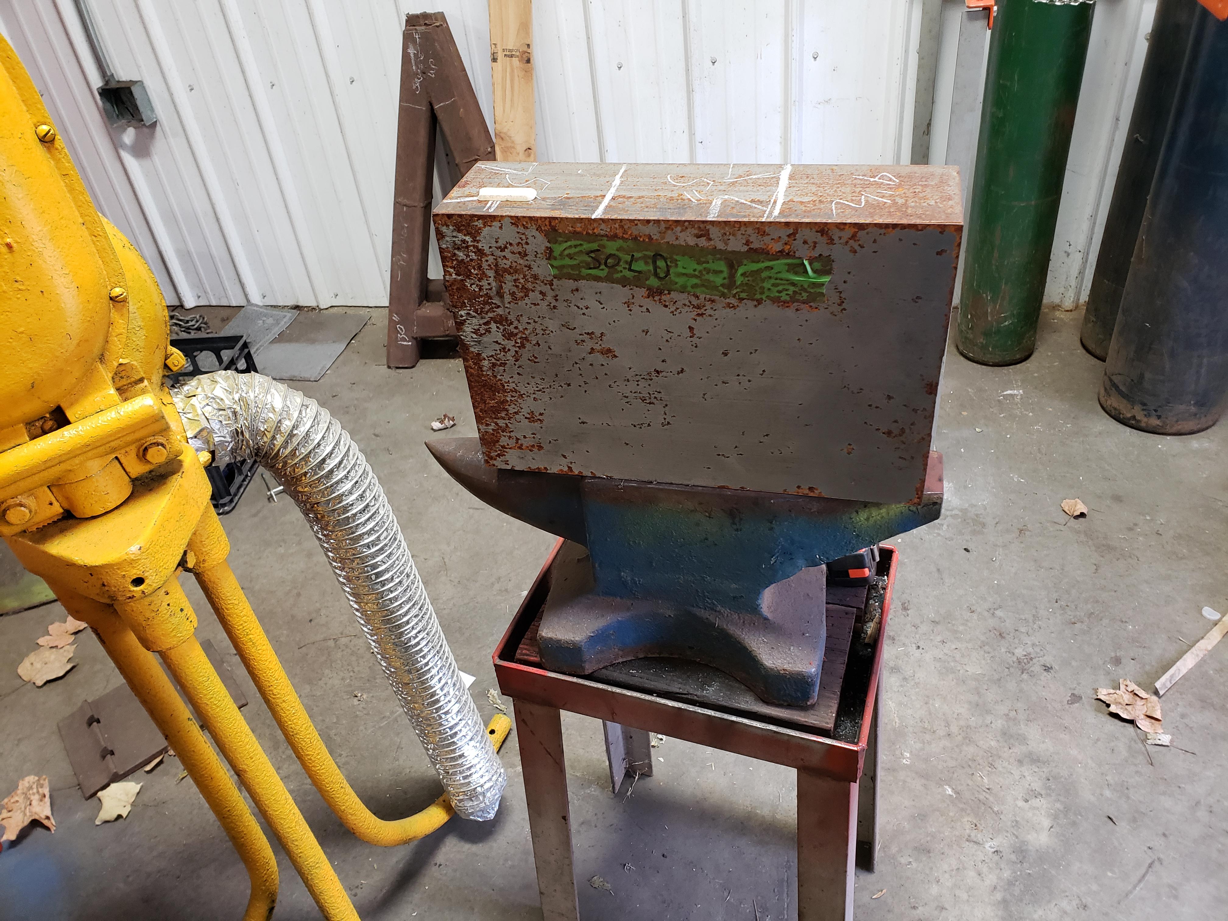

jason0012 Posted December 2, 2019 Author Share Posted December 2, 2019 My die block is in. 4x9x15 4140. Now to cut 5 inch blocks out of it Quote Link to comment Share on other sites More sharing options...

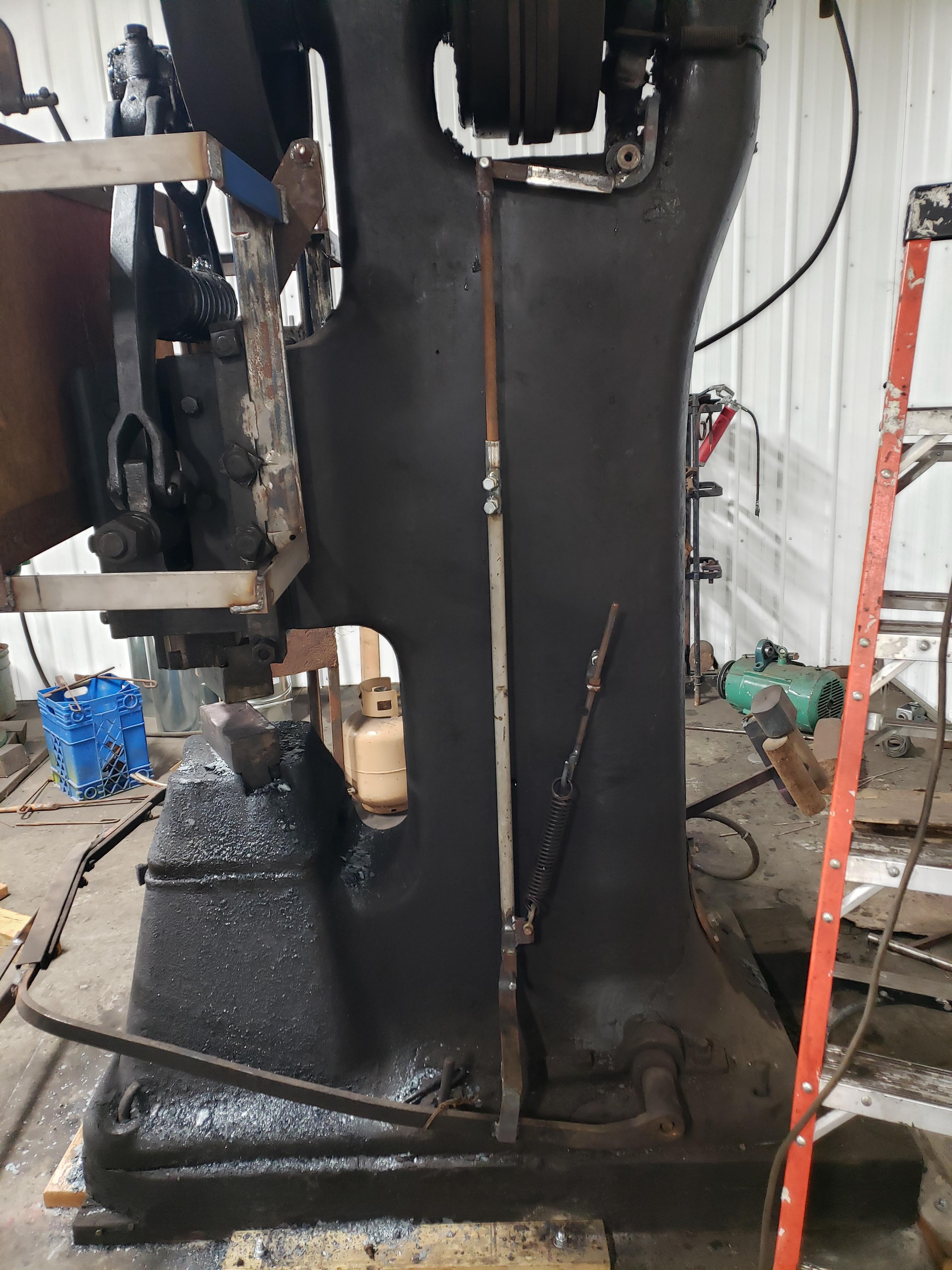

jason0012 Posted January 5, 2020 Author Share Posted January 5, 2020 The latest with my hammer is an upgrade to the clutch. There is virtually no literature on the 250 so I am not sure how common it is, but the clutch tod runs inside the frame. It connects to the treadle by means of an arm on the underside of the frame. Adjusting clutch throw requires getting both arms inside the frame, with wrenches, from underneath. The parts are ancient and well worn and I hate to have turn a 7-9000 pound machine on its side for adjustment. So I added an external rod. The funny thing is, it looks mighty similar to a normal little giant clutch rod. A lot of its funky behavior settled down with this modification. Quote Link to comment Share on other sites More sharing options...

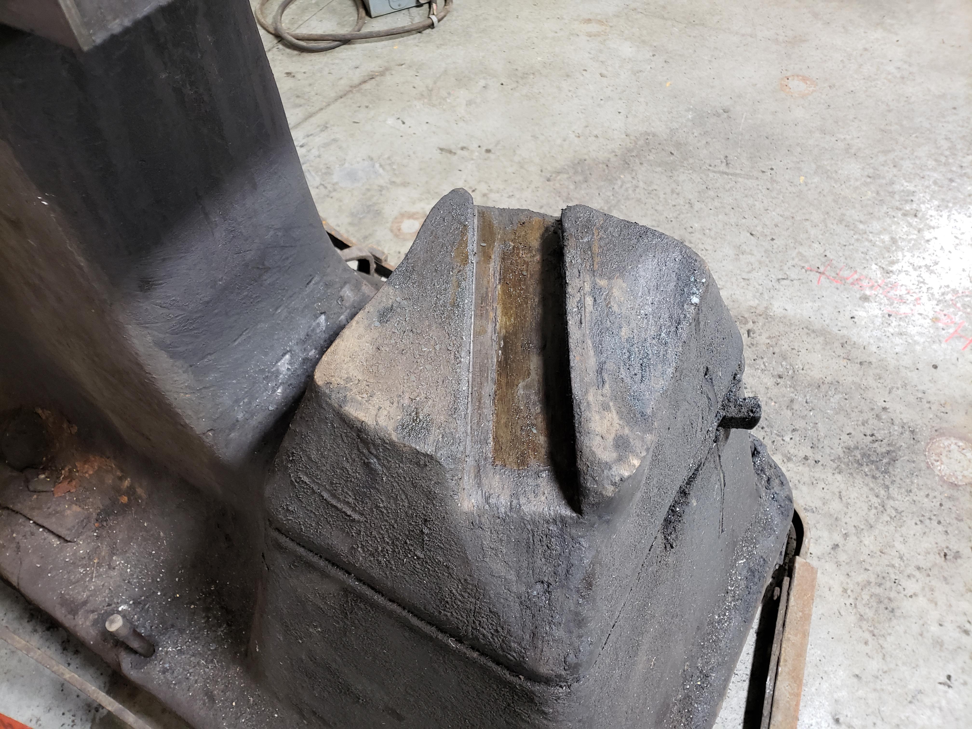

jason0012 Posted May 19, 2022 Author Share Posted May 19, 2022 A question for anyone familiar with 250# little giants. Should there there be a centering pin here? This hammer has none. My dovetails do need some attention but have OK contact with die and key. I still get a tendency for the dies to shake loose from time to time. I am making better keys. But am wondering if I need centering pins. Quote Link to comment Share on other sites More sharing options...
Frosty Posted May 20, 2022 Share Posted May 20, 2022 Jason: I've been watching hoping someone would answer your question but couldn't resist wading through the Little Giant Powerhammer book. I don't see any mention of a centering pin, either in the section about machining new dovetails nor on the parts lists. I'll still be watching to hear from someone who knows more about the beasts. I have a 50lb and haven't been too successful with my dovetails for bolt on interchangeable dies. I had to tack a stop to my male dovetails to align the dies. I'm still not sure what I did wrong but it's a TBI thing and no surprise anymore. <sigh> Frosty The Lucky. Quote Link to comment Share on other sites More sharing options...
Irondragon Forge ClayWorks Posted May 20, 2022 Share Posted May 20, 2022 I had problems with my 30 pound Star dies working loose. I found out the dovetails on the dies were worn almost smooth so the keys wouldn't hold them tight. I reground the dovetail deeper and forged new keys which corrected the problem. Quote Link to comment Share on other sites More sharing options...
jlpservicesinc Posted May 20, 2022 Share Posted May 20, 2022 From what I have seen the centering pins did not exist on nearly all early hammers.. some of the info out there now is there only needs to be 1 dovetail.. The other can be straight.. I don't know how I feel about it, simply because I have no experience with it. Quote Link to comment Share on other sites More sharing options...
Irondragon Forge ClayWorks Posted May 20, 2022 Share Posted May 20, 2022 The Star has only 1 dovetail for each die. I don't know if this from LG will help. 2018-Useful-Information LG.pdf Quote Link to comment Share on other sites More sharing options...
jason0012 Posted May 21, 2022 Author Share Posted May 21, 2022 As far as I am aware the 25 and 50 pound hammers never had them. I have seen them in some 100# hammers ( 2 of them but may have been added by an end user) My Bradley and multiple other Bradley hammers I have gotten to work on did not have them. The beaudrys , Fairbanks and chambersburgs did have them. I am curious if it was an age issue or just a manufacturer quirk. Wondering if it is even worth putting one in, and if so, how big? Quote Link to comment Share on other sites More sharing options...
onetreeforge Posted May 21, 2022 Share Posted May 21, 2022 Thats an interesting looking hammer, is the frame hollow? Quote Link to comment Share on other sites More sharing options...
jason0012 Posted May 21, 2022 Author Share Posted May 21, 2022 Yes. The clutch rod runs inside and is near impossible to adjust without turning the whole machine on its side. As inconvenient as that would be I circumvented it by adding a new external rod. Quote Link to comment Share on other sites More sharing options...
onetreeforge Posted May 24, 2022 Share Posted May 24, 2022 I saw a couple with those beaudry hammers had the same problem, one hammer had a hole hacked in the side. Quote Link to comment Share on other sites More sharing options...

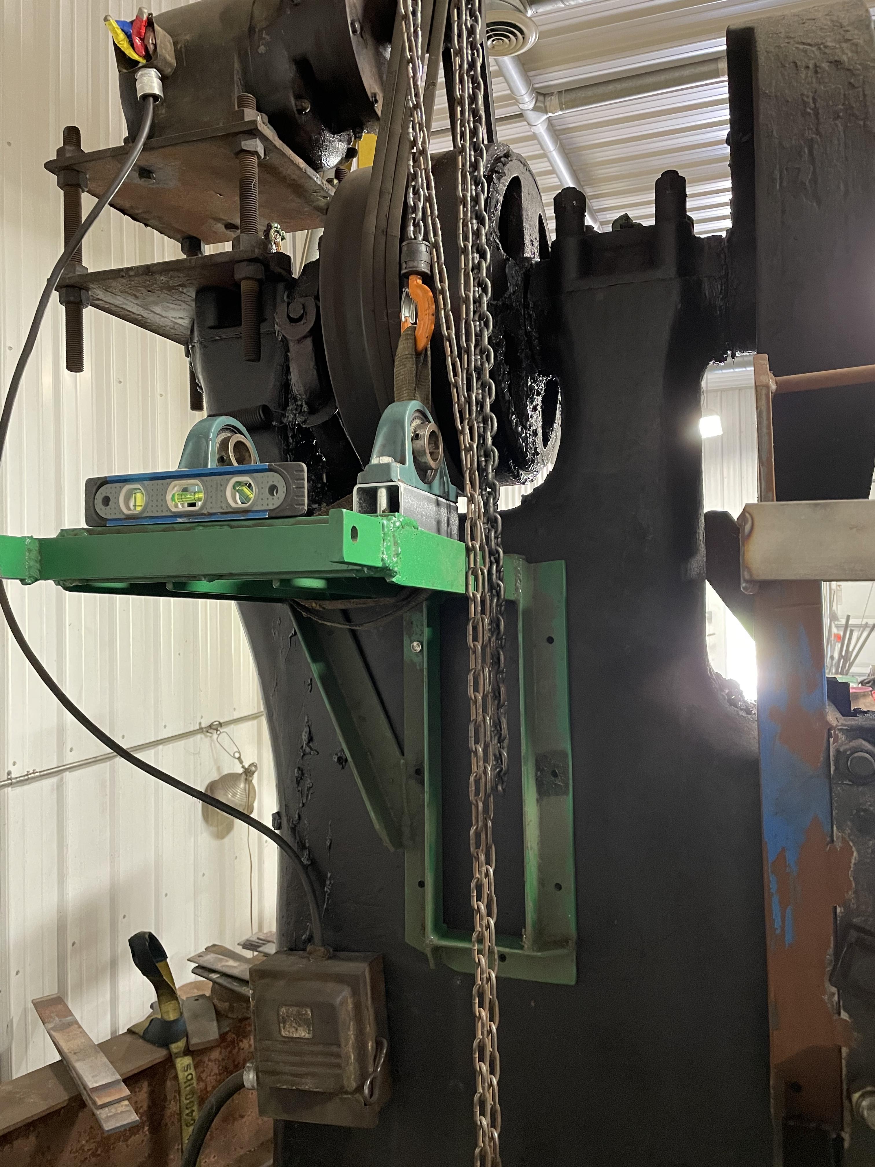

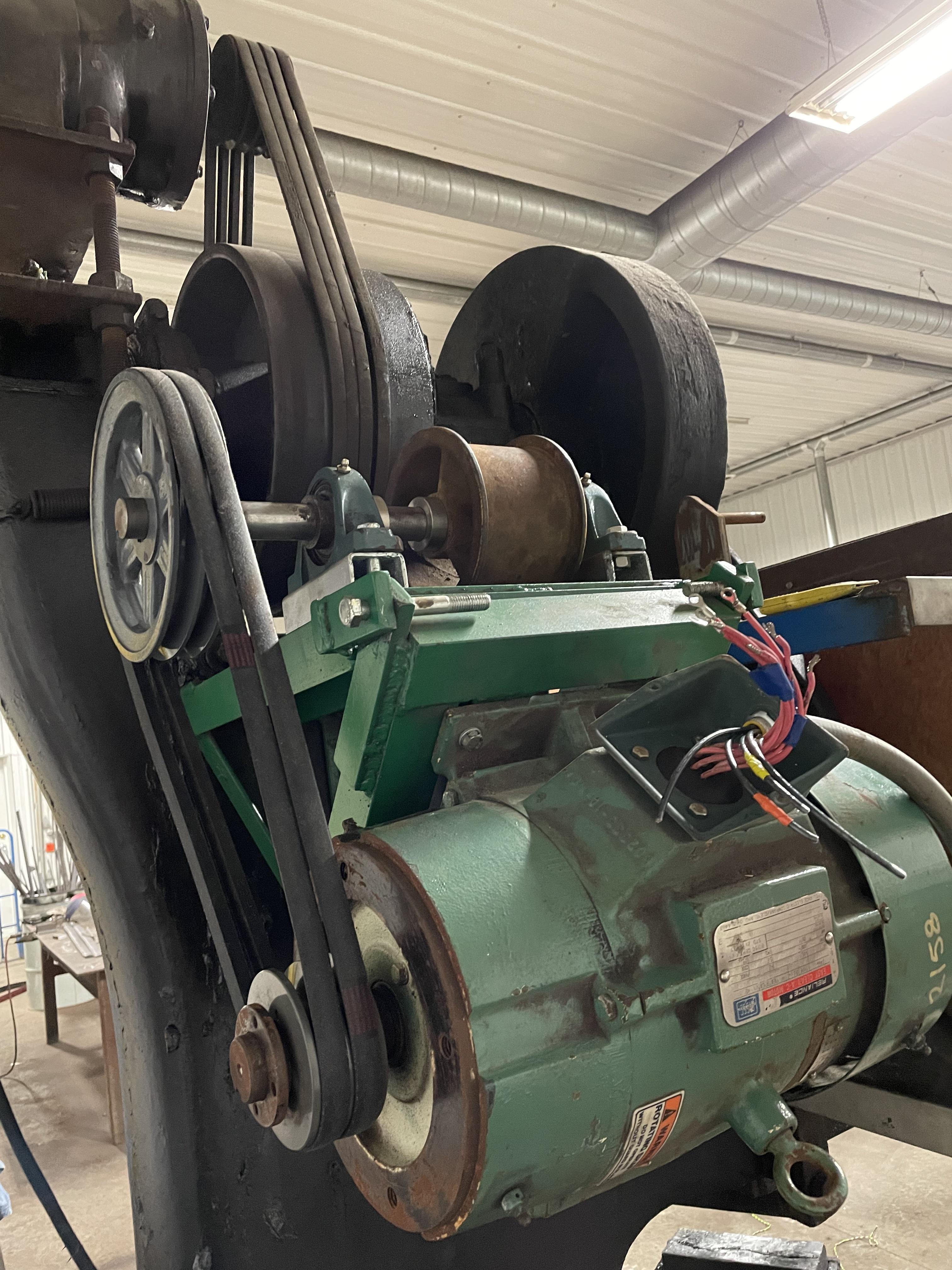

jason0012 Posted July 6, 2022 Author Share Posted July 6, 2022 I got the nameplate off the motor, and it is only 3 hp. It has been running and this motor has been on this hammer for a very long time. I timed it today, and it doesn’t just feel slow, it is slow! 110 bpm is way too slow for this hammer. Doing some math on the gearbox/ pulley/ motor combo and it should be running 210-230bpm. Since the four belts arent slipping, that means I am dragging the motor. That’s not good, and explains why it stalls out so easy. Today I began working on installing the new motor mount. I am shooting for around 220 bpm and the 7.5 hp motor should take the load better Quote Link to comment Share on other sites More sharing options...
Frosty Posted July 6, 2022 Share Posted July 6, 2022 Yeah, it should be more than 2x as happy. Frosty The Lucky. Quote Link to comment Share on other sites More sharing options...
ThomasPowers Posted July 6, 2022 Share Posted July 6, 2022 The LG website says it should run around 150 to 190 BPM and specs an 1155 rpm motor. Quote Link to comment Share on other sites More sharing options...
jason0012 Posted July 19, 2022 Author Share Posted July 19, 2022 Motor in place and wires run. I couldn’t locate my wire strippers and had other items to get to today. I have about an inch of take up in both belts. I would like more but that’s acceptable. I have a proper starter for it, but am half committing to this since it ran with the old motor, albeit slow, and with a lot of stalling. I will wait to take the old one down until I see it run on the 7.5 hp. At that point I will switch over to a proper starter. I am baffled why I didn’t mount this switch here to begin with though… Quote Link to comment Share on other sites More sharing options...
