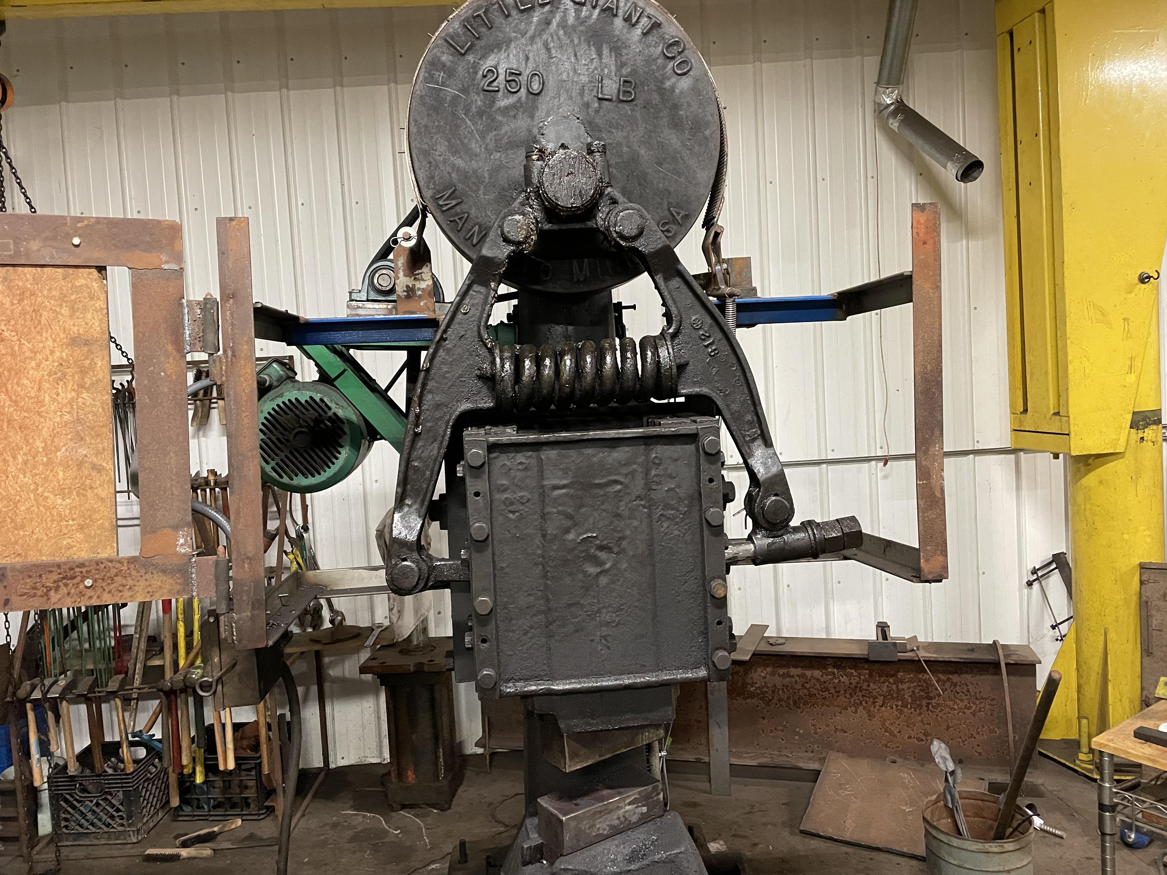

Finished installing the new drive. Hitting about 30% faster and noticeably harder now. No more stalling! It is however doing the little giant dance. A new spring and new pins are definitely in order. The switch was never right by the belts. It was disconnected since the new motor mount is occupying the space where it originally was mounted. The old motor is no longer attached and the switch is on the guard frame- which I should have done originally. I will replace the switch with a proper magnetic starter, but chose to keep it for the time being. It has a worn blade in the contacts that causes starting issues.

It has been almost a month and while the break is an improvement, it seems to have some issues. The clutch doesn’t pick up like most little giants for starters. The motor and jackshaft seem to be working their way loose as it runs. I need to add tensioners to both. The clutch lining, and likely Babbitt are not in top shape and the arms/ pins are pretty worn- all items I need to get to. Thus far it seems that keeping bolts and belts tight and fiddling with clutch/ break engagement makes things better, at least in the short run.

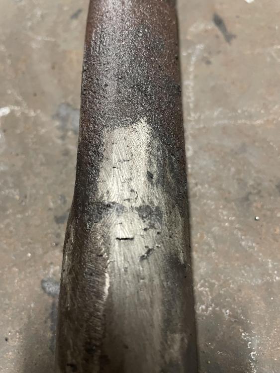

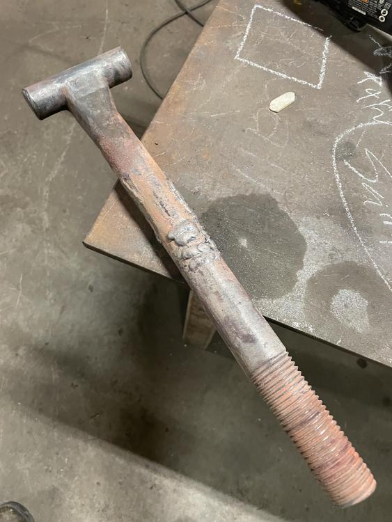

The adjustable arm developed a serious bend. It seems to be smacking the guides occasionally and perhaps this is what happens when it hits stuff that is way too tall. I took it off to straighten it only to find a crack. The link arms are both shop made, and the t bolt is quite a creative part. The t end was a steel bit  cleft welded into the wrought body. I can’t quite tell but it looks like the threads are steel also, but I haven’t identified a seam or weld. The wear on the t end was pretty extreme so I welded a 4140 pin in its place (7018, with heat treat) the wrought body shows a bad crack. Looks like I will be making new arms next week…

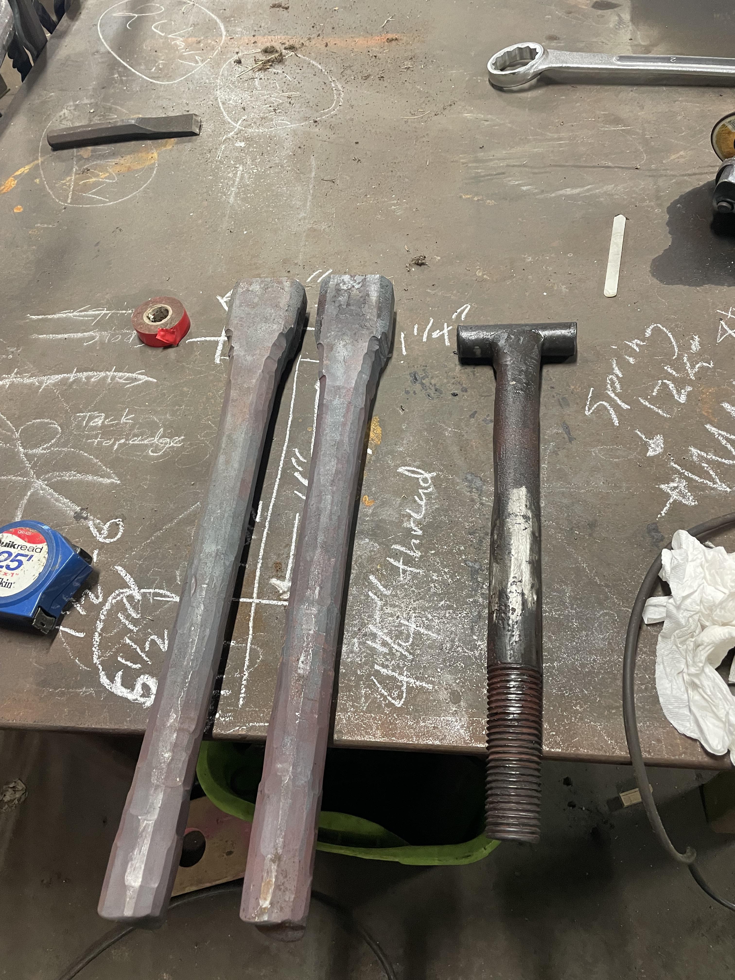

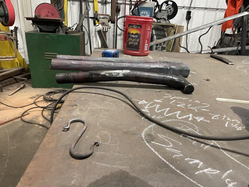

Two pieces of 8640 cut to forge new arms. The old arm straightened v’d deep into the crack into sound metal, then a bit deeper) and filled with 7018. I don’t really trust it but the 2 3/4” round will forge better under the 250 than the 100. An odd aside, I measured the spring, and compared it to factory spec. It is a full coil shorter, and 1/2” by length as well as 1/2” smaller diameter than little giant spec. Probably the original. I ought to replace that as well… I wish I could find my notes on Clifton’s springs. He went oversize on his and had a place that custom wound them for him. Anybody have that info?
Did you fish plate the upper arm welds? When repairing breaks or cracks like you describe the difference between welding rod and base metal cause conducted forces to concentrate at the edges of the weld. That's why welds break right next to the bead, it's not a matter of the weld being stronger it's a basic physics thing that requires heat treatment to mitigate. Orrrrr, you can distribute the conducted force over a large area that doesn't include the weld.
I'm sure you've noticed the diamond shaped plates welded over welds on structural members. If you take a closer look you'll notice many if not most are thinner than the member and offer little real reinforcement. What they do it conduct stress over a longer section of the parent shape. The taper and relatively sharp point is important as the forces dissipate over an area many times larger than the weld and becomes consistently more flexible until it reaches the pointed end. If you look closely you'll see the weld beads (On serious stress bearing shapes anyway) end with a little curl or swirl.
All that serves one purpose, it leaves imparted forces no single place it can concentrate to become stress.
Fish plating a long narrow member can be as simple as a pointy cigar shape. There is a rule of thumb I don't recall clearly but the fish plate extends 3x the weld length on each side of it.
The thing that occurred to me first was. Is it necessary to be round bar? Will (to pick a number) 3" x 1.2" rectangular bar work? It'd certainly be easier to make and WAY strong. Even plain old A-36 is tremendously strong, far stronger than the original upper arms.
Hmmm?

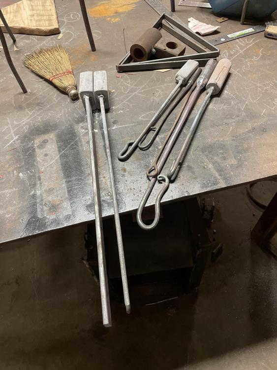

These were some heavy chunks…the 2 3/4” round knocked down to 3 1/4x1 1/2, then drawn to 1 1/2”square, rounded, straightened and cooling. Turning and threading these is going to be a trick, my small lathe isn’t up to it and I still haven’t worked out the thread gears for my 1880s lathe…but that adventure is for another day

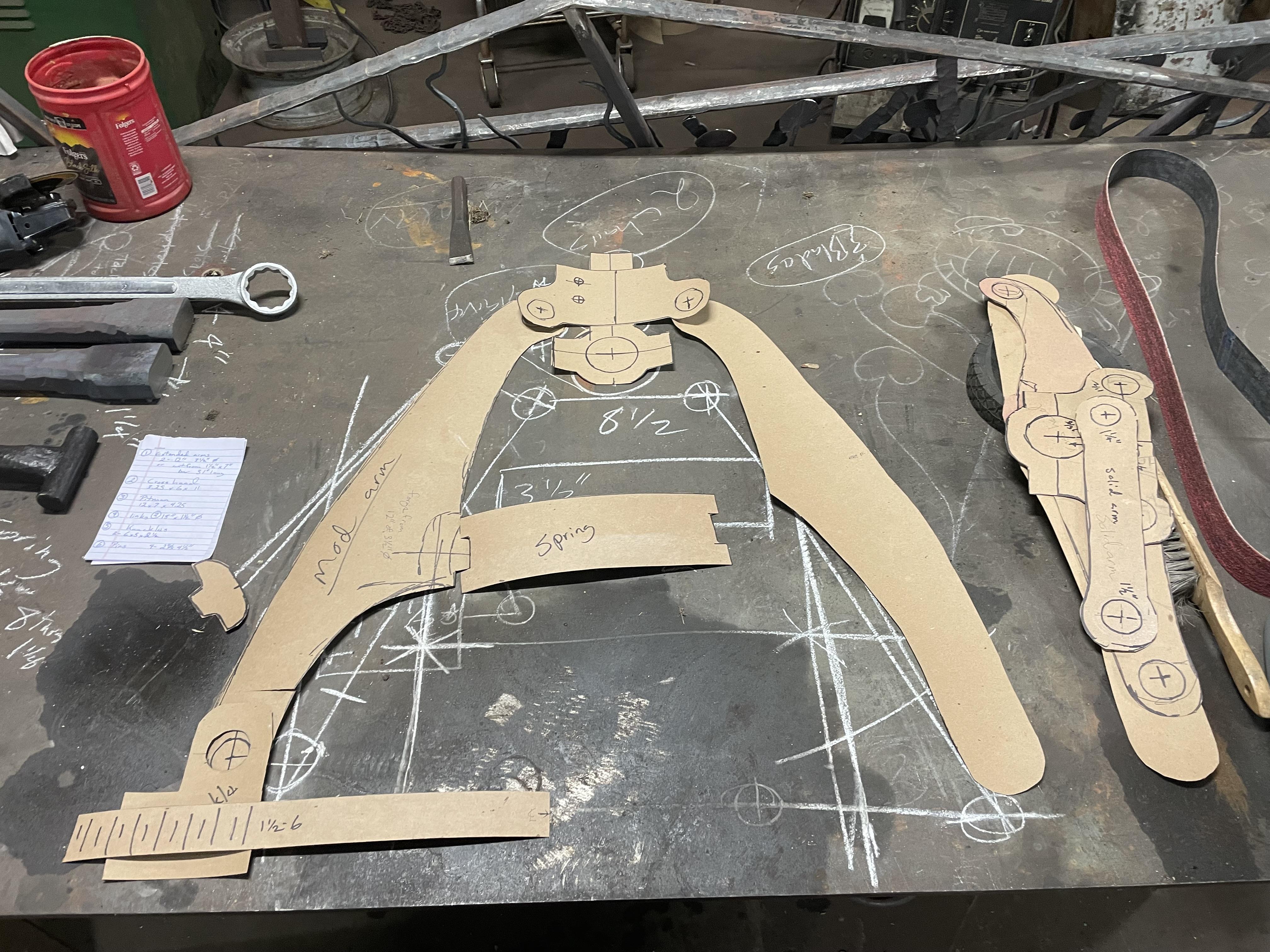

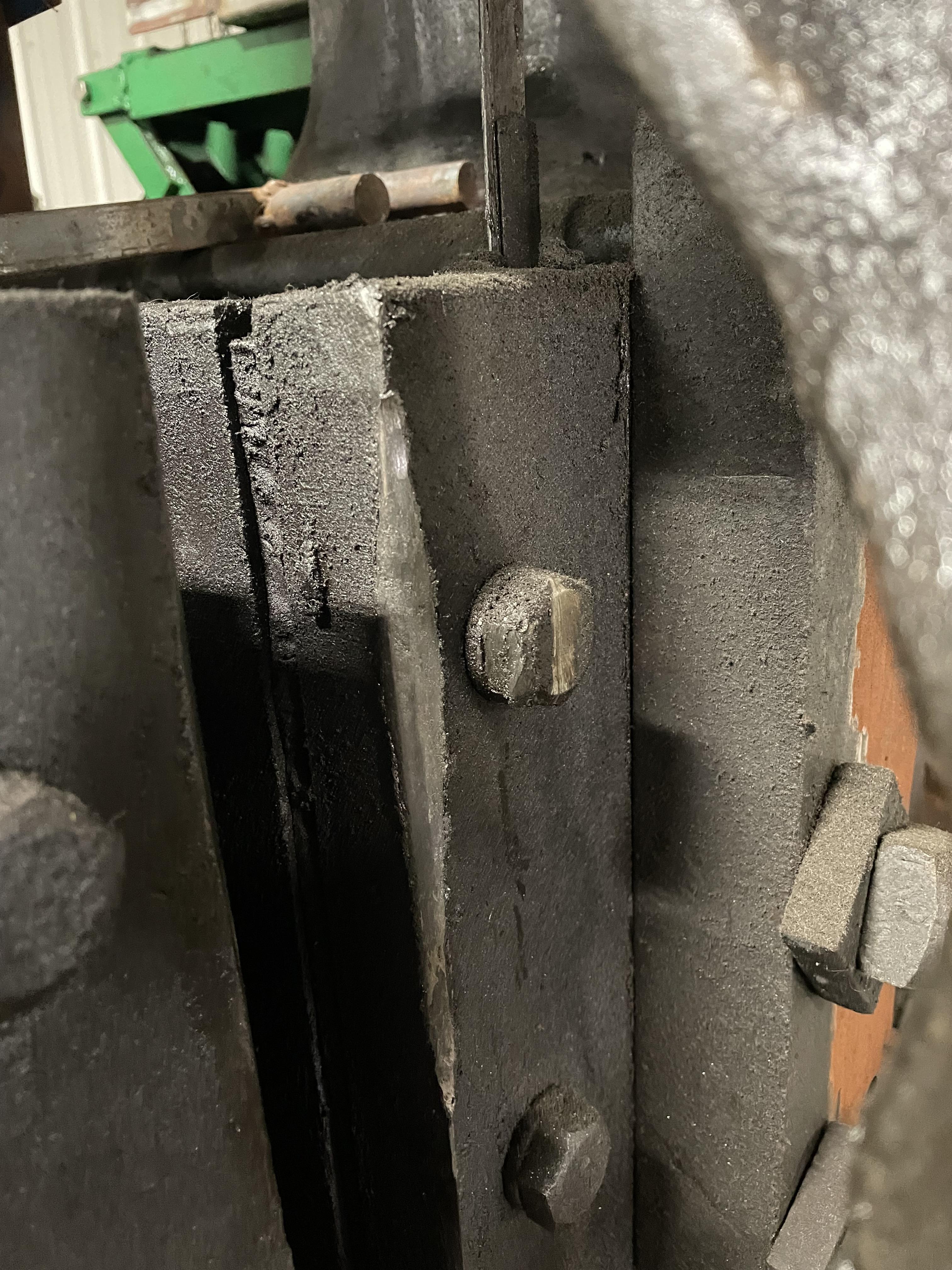

I am not going to try to straighten this a second time, or risk running with the cracks. It’s not as bad this time. I have been running this hammer pretty sparingly knowing about the arms problems. The replacements got set aside, I should have pushed through and at least gotten the T end forged. I have worked out the threading gears for the big lathe. I don’t think my little atlas could handle the weight of these arms. I am concerned about the impacts I am getting, which may well be the cause of the problem. The knuckle is contacting the guide from time to time. It is noticeable when this happens. I would like to get a new spring, and ideally find one a tad longer. That might help a bit. I know Clifton had springs custom wound somewhere ( pretty sure it was in Chicago) but I can’t find it in my notes. Nor can I find the dimensions he settled on. Does anyone know? Trying to google spring makers gets me a million places that make ball point pen scale springs… none of them seem to play in the league of hot wound springs from 1 1/8”+ wire…

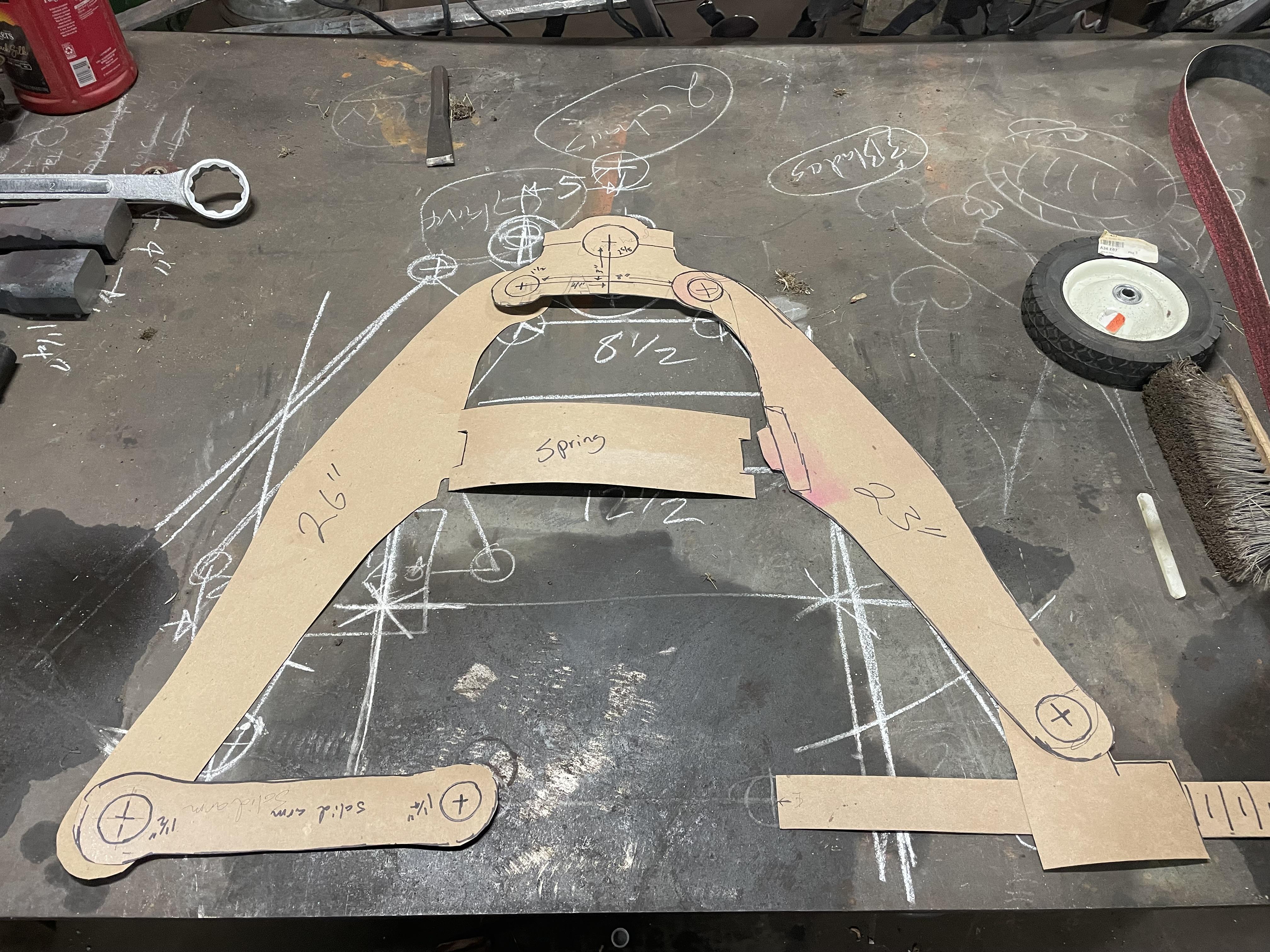

Doing a mock up on the table, I discovered that the long arms are different lengths. The arm to the would link is 26” pin to pin while the adjustable side is 23. Weird..
I think I have an arrangement worked out that allows vertical adjustment. I don’t have the time or materials to really play with this much now, but I do have templates for all the old components plus a few variations. Now if I can only locate a 14” spring… I know there are actually important things I should be doing right now though

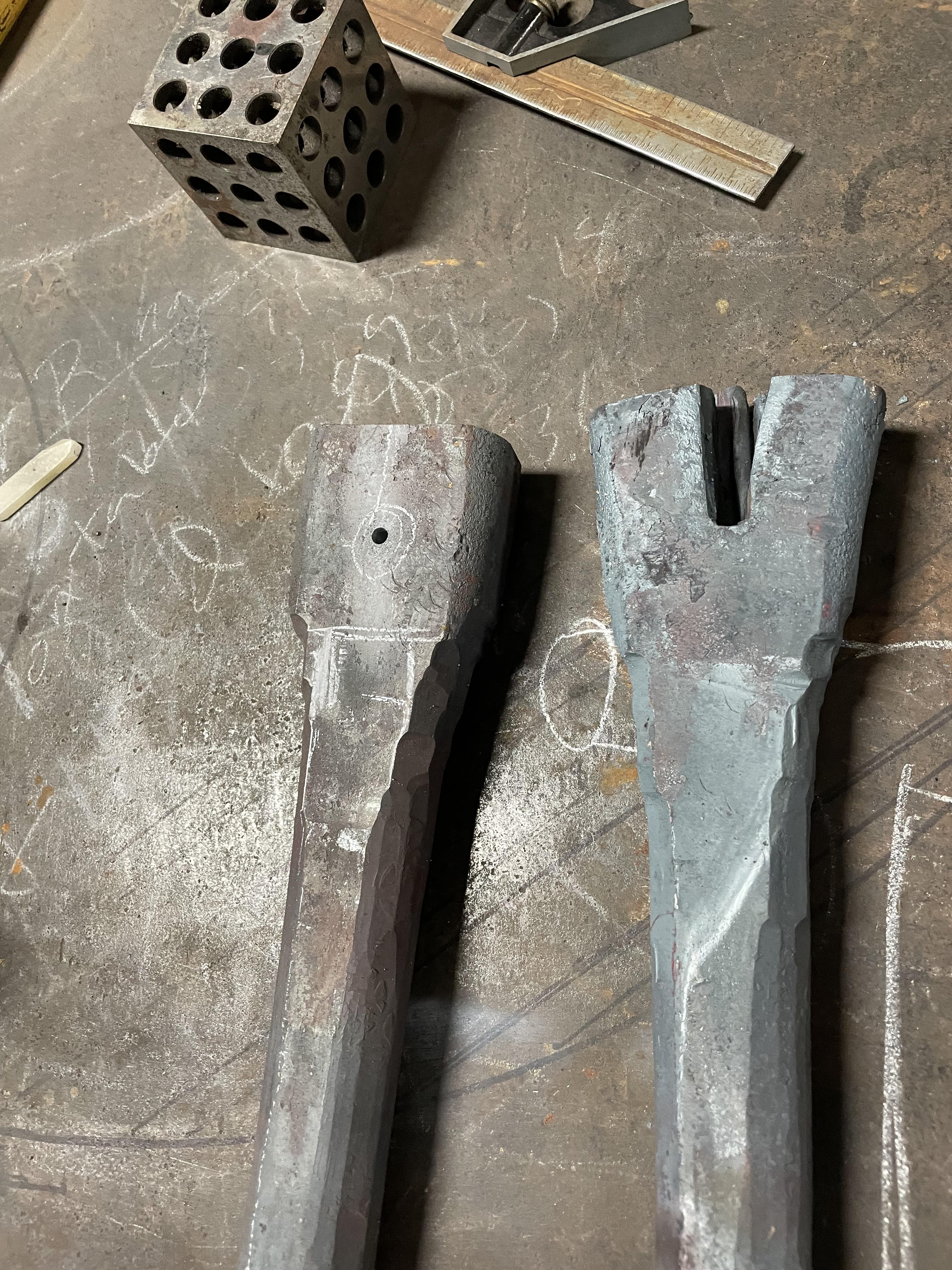

Gotta make some tools to make new arms… I had blanks roughed out from a while back, but they fell by the wayside. I need swages and blocks to do the forging and the Bradley isn’t up to it. The arm straightened, ground clean, grooved out, welded up and annealed. Ground back round and put back in the hammer. I aim to have new arms in the lathe for threading by the weekend.

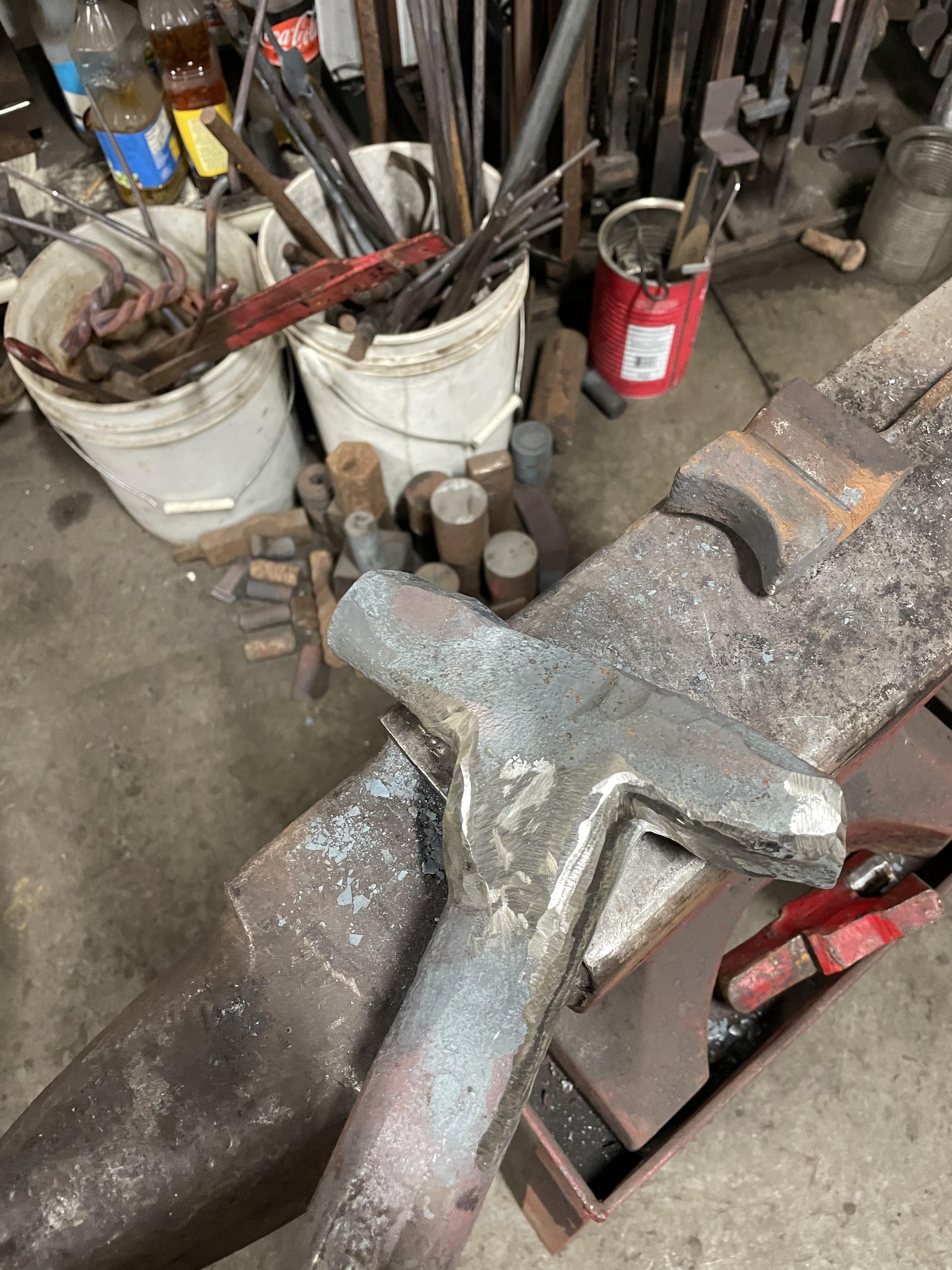

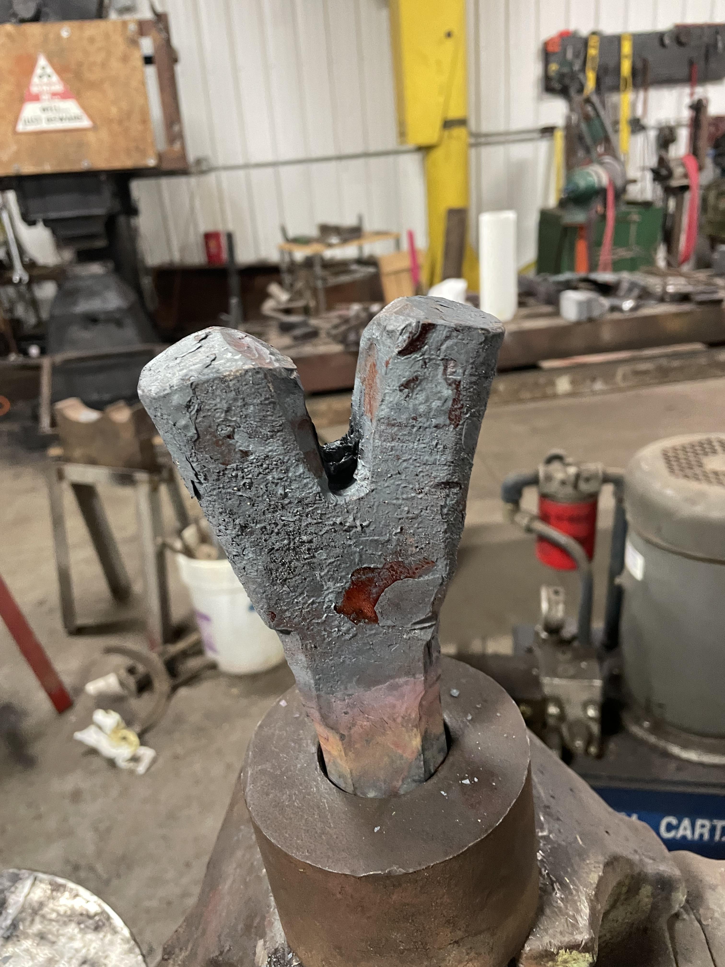

Trying to take it easy on the gimpy arm, but the Bradley just is not the hammer the 250 is. I split one of the new t bolts. I need to clean out the rag before opening it up. It is not the easiest thing to handle with 4 foot tongs. Both the part and tongs are kind of a handful
  • 4 weeks later...
I tried spreading the arm single handed, and was just not able to handle such a big part by myself. Took it to the local blacksmith meeting and the BFH helped me get it spread out. Not quite to finished shape and I hear Clifton giving me hell for not doing it under the power hammer. The remaining shape is easy enough to get on the hammer and there is a lot of extra material to forge down.
