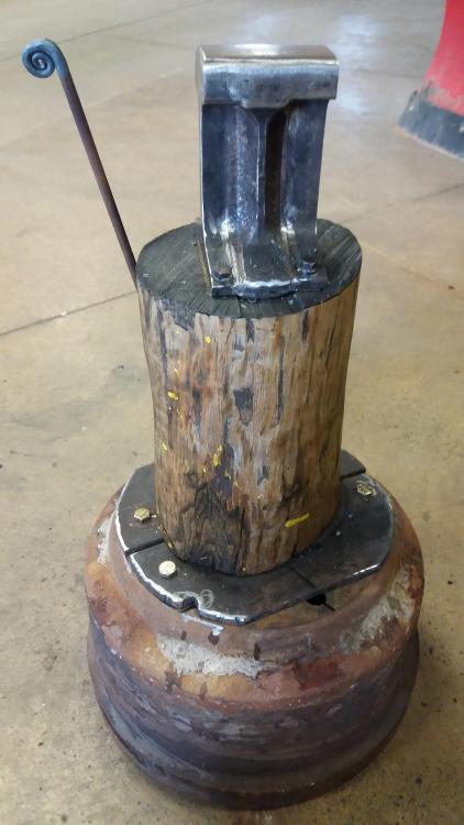

April 14, 20179 yr This is how i mount anvils. The size of the log will change in relation to the anvil. But the theory is same. I can roll around a very heavy anvil. The base is a brake drum. 16.5 inch dia. 11-1/4" tall. The flange is 14" dia. Just mounted this RR Track makeshift anvil for a specific purpose.
