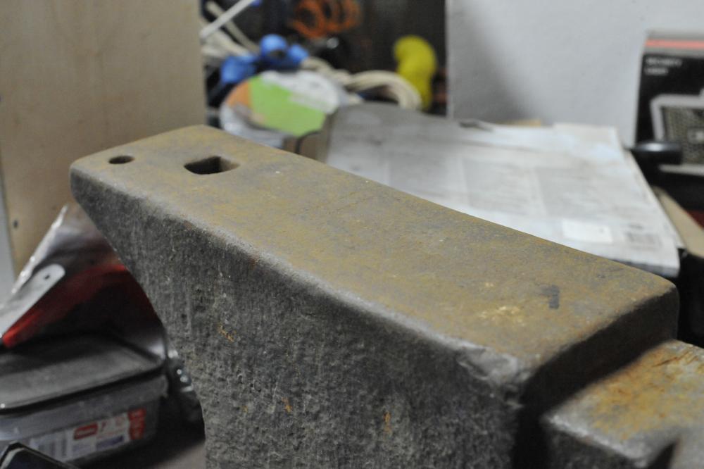

Many thanks for all the comments so far, so the general jist is, to clean it up, but don't grind or resurface, leave it be, work with it, then see how I go after a year or so. Out of curiosity, nothing more, what's your opinion on hard facing rods, you know to say build up the surface etc... I'm only interested in opinions here, I'm going with your advice, just a question that's all. -

Ah, ok, so just leave it as is, work with and see how I feel after a year. Hey I'm happy with that. What about giving it a good wire brushing? You know clean all that crap off it. Anyway, more pics as promised -

I can't see any stamping on it, that's not say there aren't any under the paint. I was checking out a few Youtube vids on refurbing an anvil, and one of them was a Peter Wright, as soon as I clocked it I ran out to the shop. To check, and well ya buggerman, it might just be. Also quickly put a rule over it, the top's going to need some work, about three dips that'll need grinding out. Nothing too dramatic. I'll sort out some better pics later this evening. -

I've not been on for a few weeks, just got a lot on at home at the moment, building works etc. Anyway, Finally got an anvil today. It was my uncles, didn't know he had it, well he was more than happy for me to have it. He'd rather I had it and used it than it sit his shed for another 20 years or more. The only problem was, it was over 1600 miles away in the North East of England, and I am in Southern Portugal. After a lengthy journey in the back of my parents car, it's finally here. It's a good 60kg, possibly 70kg. I don't think it's much more than that as i was able to lift it on my own out of the car, and on to a sack trolley. Now I just need to make a base for it, and clean it up, which, any comments or suggestions would be most gratefully received. Anyway, I'll post more pictures as I go, as well as the forge build and making of my tools. But, it's coming together now
