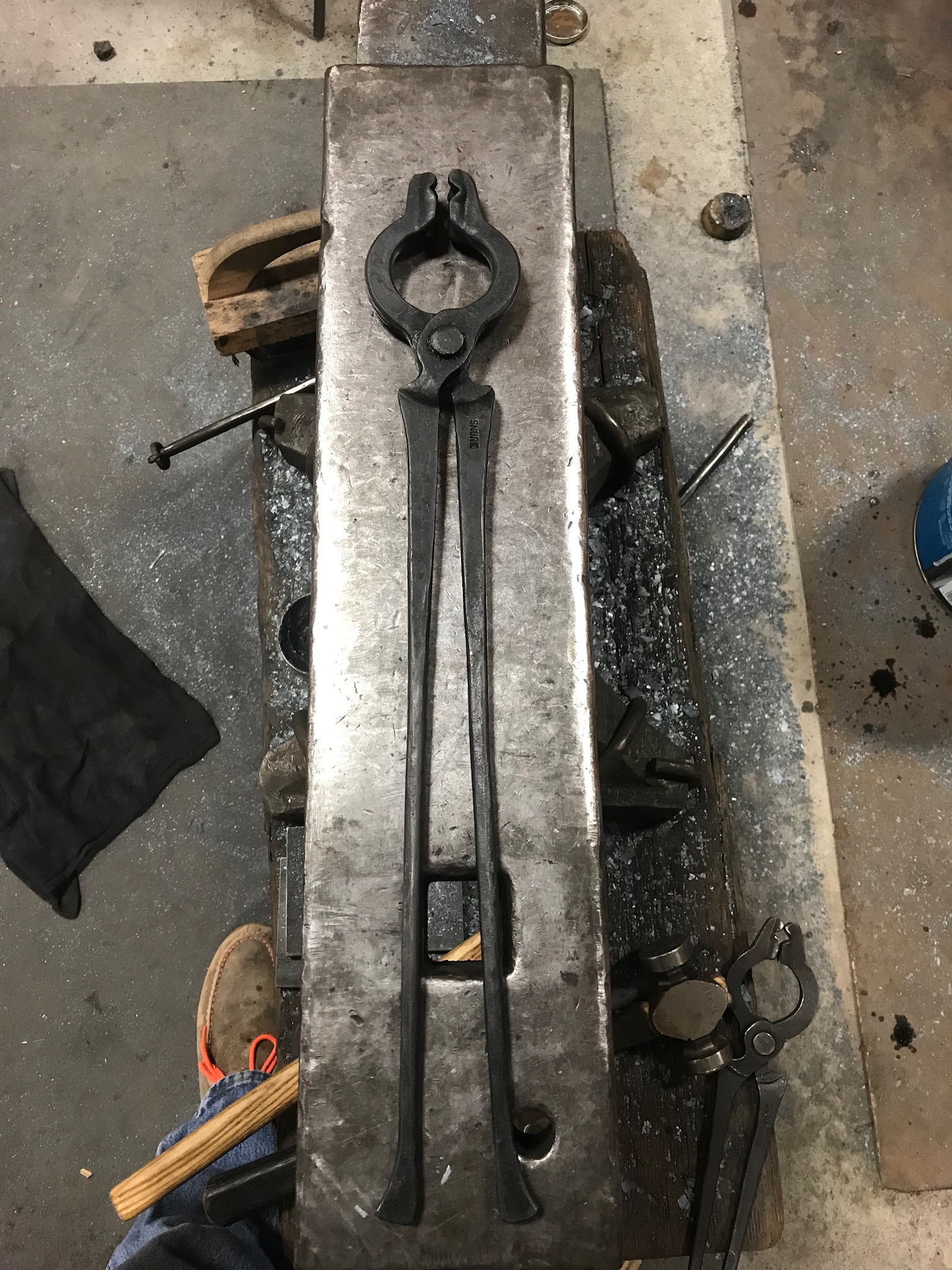

The bosses might not be as isolated as others but that's a fine set of tongs. It's good that you are adding in some of things that set apart good pair tongs from a pair of tong. The flaired out reins and the jaws with a perpendicular groove are great additions. Keep working on insolating the boss and you might also want to use more material for your rivet. When you get to the point you are it becomes about working on refining each part, jaws, boss and reins. You learn something from every pair and every pair gets better.

Looks to me like you have it nicely figured out now.. And I do agree they are sharp looking..  In the way back I used to use that style of tong and find them to be very pliable with just the right amount of spring in the jaw/to handle boss where it it thins just behind the pivot..
Really nice job..   I have to confess I'm lazy when making tongs now and for a lot of them I don't even bother with the offset to re align the handles behind the pivot.. I just shove the handles in line where my hand goes.. LOL and call them done..
Great work and love seeing the progress..
How long does it take you to pound out a set of bolt tongs now???
Jim Poor was one of the first guys to produce tongs in that style in the way back.. I"m sure there were others but a pair of his tongs were the first I had seen that way..

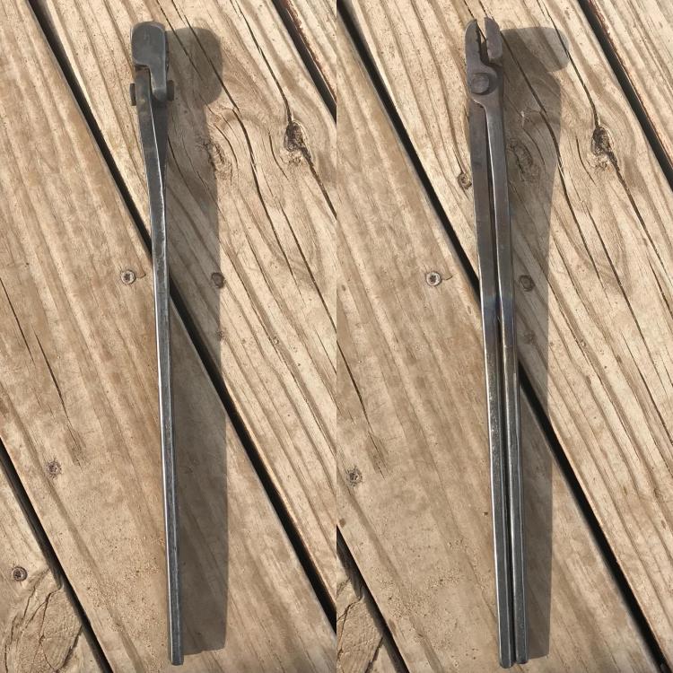

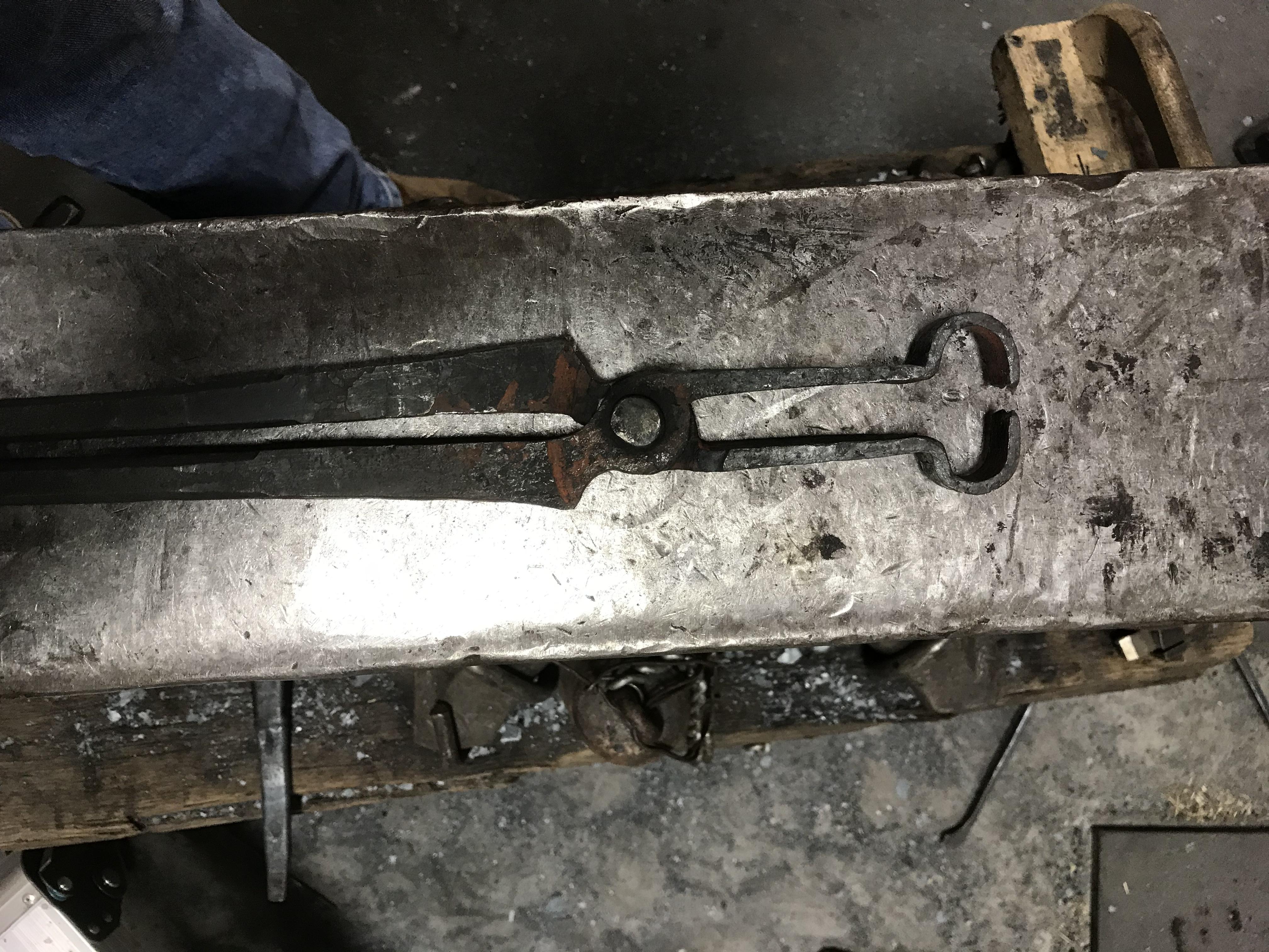

Finished up a set of redesigned bolt tongs. I’m not really happy with how they turned out but I know what to fix on the next pair.
neat design, Similar to Haberman's tongs. ha, that center punch looks familiar.:)
                                                                                                                                      Littleblacksmith
Thanks Mark. It’s sort of a modified Haberman style that’s going to get modified even more. That center punch was a gift from a talented smith who’s a fellow Texan. Gets used constantly!

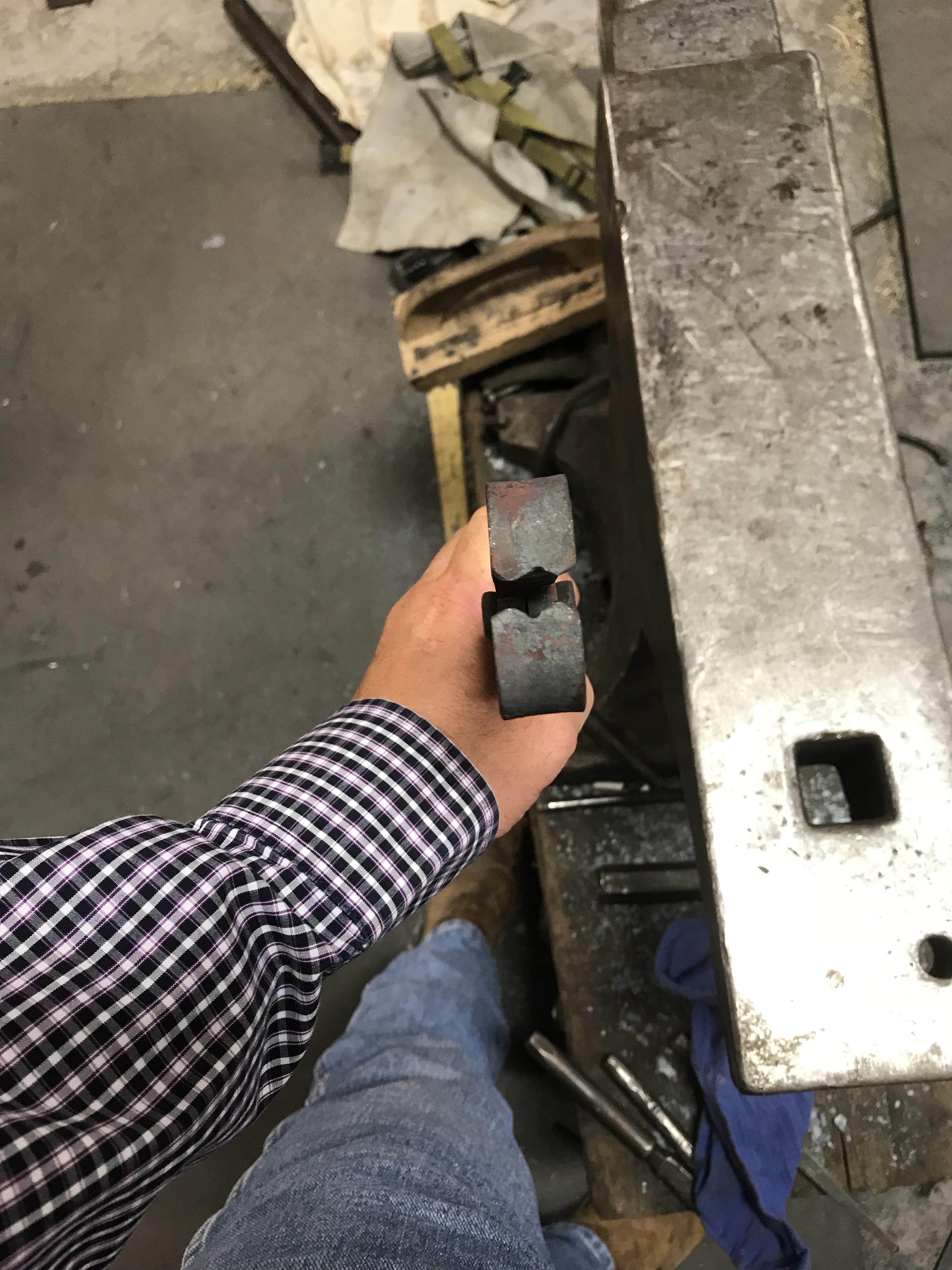

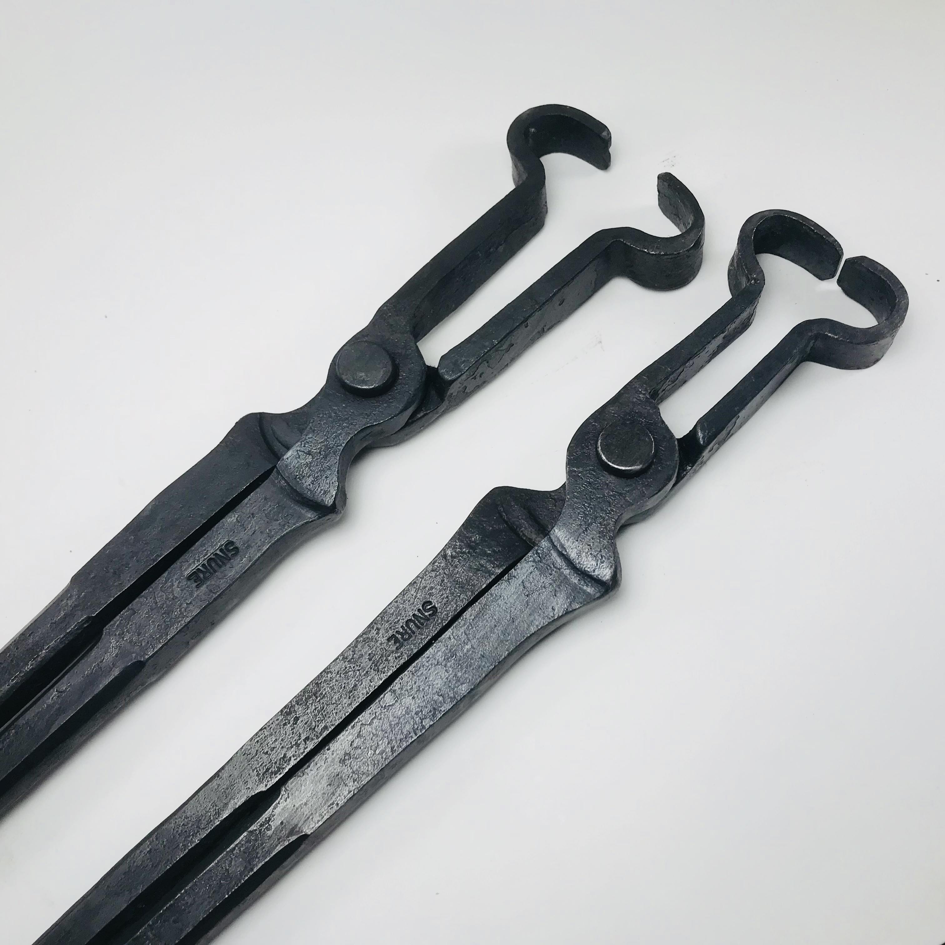

Its a style of tongs I’d seen other people on Instagram use for holding larger stock, 2-3” round, under the power hammer or the press. I built a pair and I don’t know if I could ever go back to hammer eye tongs. I built those two pair for another smith, the gapped our set is for 2-3” and the tighter set is for 1-2 inchish. They seem to work well because there’s always three points of contact on the work material. Here’s the first and only set I’ve built for myself.

Just twitting you a little Ben, I like your tongs, they appear to be strong where needed and reasonably light, sucker rod is a good material for tongs.
You make MUCH nicer tongs than I do, I seem to have about everything I need so my tong making skill levels have stagnated at sort of adequate if I gotta make a pair.
