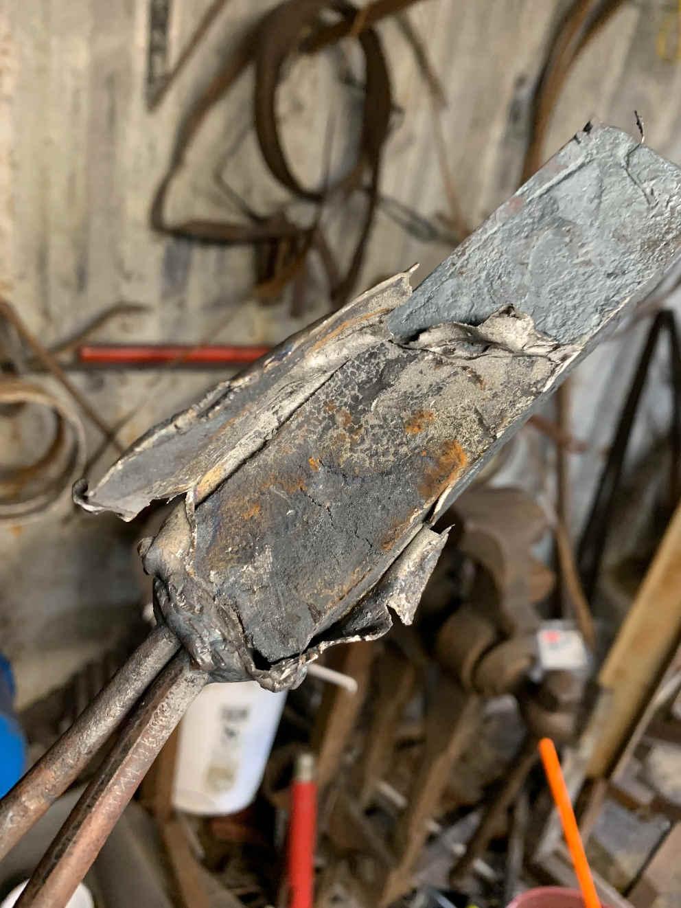

Doc - I haven't seen that yet. I'm not sure my little 15 kw unit can do that.
I got some more of the canister off. There is a spot in the middle that I can't decide if it was a void in the powder, was under cooked or overcooked. I suspect overcooked since the middle would have gotten the hottest as I moved it through the coils. I also think that is why the canister is so hard to remove. The places that are easy were some of the places with the least heat. Once I'm done cleaning the outside I'm going to cut it in half through that bad spot and weld the two pieces together. If I was a real artist I would cut it all up in cross section and restack and weld with the ends of the cable visible in the sides. I still don't know if the interior is solid yet, though. Besides, I didn't make a large enough billet to lose that much.  The idea is intriguing. After the fish hook knife I may have to try that.
OK, my billet is a bust. It fulfilled its primary function in that I am now confident I can solidify metal in a cannister using my induction forge. Once again material selection has latched its teeth to my posterior. The cable was rusty, but not all THAT rusty, just enough to hide the fact that it was galvanized. It had been probably been laying around for twenty or thirty years. The thing that should have clued me was the lack of grease. I figured the grease had all worn off, but if that were the case it should have been more rusty. I soaked the cable in diesel and then burned it off with a torch. That usually gets rid of most of the grease but it doesn't get it hot enough to burn off the zinc that remained on the inside. When I heated the cannister I did notice a strange blue flame coming out of my vent holes, but since this was my first canister billet I didn't know if that was normal. Fortunately, my ventilation system worked well and I suffered no ill effects.
What I produced is solid, but I don't trust whatever resultant alloy it now is. It seems prone to crack. I can work it and can heat it to welding heat after removing the canister so in my mind, the question is answered. Next step - the fish hook knife.

I don't know much about induction forges other than really enjoyed using one some time ago. I don't know why the center of the billet would get hottest.
I understand why yours didn't set in the center but I do not get the center should have gotten hotter than the outside.
Frosty - I shouldn't have said "center," I should have said "middle". As the canister heats I move it back and forth through the coil, heating the middle more than the ends.

Well, I THOUGHT I had a well-formed billet. Yesterday I started to heat it up and was treated to multiple geysers of smoke and flame coming out of my billet. I started heating back up to welding heat and was treated to the same kind of pyrotechnics you see doing a normal weld; a nice shower of sparks in response to my hammer's caress. Is this normal for a canister produced billet?
My billet is becoming much smaller than I thought so I changed coils to a smaller coil. I got the ends pretty well consolidated, but I found several severe cracks and broke the billet near the middle after a heat to try to consolidate.
Here is what I think happened: First, obviously only the outside of the billet was welded. The inside was not. I don't think this is much of a problem because you can just reheat the billet and finish welding. However, when the geysers started, the smoke smelled very much like the smell from the fish hooks after I soaked them in paint remover, then burned off the excess. Perhaps not all the lacquer or varnish was removed. Secondly, I did not pack the hooks evenly. I started with adding powder and hooks, but when I saw that I would have hooks left over I tried to really pack them in. I may have created areas that the powder couldn't get into and left voids. Areas that had my initial pack solidified very well, while areas that had bunches of hooks cracked.
What's next? I'm thinking of breaking it up everywhere I see a crack, solidify each piece individually, put a long scarf on them and try to reweld them in the induction forge. I may also weld a piece of 1060 for the tang as my original billet is getting much smaller.

You may have to do a more thorough job of stripping the chrome from the hooks. Chrome isn't fond of forge welding to itself unless you get it REALLY hot.
