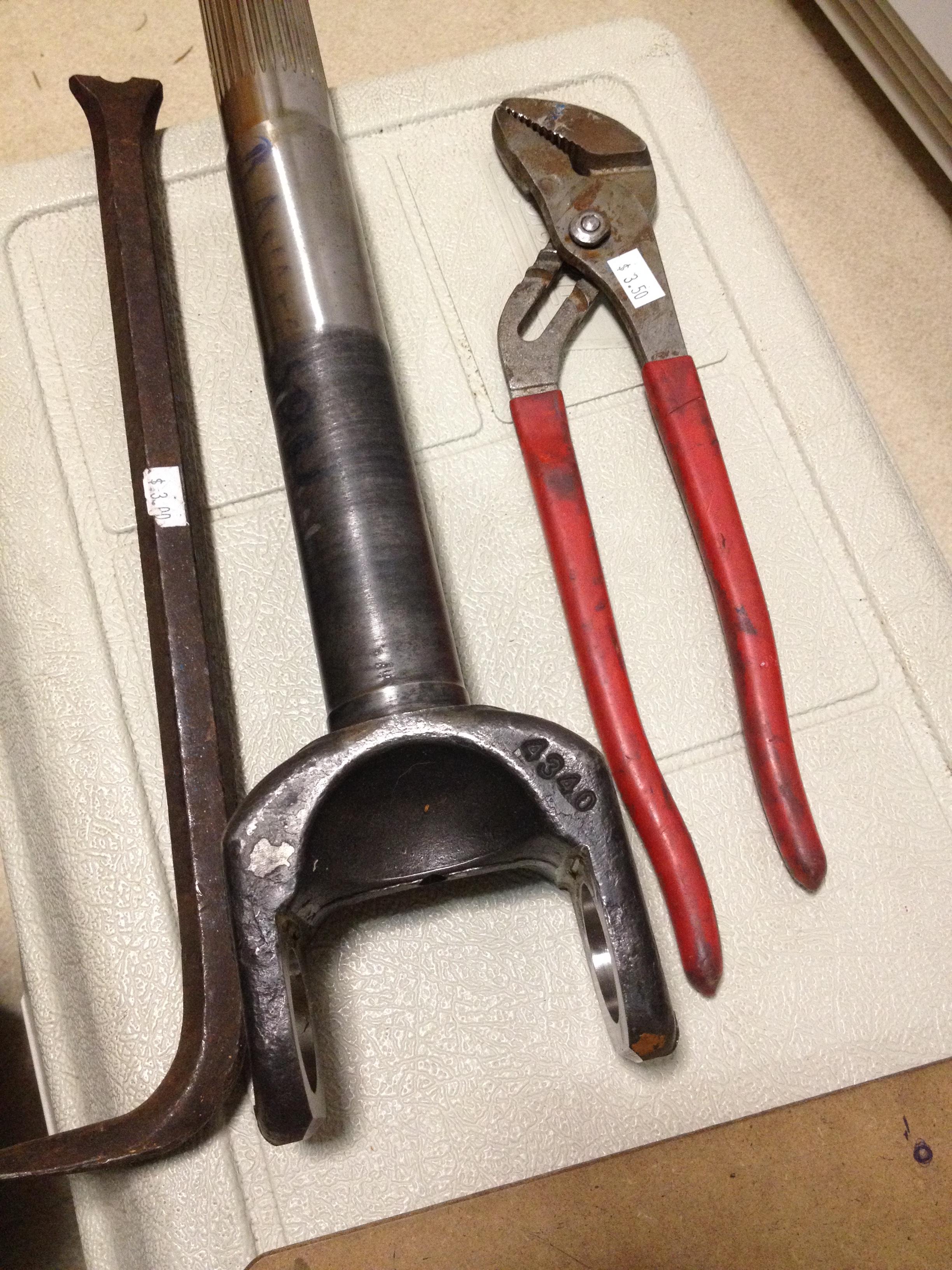

TwistedCustoms Posted March 9, 2017 Share Posted March 9, 2017 I've harvested metal from those kinds of widgets and it can be a hassle. 20' of 1/4" round at my local steel plant is around $3.00 USD. That all depends on how close you live to a steel plant and if the plant sells small quantities. I do agree that scrounging beats hardware store prices on 3 and 4 foot pieces though! The axle shaft is probably 4140 ish, I've water hardened a bunch of them and never had a problem using them for striking tools when tempered to straw. You can never have too much antler on hand! Quote Link to comment Share on other sites More sharing options...
Mark Ling Posted March 9, 2017 Share Posted March 9, 2017 if I had to guess about the axle I would say 1045, but it may just as likely be 4140, just depends on who made it. Littleblacksmith Quote Link to comment Share on other sites More sharing options...
ThomasPowers Posted March 9, 2017 Share Posted March 9, 2017 From a friend who used to work in an axle factory: the industry standard was 1045H below 1 3/8" stock and 1541H for axles above that size, for trucks. We did use 4140 for some of the very large axles used in off road equipment like big front end loaders. Quote Link to comment Share on other sites More sharing options...
John in Oly, WA Posted March 9, 2017 Author Share Posted March 9, 2017 On closer inspection, it has 4340 stamped in the shaft. From a bit of searching, it looks workable for making tools from. I'll have to see what the local metal supplier charges for 1/4" round to see if what I bought was worth it or not. Thinking of making a couple of hammer racks to mount on my anvil stand with the 1/4" widget metal. Quote Link to comment Share on other sites More sharing options...

John in Oly, WA Posted March 10, 2017 Author Share Posted March 10, 2017 Thanks for all the info everyone. Time for some more data gathering and head scratching on the vacuum chamber. Geez Thomas, it sounds like from your MatSci class, everything falls apart (Well, I guess everything does. Except the pyramids; they seem to be hanging in there, but look what they're made of). Just have to make sure that things fall apart in the safest way. On the 4340 drive shaft part, I'm pondering putting it in my heat treat oven to anneal it so I can cut it into smaller pieces to work - it sounds like a long process. Or just put it in the forge and hot cut it. But I don't have a hot cut - would have to chisel it apart. Want to make a hardie hot cut out of the forked end. Quote Link to comment Share on other sites More sharing options...
