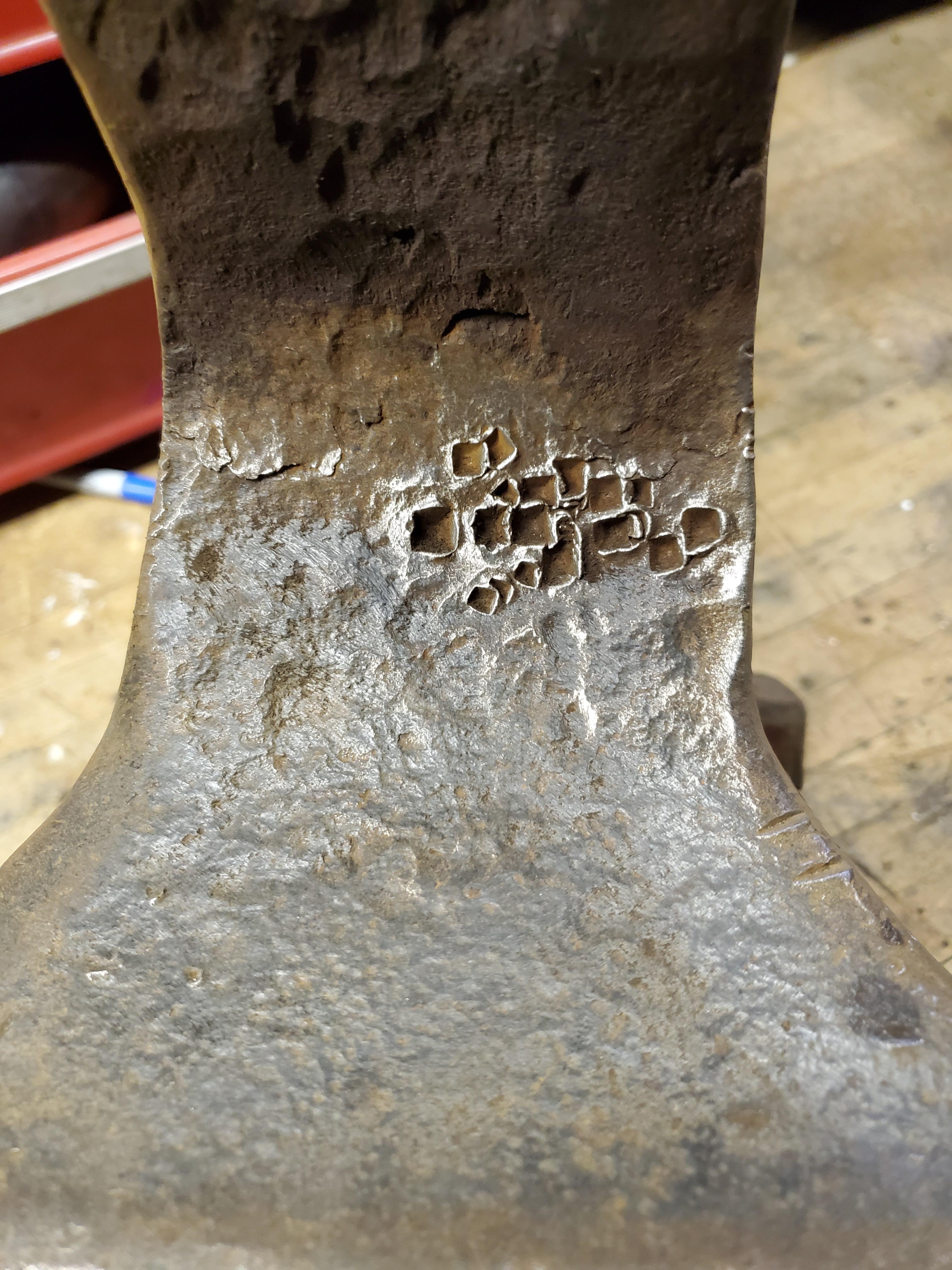

Not sure what this 6/9 on the bottom side represents?

Anyone have a clue on it's age?

Ntryt2,
According to AIA:
Your Black Prince, S/N 193510, is a Columbus Forge and Iron Company (Trenton) 169 pound anvil made in 1926. It was sold thru the Shapleight Hardware Company of St Louis Mo.
It is a very nice looking anvil with a 'crazy' history....Hope this info helps.

Good evening folks. I am 64, was raised in SoCal, retired, and moved up to Washington about 1 1/2 years ago. When I was 5 years old, my father drove the family back to Pike County Kentucky to see our Great Grandps and Great Grandma. This is the area where Hatfield and McCoys frequented. Behind my great grandfathers home was another dilapidated home that my Greatgrandfathers father lived. My Dsd asked if he could go have a look and my Great gf said he could and take anything home that was there. My father brought home this anvil, and a few oil lanterns from the local coal mines of which I still have one. I started working metal in high school a bit, so asked my dad for his anvil. He gladly gave it to me. I am thinking that was about 1983ish. I have been hauling it around since then.
Yesterday I decided to remove some of the rust using CLR and a small rotary wire brush on my drill motor. I was able to uncover "BlackPrince, hapley hardw, St. Louis USA". From what little I could find online, mostly this group, I will look in a couple other spots for weight and serial number. Feels like a 90lb sack of cement to me. I will try and weigh it later.
You said you all wanted the story" so here you go. I would like to set up a small furnace and make it myself, but still doing some things on the new house, to us anyway. How do I join the group? Doug B.
Figured out the membership stuff, now to add some photos. The anvil is pretty beat up, but looks like someone may have added a plate on top at some point?
Welcome from the Ozark mountains. Your anvil has seen some honest work in it's life but there is plenty of life left in it. The hardened steel face plate was forge welded on when it was made. It really only needs hot steel hammered on it to shine it back up. Because the plate is not very thick and welded to the wrought iron body, it is recommended to do no grinding, milling or welding on it. It could be restored but the cost would be prohibited. This is the only method to restore it I know of other methods usually do more harm than good. Anvil Restoration
