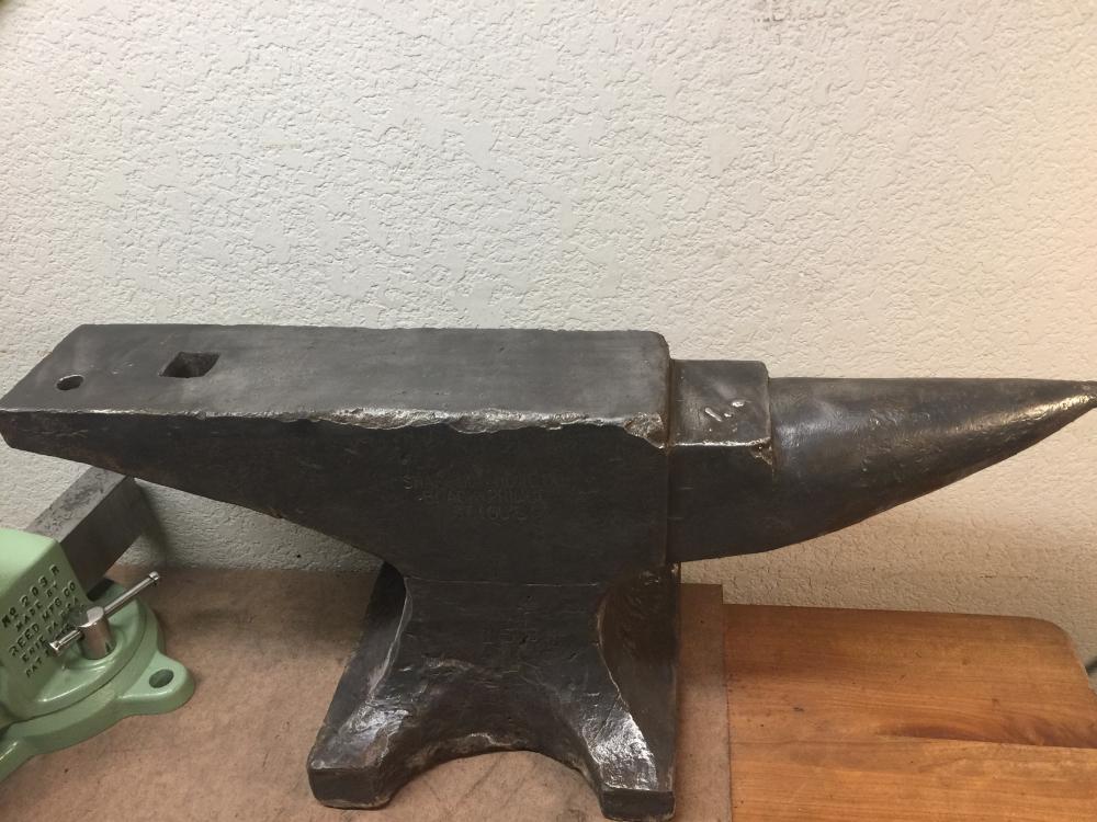

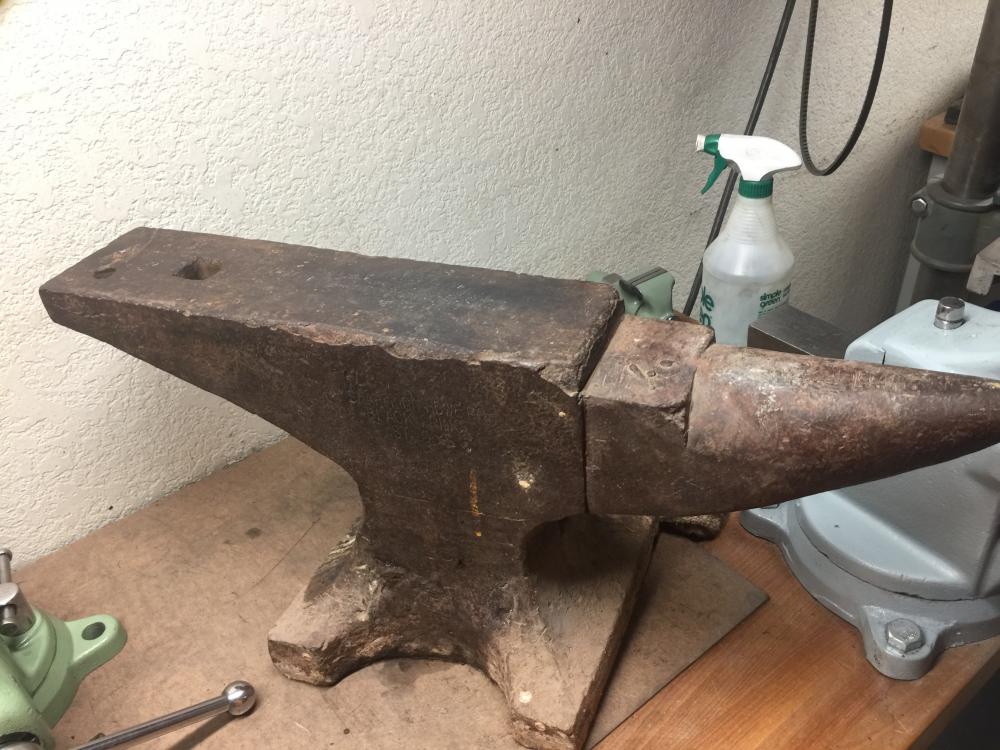

  2. Found this 161 pound PW yesterday decent price all things being relative.
  3. Cleaned the rust off using electrolysis and a wire brush. It has some rough edges but I am going to leave it as is, would hate to make it worse and I had that happen to me in the past on some other equipment.

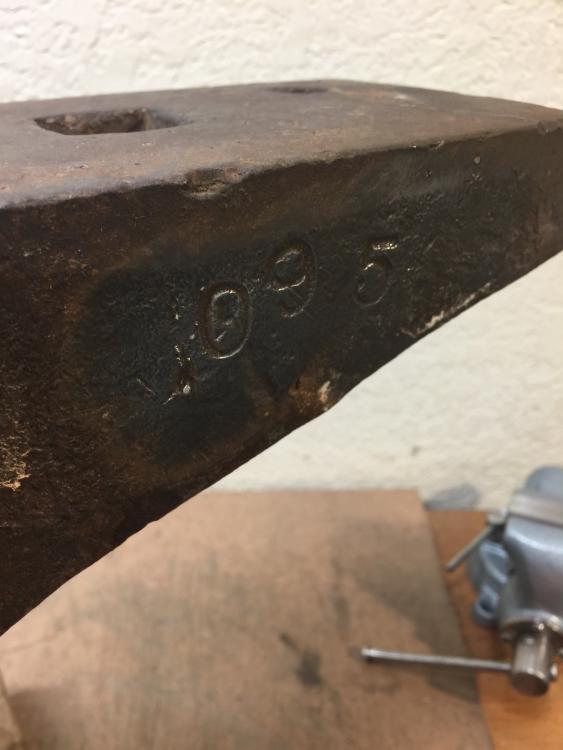

  4. I am pretty new to this game so wondering how you can identify that its a Hay Budden? Thanks for this info.
  5. .I weighed it and it is 158 # so the158 under the makers name is the weight. The 095 must be the serial number.

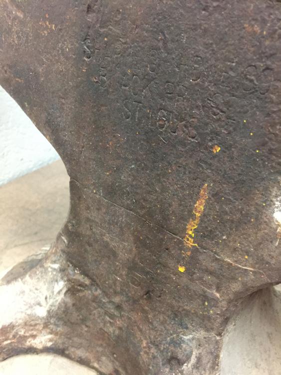

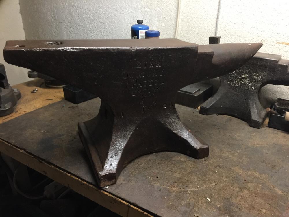

  6. Found a 158 # Black Prince anvil. There is not a whole lot of information on these other then Columbus Forge made them for Shapleigh Hardware. Its got a few chips but nothing terrible.
