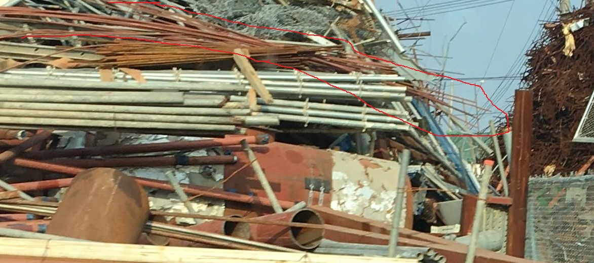

HardHead Posted January 7, 2017 Share Posted January 7, 2017 I'm reading a blacksmith beginners book right now. It mentioned that repurposing metal from salvage yards and recycle yards is a great way to get metal cheap. Then I realized that with in a mile of my apartment here in Korea are two promising yards! Does anyone else go to these types of places to get good metal? Below are some pics of the yard I found, unlike in the states, Koreans like to build up instead of horizontal. Could be there for a while! Quote Link to comment Share on other sites More sharing options...

Gergely Posted January 8, 2017 Share Posted January 8, 2017 Hi, and welcome HardHead! Aren't scrapyards the best?! I could fill a truck in a place like the one you pictured If I were you and the yard people let you buy stuff, I'd pick 3 pieces of those reddish stock marked on the picture. It looks like it's not too thick for hand forging. It also looks to be in 6m long sections which may mean it's likely some simple structural steel (= easy to forge). It's painted which means it's not rusted to death (although rust IS our good friend, as it means no poisonous surface). You have to remove the paint, do it with caution. Having ~18 meters of that stock enables you to practice basic forging techniques and make some stuff out of it. If you can find some 8-12mm square stock that's gonna be good, too. For starter tool steel I'd buy some new stock. 18-20 mm dia round 4140 (= 42CrMo4, 1.7225, SCM440H) will serve you good for all hand tools. Have fun! Oh, just one more word: Srapyard rule nr1: If you haven't took it you won't find it anymore. Best wishes: Gergely Quote Link to comment Share on other sites More sharing options...
HardHead Posted January 8, 2017 Author Share Posted January 8, 2017 2 hours ago, Gergely said: Hi, and welcome HardHead! Aren't scrapyards the best?! I could fill a truck in a place like the one you pictured If I were you and the yard people let you buy stuff, I'd pick 3 pieces of those reddish stock marked on the picture. It looks like it's not too thick for hand forging. It also looks to be in 6m long sections which may mean it's likely some simple structural steel (= easy to forge). It's painted which means it's not rusted to death (although rust IS our good friend, as it means no poisonous surface). You have to remove the paint, do it with caution. Having ~18 meters of that stock enables you to practice basic forging techniques and make some stuff out of it. If you can find some 8-12mm square stock that's gonna be good, too. For starter tool steel I'd buy some new stock. 18-20 mm dia round 4140 (= 42CrMo4, 1.7225, SCM440H) will serve you good for all hand tools. Have fun! Oh, just one more word: Srapyard rule nr1: If you haven't took it you won't find it anymore. Best wishes: Gergely Gergely, thanks for the knowledge. I'm going to head there today! Ok so I went and checked that scrap yard out. The Korean man was very friendly and he let me crawl all over and under looking for stuff. The red bars you mentioned in the pic were rebar, which I have plenty of already. There was a lot of serious heavy duty pieces there! I'm talking huge industrial furnace stacks, 4 ft man hole covers that were 1.5" thick, GIANT I-beams. He has a 4 foot section of I bear that is 12" wide, 3/4 thick and has manufacture cross supports under the beams that he was going to sell me for 10,000 won (roughly $9.00), I'm thinking of using it for "my first anvil". It had a couple holes in it already that could be used for punching. I didn't grab it yet because I wasnt sure. I did pick up the piece below for 5,000 won (roughly $4.00). In considering fashioning it for my pot for my forge since I don't have one yet. My concern though is it may not be deep enough. If not, I'm sure I will find a use for it! Quote Link to comment Share on other sites More sharing options...

Gergely Posted January 8, 2017 Share Posted January 8, 2017 Hi HH, I'm sorry to hear those were rebars, they looked so nice... I'm sure though you will find there some good forging material. Around here fork lift tines are the stuff that yard people don't like to sell, only when those are broken (the tines). Happy diggin', have fun! PS: One hint: I found thick walled square tubes are rare to find and very useful when you want to develop your workshop. Quote Link to comment Share on other sites More sharing options...
